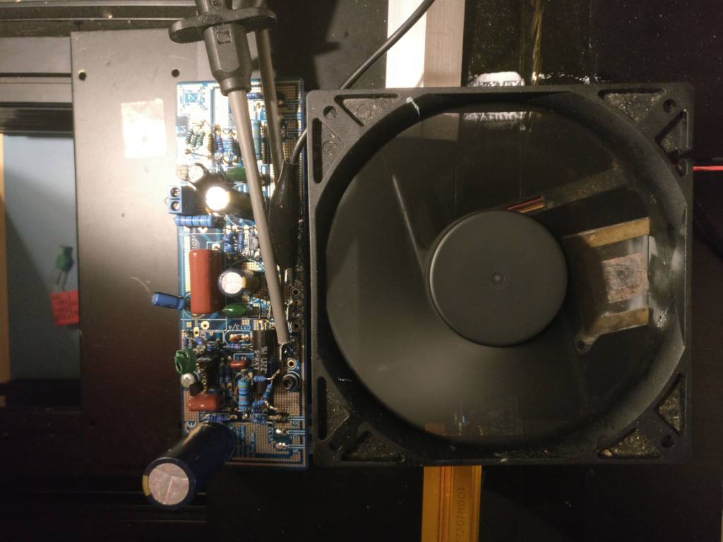

Actually, Tonza, you do not need a lot of gear. I have a function generator, a 100MHz Tektronix storage CRO and a lot of DMMs. A variac, several soldering irons, and a LOT of components. Most of my designs are done on LTSpice now, since the Fast Fourier Transform has hugely improved design speed and accuracy. I do not require THD meter; I prefer the exact levels of the harmonics.
Most design is a thought process. The base material is the topology, which no instrument will give you. A good memory, an associative mind and an extensive understanding of the history of amp design is all you need. Many audio designers are in love with the measuring instruments, not the sound. This is the consequence of the psychology of numerical appraisal, a bit like the love of V8 engines over sixes. Inline sixes are generally smoother and much cheaper to build and maintain. But the V8 figures are so impressive they attract fantasy. As it is with audio.....

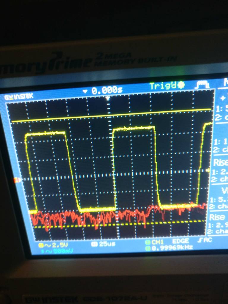

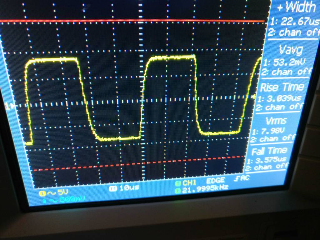

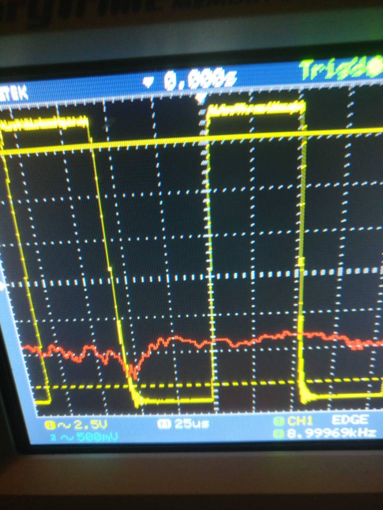

You are playing with irrelevant figures. 3.5uS means 280KHz, and your input is at 22KHz, above the audible limit, and a square wave with artefacts to 242KHz.
These are absurb expectations for an audio amp, and they do not relate to the sound quality of the amplifier.
The ALPHA 20 is down 1dB at 80KHz, with 6.3 degree of phase shift at 20KHz. These are adequate for an audio amplifier, but they do not even begin to explain the sound quality........
If you use a 5.5mm rifle would you expect to kill a substantial animal at 4kms, like a 7.62mm can?
