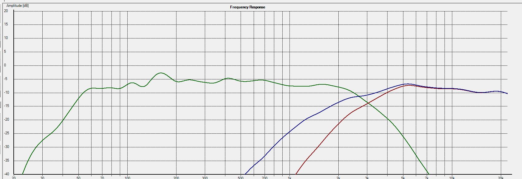

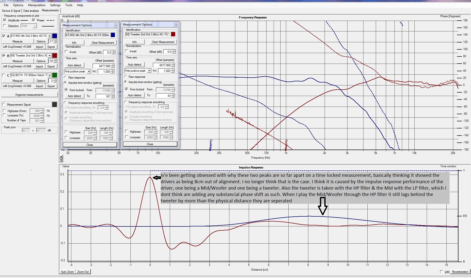

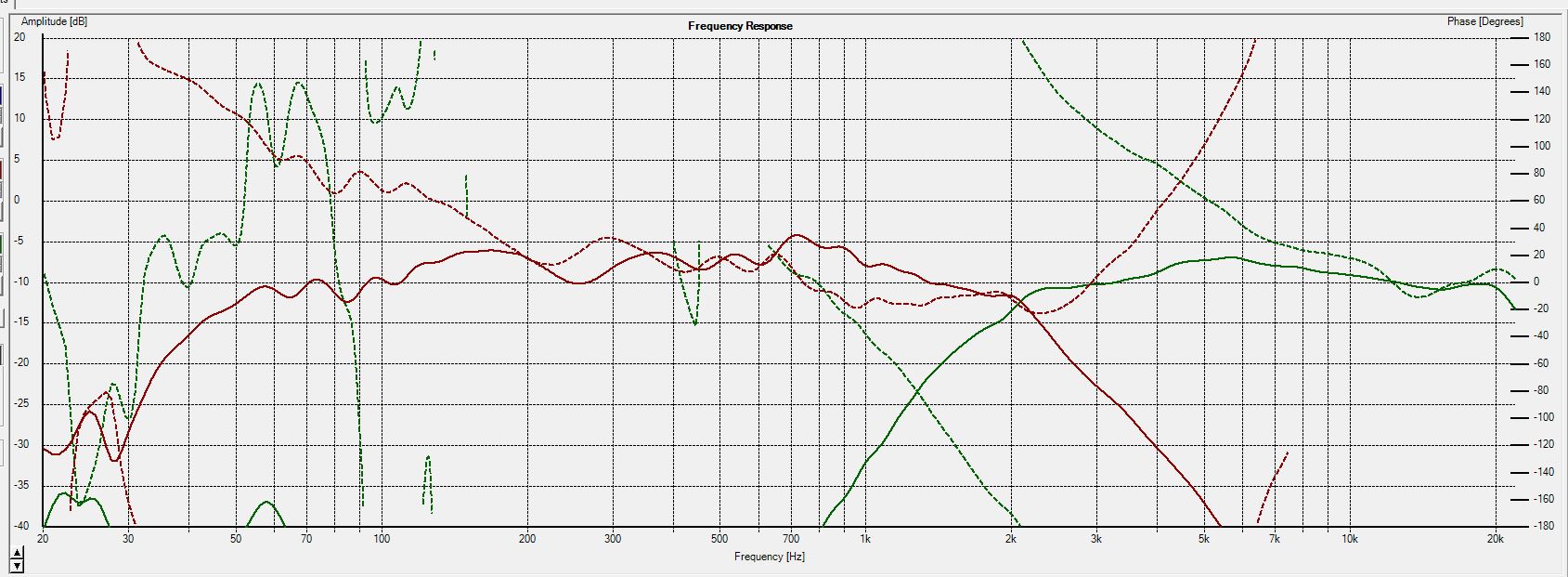

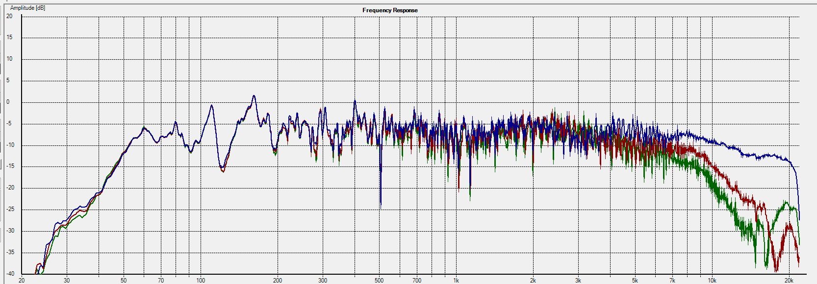

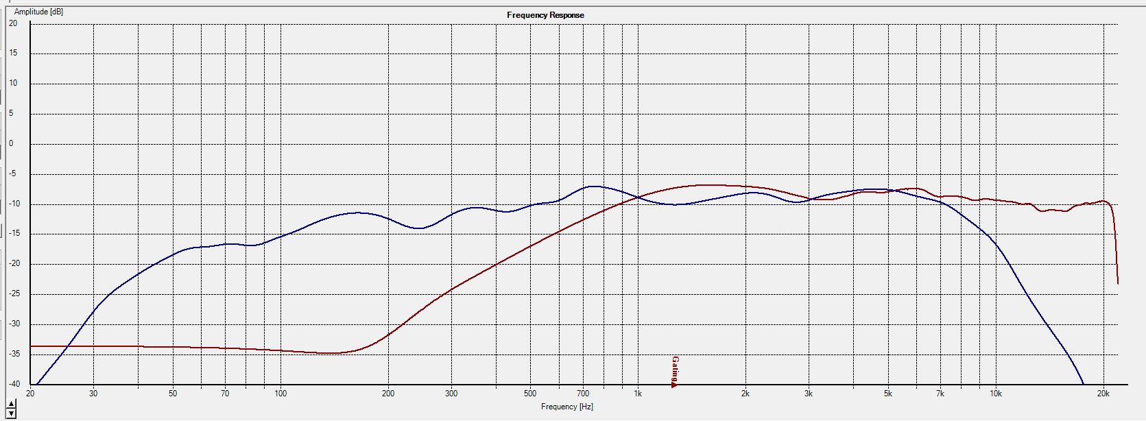

It’s taken a while but I’m finally testing the crossover with the intender speakers and I was hoping you might be willing to express an opinion on what I should do next, I have listed below the setup of the XO so far.
  • · Low Pass set at 150Khz
  • · 6db Baffle step set for baffle width
  • · 4th Order HP at 2100Hz
  • · 4th Order LP at 2100Hz
  • · All Pass on Tweeter set for 8.5mm
  • · Woofer Output Linked= No Attenuation
  • · Tweeter Attenuated for falling response to HF
My thoughts on EQ where to:
  • · Have a Notch at 700Hz
  • · Have a Peak at 250Hz
  • · I wouldn’t mind to put in a Low Cut to stop anything below 30hz getting to the woofers but am not sure how to go about it.

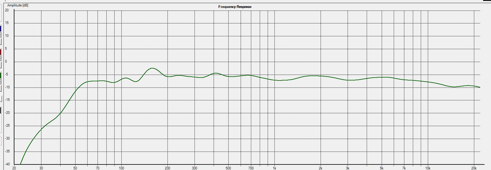

The measurements below were taken outside at 1m
I’m not really sure what is going on with the phase??
I’m also not sure what’s going on with the saw tooth between 55 & 110Hz it is quite pronounced with RAW measurements especially when taken inside :)
Any advice would be welcome.

A small wide notch around 7-800 Hz looks like it might be a good idea. I wouldn't try to boost that notch at 250 Hz.
What happens to phase and frequency response when you invert the tweeter? It looks like the tweeter is at a phase wrap and the woofer is almost at zero.
The low frequency ripple is probably floor/ground bounce. Probably nothing you can correct in the crossover, look to placement.
A "low cut" would be another high pass section, requiring another set of boards. Are you using this speaker with a subwoofer? If so the processor's subwoofer crossover will take care of that for you if you set the size to small.

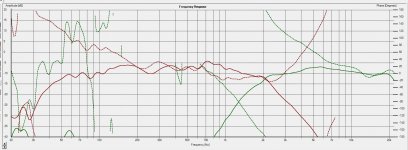

I'm a bit confused by the phase thing, as the tweeter has an All Pass section I was expecting to have to invert the tweeter but when I do, the FR has a large dip at the XO as shown below.
When you say phase wrap, what do you mean by "wrap"?

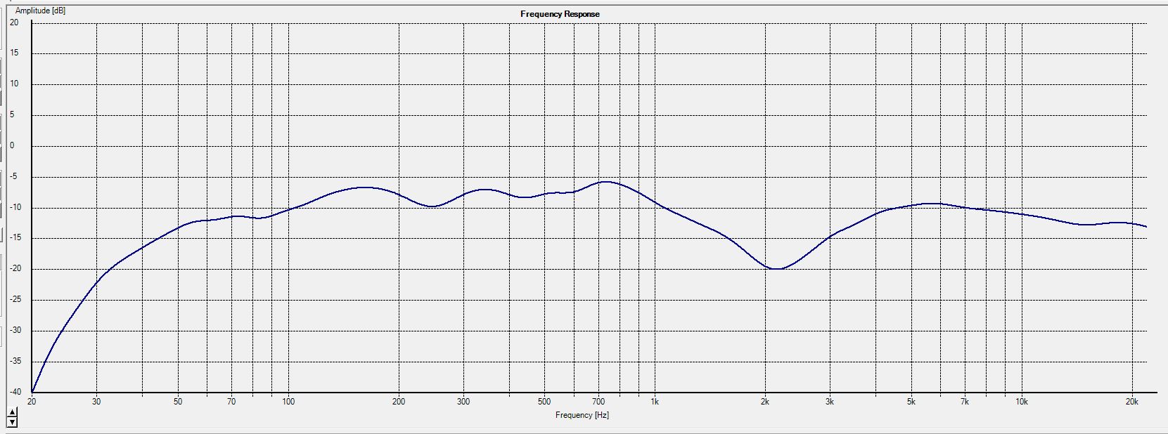

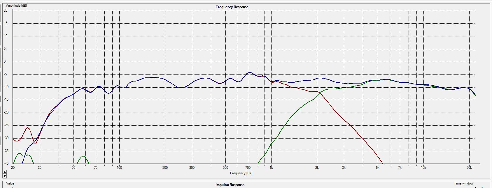

Well the notch has worked as you will see, this is an inside measurement. Thanks
I was wondering why you thought I shouldn't bother with the second notch at lower frequencies?
Is it ok to have 2 filters (say 2 notches or a notch & Peak) on the one driver?

DQ828, I was referring to the 250 Hz notch in response in your outdoor measurements. Errors in omission are less audible than spikes in response if it is real. LF measurements are tough to do other than nearfield even outdoors. You are still likely to get ground bounce influence. Check out Linkwitz for a measurement method that might get more accurate results. You'll need a way to get your speaker up in the air.
The current 180 Hz bump relatively small and in the area that it is probably a room/measurement artifact. (since you said you measured indoors, you can confirm this by measuring in a different part of the room and/or at different distances.) You don't mention your baffle step frequency, but your response is relatively flat below the bump, just a couple dB lower. If the bump is not a room effect, could a bit more baffle step make the bump less obvious?
No, there is no "only one eq per driver" limit. Go ahead and try a 180 Hz notch if you like.

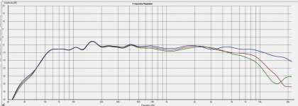

On the topic of measurements, have you done off axis measurements? Power response is a major factor in the sound of a speaker. I'd give up a bit of on axis flatness if it helps power response. Look for smoothly falling response off axis, without significant bobbles in the crossover region. Try 15°, 30°, 45° and 60° if you have the time. Do at least two off axis measurements.

All of these measurements are taken Inside
The first image shows 0, 15 & 30 degrees
The second image shows 15, 30 & 45 degrees
The third image shows 15, 30 & 45 degrees RAW
Not much is happening at the crossover, there is a large difference between 15 & 30 degrees.

Off axis transition looks pretty smooth through the crossover region. I'd bet you'd find similar off axis response on the tweeter alone. You might try a little felt near the tweeter, since there is a slight increase in off axis response compared to on axis just above XO. Probably a diffraction effect.
I'd be inclined to call it pretty close to finished and live with them a while. Then if you feel that 180 Hz bump needs work, give it a try. Female vocals would probably bear out any real problem in that region.

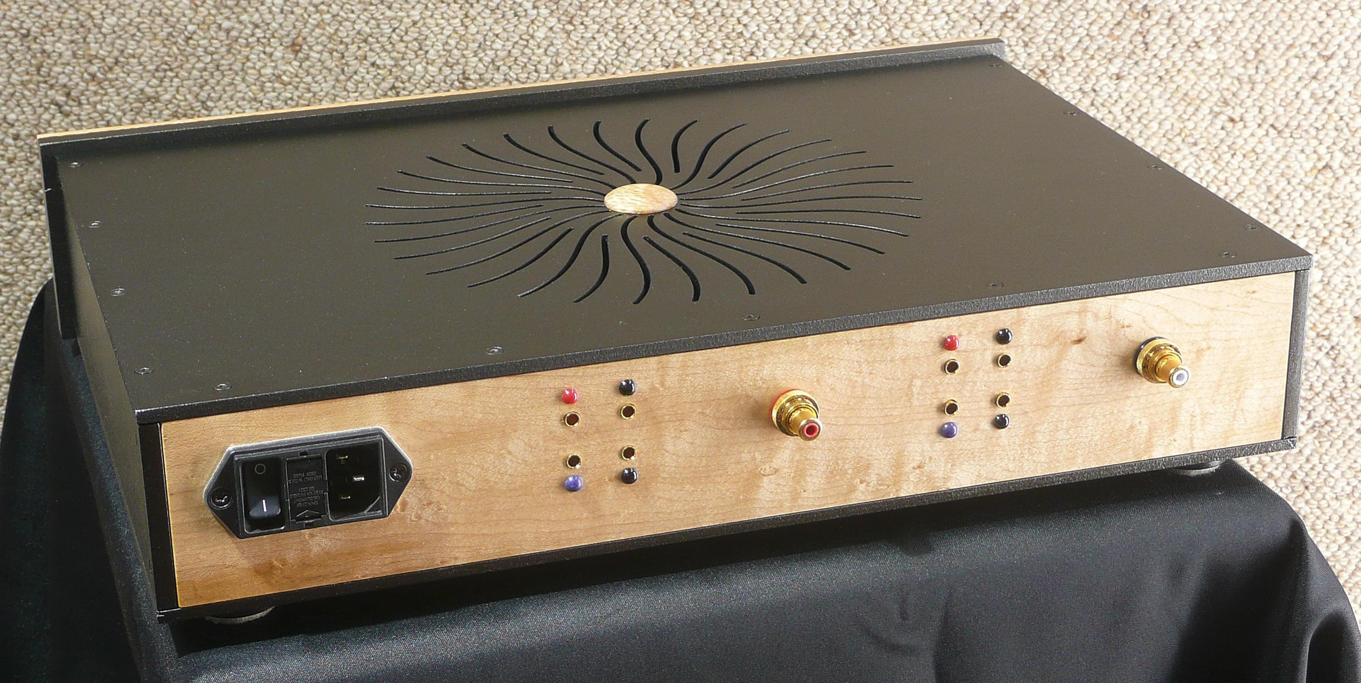

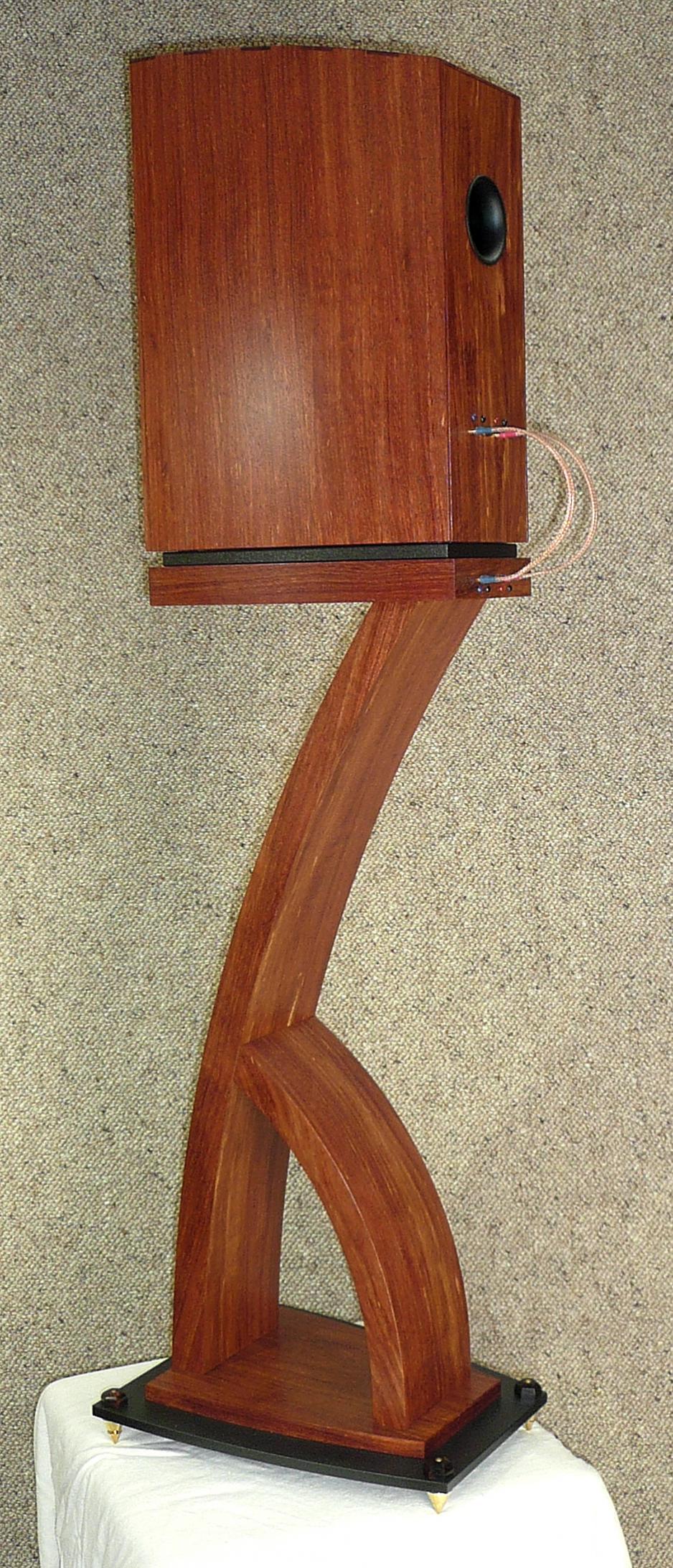

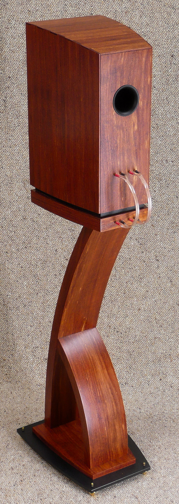

I have to put the second XO together and order a couple of caps but now I'm getting close to the end of a project that's been going a year. Was going to be finished last Easter :)

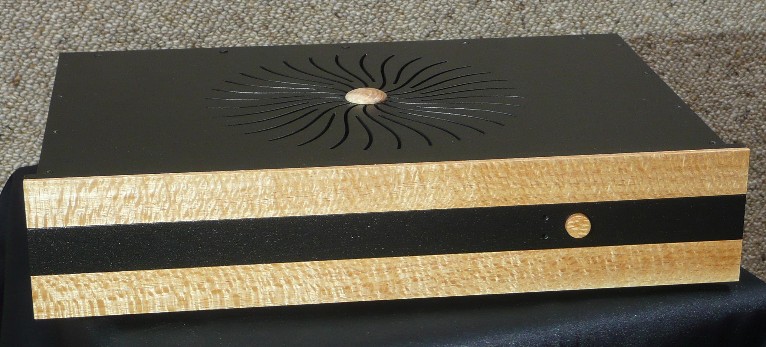

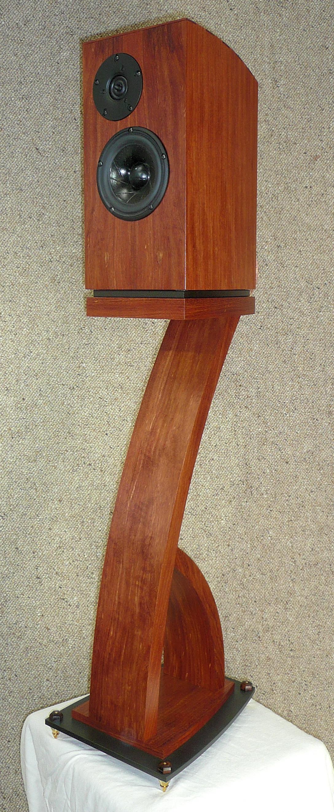

I've built a pair of these speakers/stands & the AmpXO, about 90-95% finished.
Thanks for all the help.

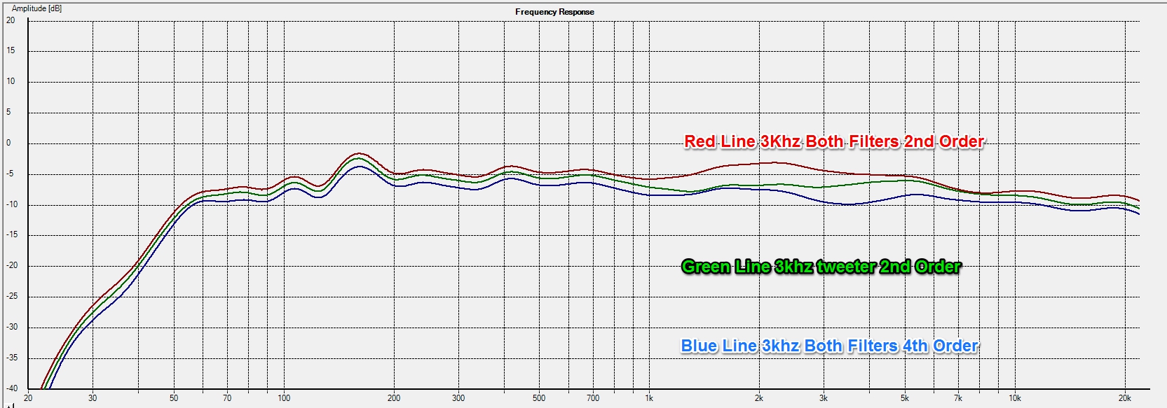

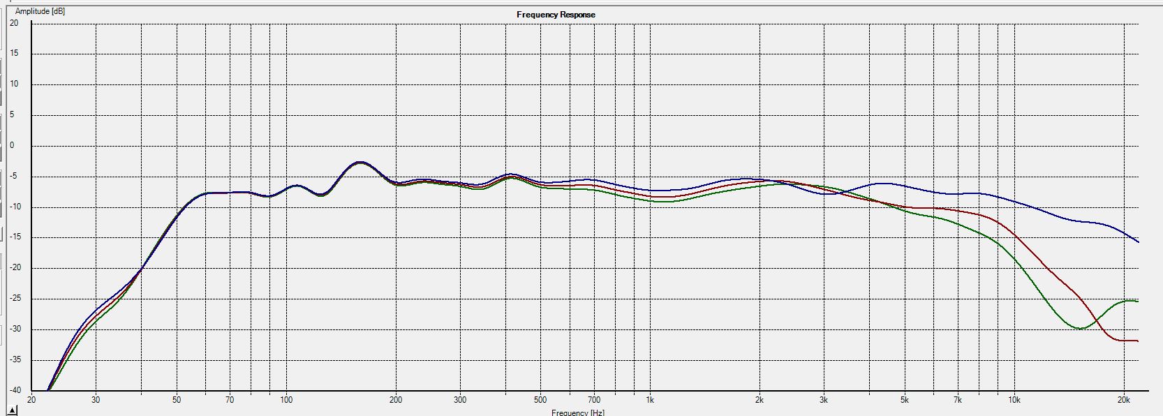

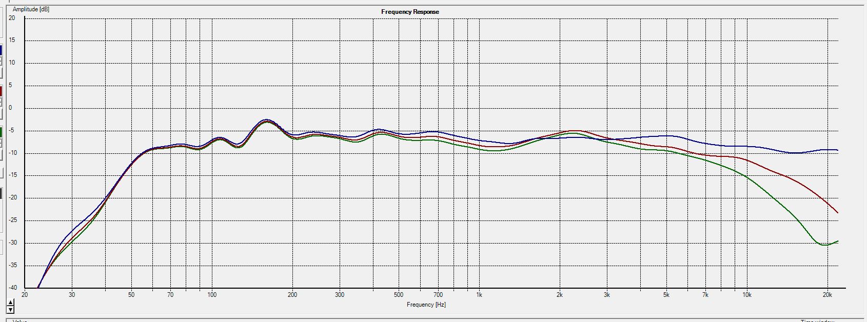

You could play with it, again keeping an eye on off axis response. The higher you go the more the midwoofer will beam, possibly causing a sharp shift in dispersion at crossover. Your polar response looks good now, but may work a bit higher as well. Probably 7K will be way too high.
I'm with Andrew, 3.5K is about as high as I'd go based solely on your on axis FR. I tend to push tweeters as low as their distortion performance allows, shooting to keep the narrowing dispersion all in the tweeter. But that's me. Others shoot to keep the crossover higher.
Beautiful build, by the way.

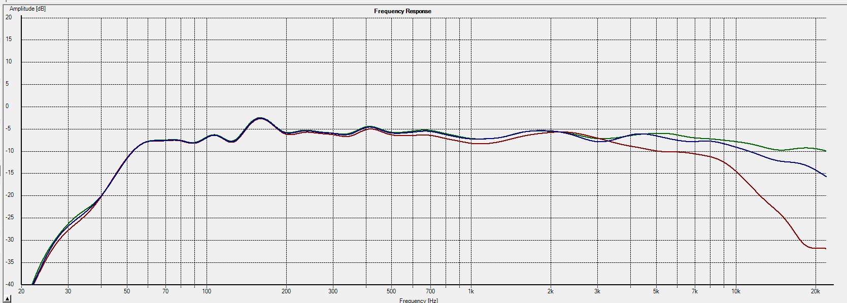

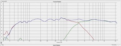

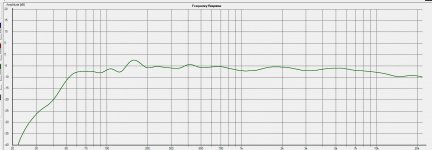

I have moved the XO to 3khz, I started with both drivers having 4th Order filters (3rd image Blue line) and the overall affect was the signal was generally a couple of db lower between 2&10khz with a more pronounced dip (compared to the 2.1Khz OX it's not phase related) at about 3-3.5Khz.
I then tried 2nd order filters for both drivers & had a a large dip! I then inverted the Mid and had a Peak back towards 2.5khz (3rd image Red line)
In the end I tried the tweeter as a second order and the mid as a 4th order and got the flattest line (3rd image Green line). I'm not sure about the downside of using mixed filters but from what I have read people are doing it. I think the rolloff should be sufficient to not be an issue.
I tested the off axis at 15, 30 & 45 degrees and it looked pretty much as it did before. At this stage I have done a lot of testing but very little listening.
The first image shows the mid 4th order, tweeter 2nd & 4th Order
The second image shows off axis 0, 30 & 45 degrees with tweeter 2nd order & mid 4th order
I have lowered the Blue line on the 3rd image by 1dB and raised the red line by 1dB for clarity

It would be much easier just pad the tweeter down more. If you need more attenuation you can reduce R21 to as little as 1K. A 10K pot and 1K gives up to 20.8 dB of attenuation.
You can make the output buffer a gain stage without issue sonically if you insist. Would be tough to do since it there isn't a long trace between the output and inverting input to make pads.

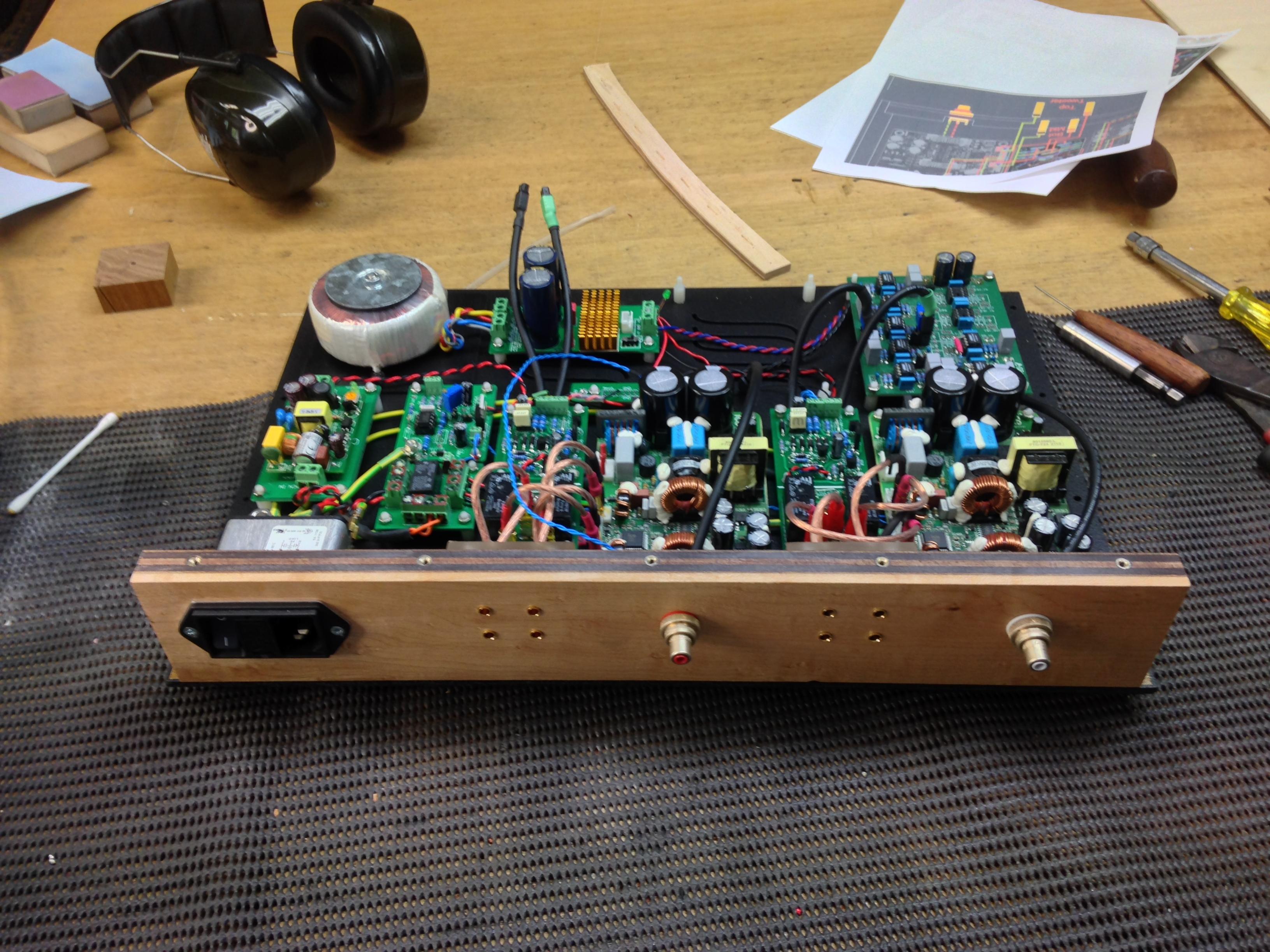

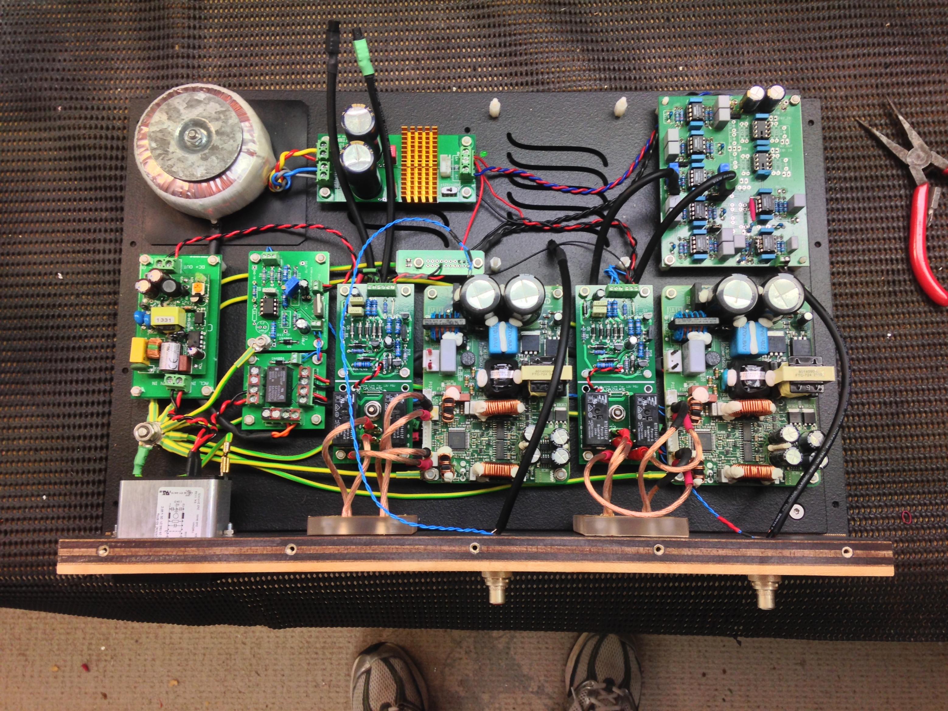

If anyone is interested I have 2 crossover boards, 1 PSU board and a pile of parts. I think all of the parts are there for the PSU and the Crossovers have the PSU input caps and the bypass capacitors for the OPA's but thats it for the crossover. PM me if your interested.
Many thanks again.
