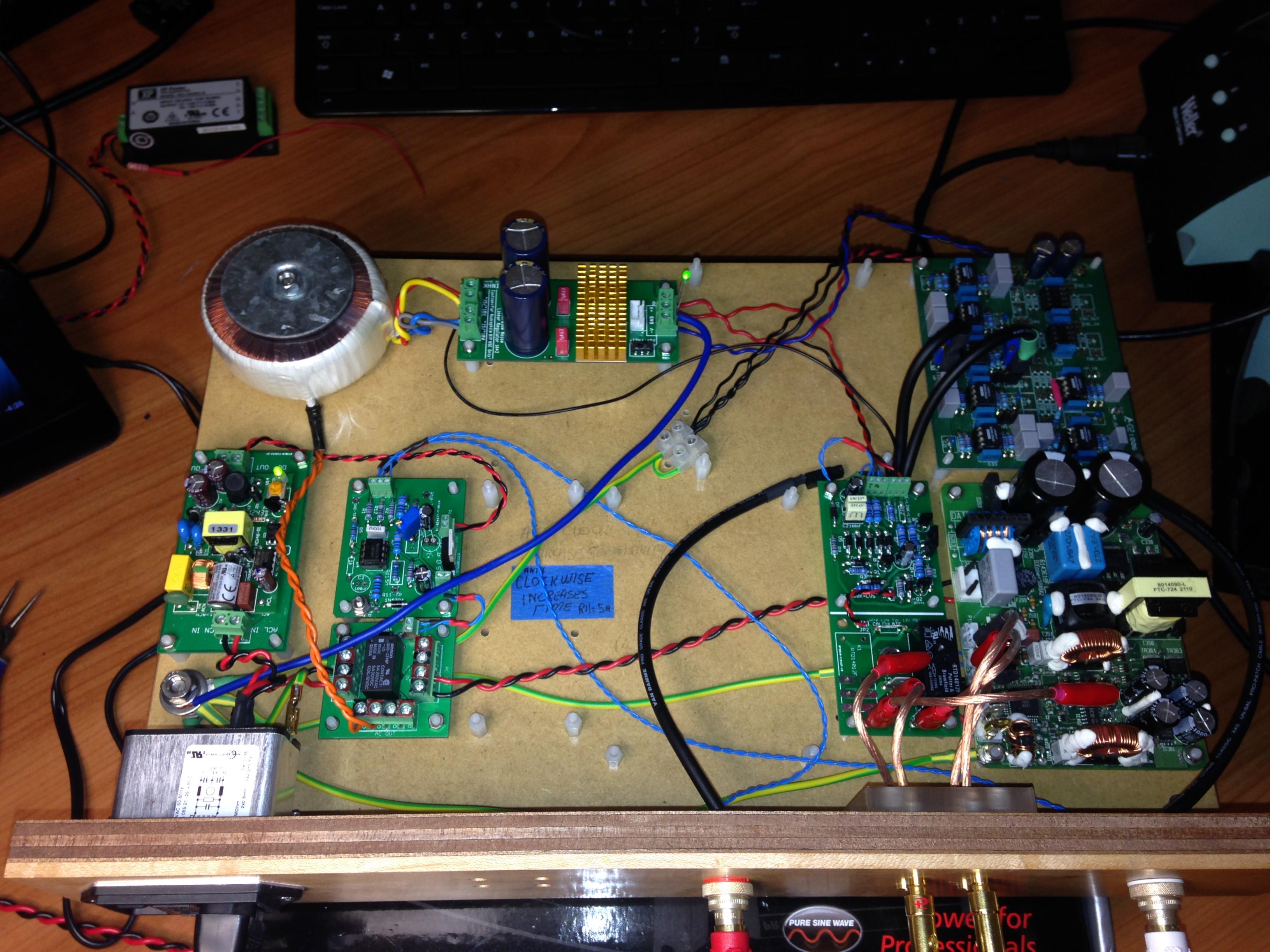

I have been VERY slowly building an active crossover/amp using the crossover boards from Bob & Jens, I thought I would include a Rod Elliot signal switch to turn the unit on and off, which I have previously used for a sub. After an unbelievable amount of hours of trying to get the signal switch to work properly (didn't have this issue with the sub) I finally worked out that if I use a linear PSU (tried 3) to power the crossover, when the power is turned off by the signal switch -0.6V DC appears at the signal input of the crossover board (which is connected to the signal switch) and this (I'm as sure as I can be) forces the signal switch to turn back on. If I use a Switching supply to power the crossover no -DC appears at the crossover input and the signal switch works fine.

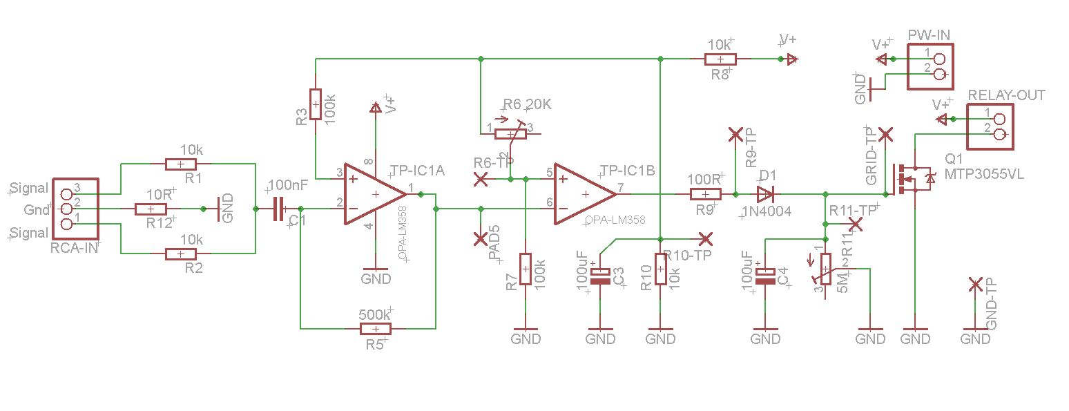

Now I've recovered from a bad case of the flu & am feeling a bit more positive I thought I'd have another go at explaining the issue I'm having with the Signal Switch & thought maybe a diagram would help, see attached. I have deleted a lot of stuff to keep it simple.

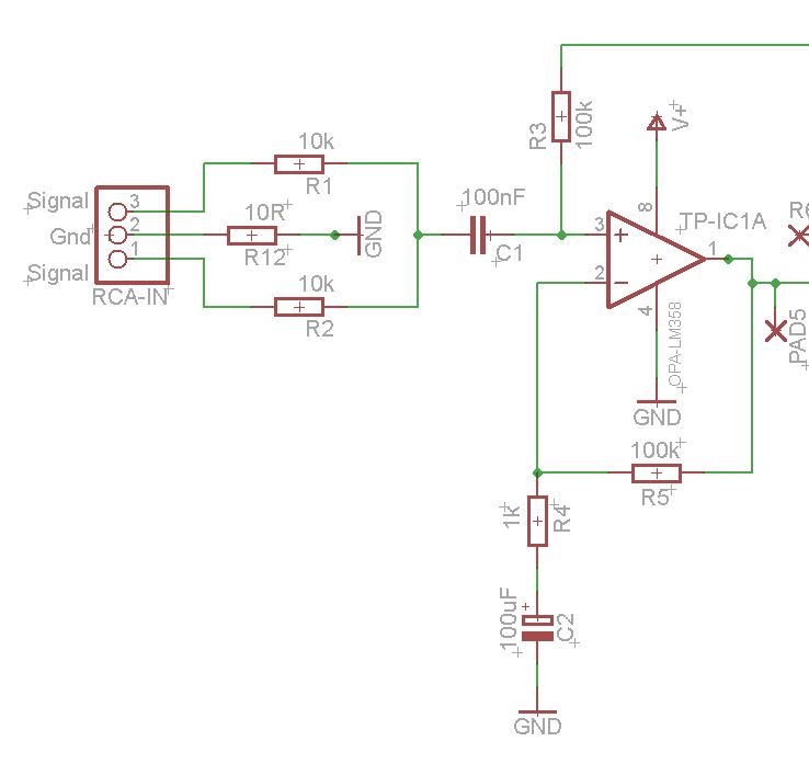

Also I have attached a copy of the schematic for the input of the signal switch and was hoping you might be able to explain exactly what I should do to stop the crosstalk.

You must have a grounding issue with your linear power supply connections. That's the only thing I can think of that would cause the DC at the inputs.
As for converting to inverting inputs, Jumper R4, make C2 100 nF and lift it's ground connection. The formerly grounded connection becomes your inputs - that's where you connect R1 and R2. Increase R5 to ~500K to maintain the gain. You can eliminate C1 and everything to the left and including C1.
You need to have C2 since the switch operates on a single supply, but the idea is to make something like this:
Note that R3 is your connection from the positive input to the virtual ground that single supply needs.

Is this what you mean?

Close, leave R3 connected as in the original circuit - to the "virtual" ground created by R8 and R10. Notice that they create a voltage midpoint between the + supply and ground.
If you reference to ground as shown you create a large voltage difference between the inputs and the output will lock up.

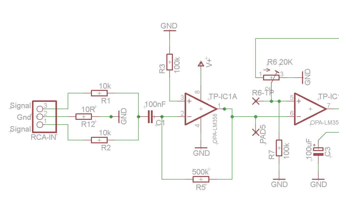

Like this?
Obviously with this setup there is no connection to ground for the inverting input of TP-IC1 which I assume is ok?
That's it. Yes, no resistor directly to ground from the negative input. That's standard inverting opamp configuration. Ground return to the negative input is through the feedback connection and the source.

With the R5 resistor that was increased to 510K which way do I go resistance wise to increase sensitivity?

I know I'm way OT but I thought you'd probably like to know the result of your advice. As mentioned earlier the revised signal switch worked with the SMPS so tonight I installed the linear supply as before & got exactly the same result that the signal switch wouldn't turn off. I reconfigured the grounding for the linear PSU and the things its powering at the moment by running the ground from the linear PSU output directly to the Ground/Earth point and then ran the crossover and speaker protection board power grounds directly to the Ground/Earth point (Star ground I guess) and low and behold it worked well at least for today

Hooray for star grounds!
A friend demonstrated ground loops in a high power RF amp by soldering a 22 gauge wire to the chassis, running it up an inch, horizontal for 8" and then soldering it to another point on the chassis. Using a screwdriver he was able to pull an arc from the middle 2/3 of the wire to the chassis.
