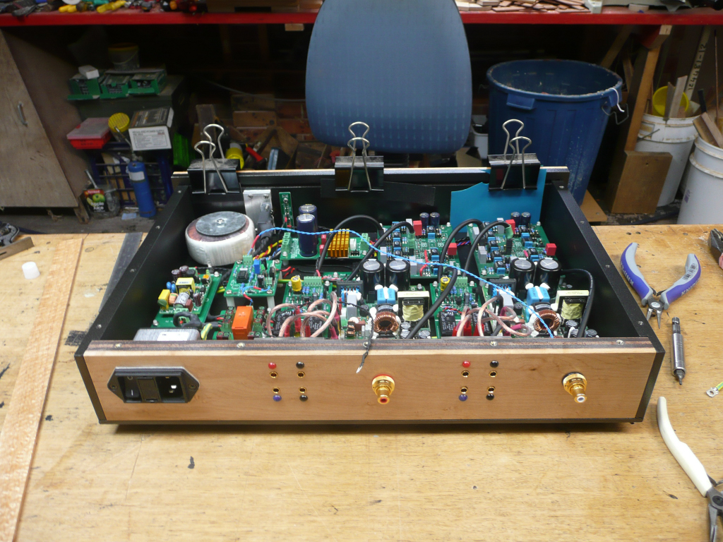

I didn't take any of the final setup but it's about 98%, which shows a stray blue wire that was tidied up before the lid went on.

Nice work,
I would run the input signal a different path, so that it does not need to cross either the demodulation inductor or mains transformer of the 50ASX2 module.
Are you happy with the power level of the 50ASX2?
\\\Jens
Nice work,
\\\Jens
Too late, it has been delivered :) If it helps the cable is shielded.
The power is definitely sufficient for my sisters listening level and the size of the room.
I've used a few Icepower amp modules and they seem pretty bullet proof, fingers crossed.
The most important thing is my sister thinks there great, she keeps sending me email telling me so.

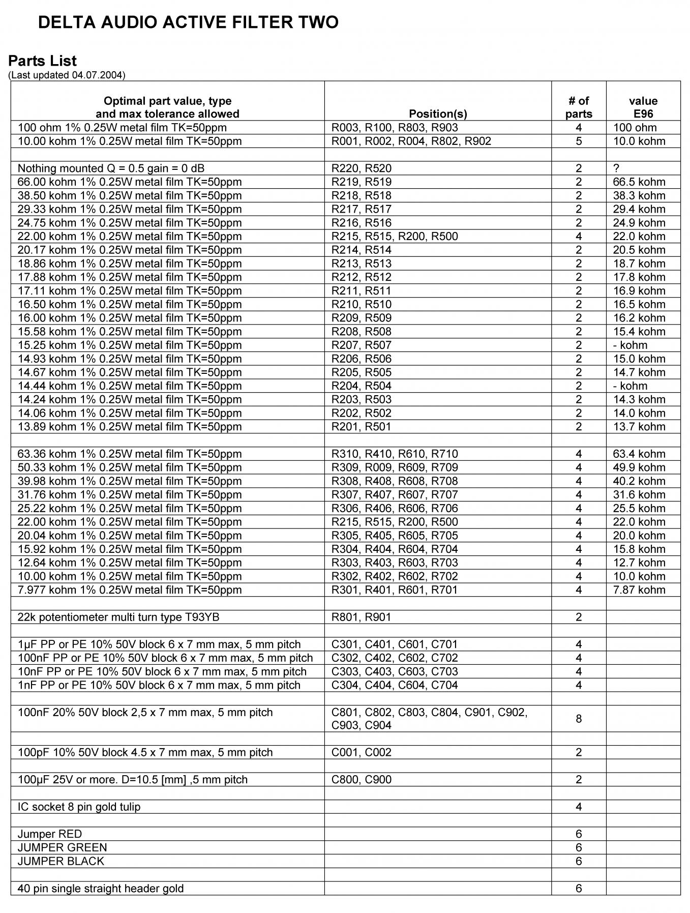

I was thinking to build the Active Filter Four (Jens Rasmussen). I like this one because you can choose between 2nd and 4th order. Unfortunately for this filter I was not able to find a manual like for the Active Filter Two. In case there is no such a manual, I need to find something else.

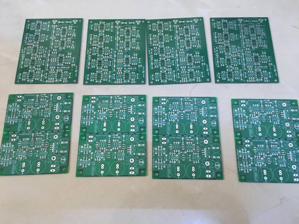

Is there any PCB still available in GB for a crossover filter?
Adrian
  • Active filter 4.pdf
adila. KMTech do a variety of crossover PCB's and kits, all LR2 and LR4 I think Items in KMTech Design store on eBay !
Thanks. They have indeed many filters including the one I want to build, 2.1 24dB/oct.
