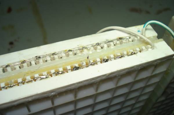

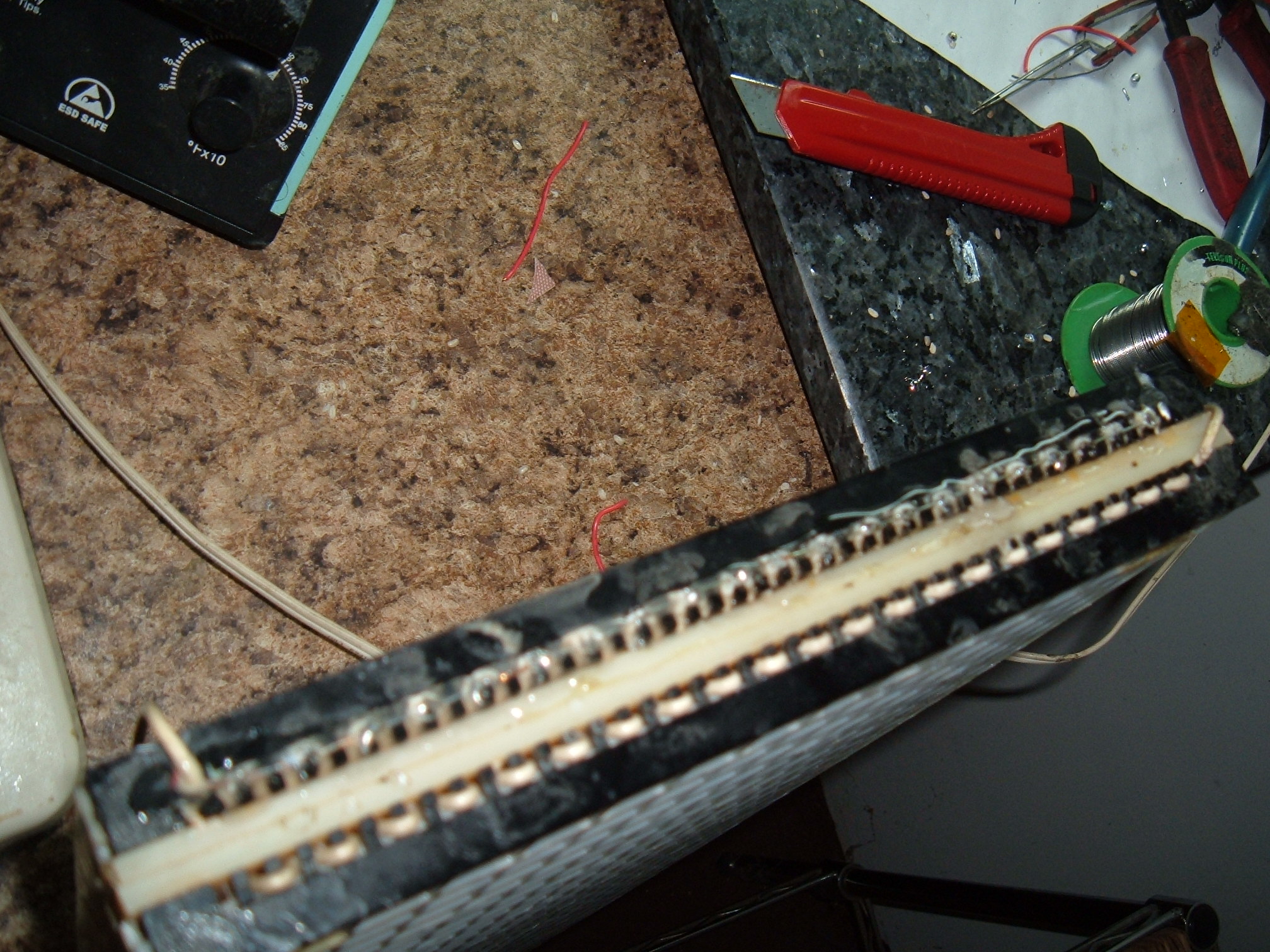

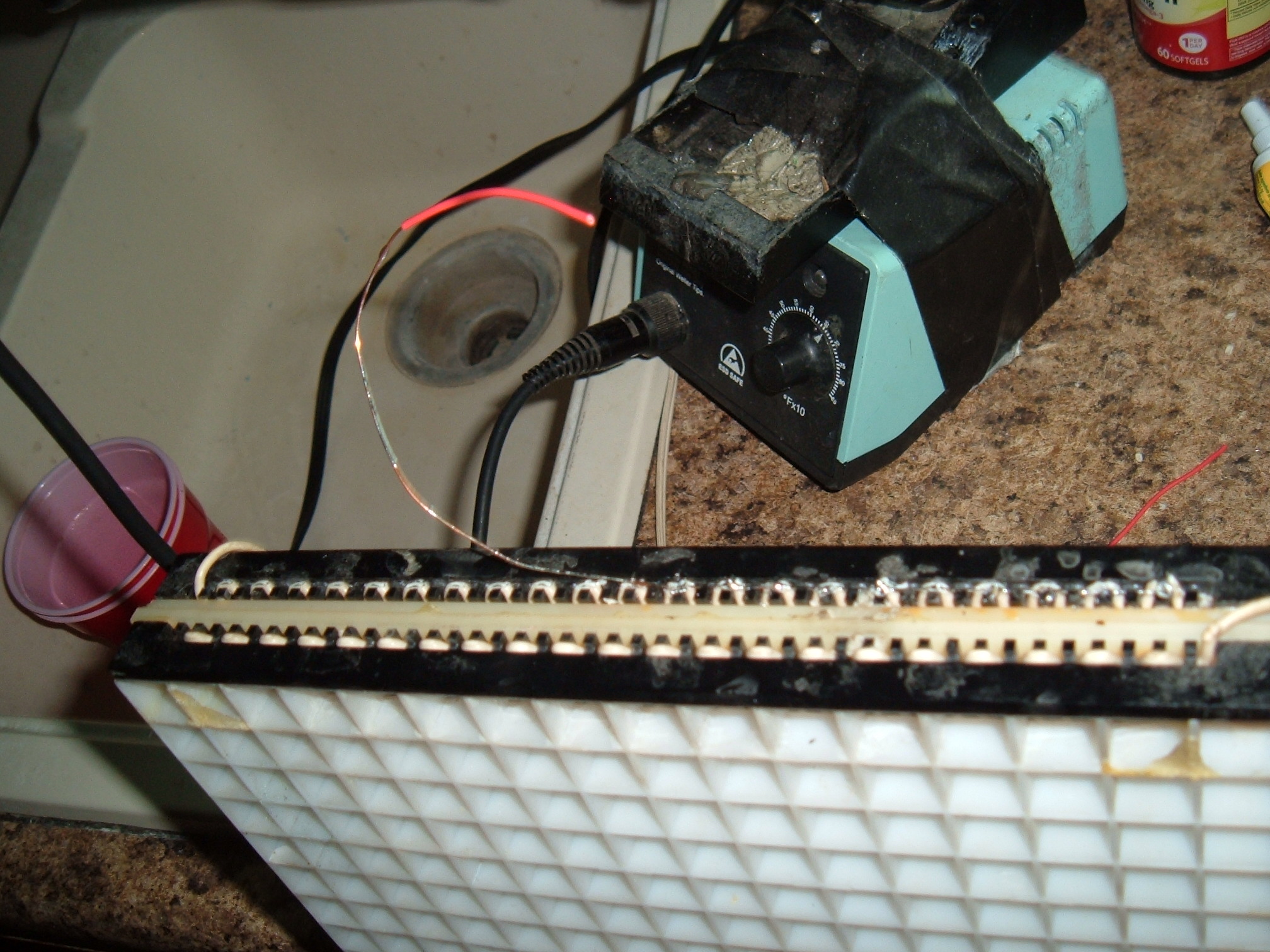

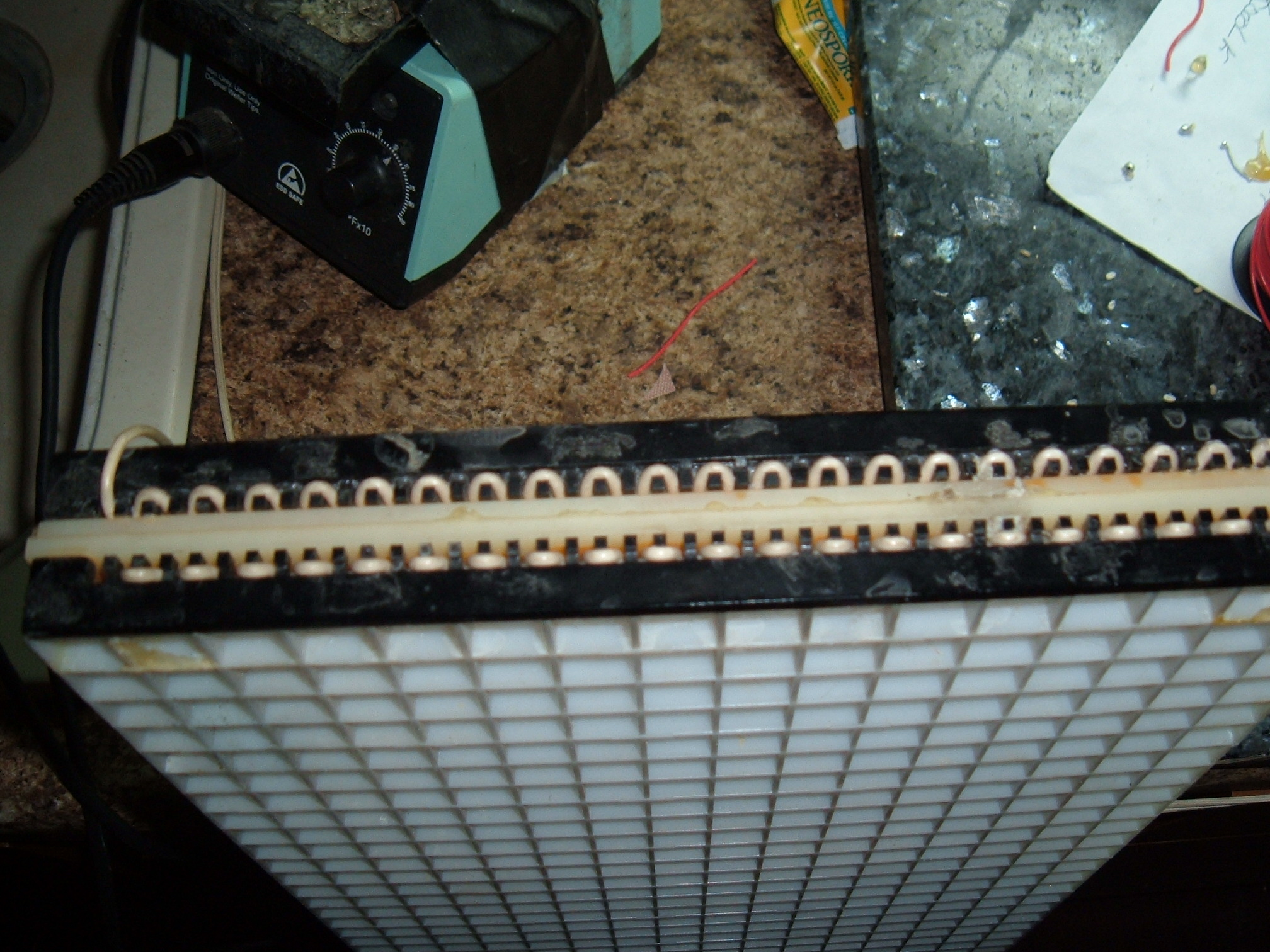

After liveing with this mod for over 10 years.... it a way get more even output out of wire ESL panels.....after all the wire come in....goes up an down an is just cut at the end......there for the wire has to be driven by the tranfourm with a open end...so one side of the panel were the wire come in get more input ......than the other side were the wire ends......on paper some well say it makes no diff....but making all the wire be driven uniformly over its entire surface, ...gives better output ......
Acoustat made some of there panels with 5 wire...... before thay cut the wire in the cen of the panel .....to make the Spectra panels .....an ran bouth ends back to the one input so the panels would be driven more evenly......I have have had some of these panels...............Andy can give more input on the 5 wire none Spectra panels
put some pic of how ezey it is to do.............
an it makes what already are great panels....give higher output .....not hard to see the atvantig
pic1 is the done panel.....cover with hot glue......so there well be no arcking some leave open...
pic2 is the stock panel
pic3 is using the razor to nip the ends off see the bare wire
pic4 tacking a wire down to make the hole panel input feed even....
sorry pic are not the best but I think you get the jest..........

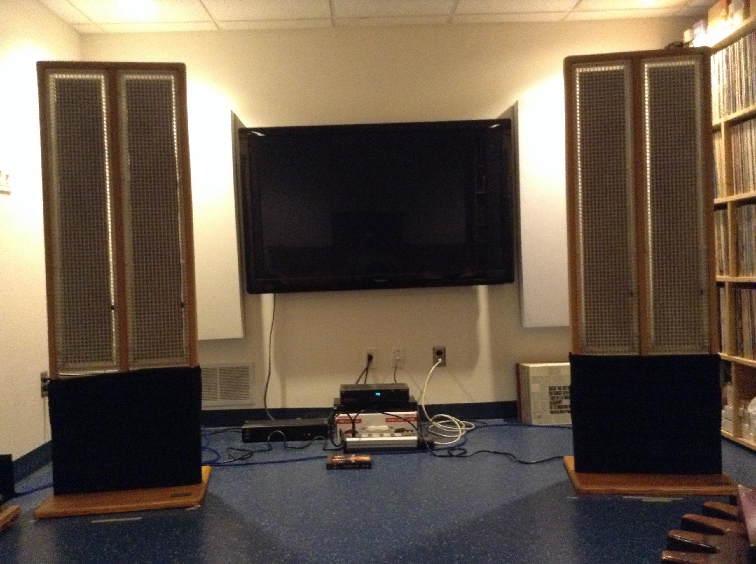

Here is a picture of my naked Spectra's in action. They sound much better without the socks. Planning on making some new Spandex socks soon.
For $1k plus $650 to rebuild the interfaces, the best sound I have ever had in my room. I paid $2500 for my Totem Hawks 17 years ago and these are in another league. What can you get for $1650 these days? A decent pair of bookshelfs? LOL.

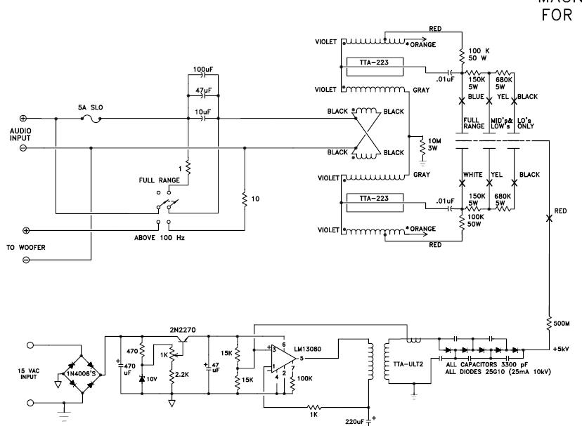

To run all the Spectra panels fullrang............you can see that all you do is move all the panels inputs. ...on there side....too were the white an blue fullrang outputs are..... the frist output point on ea ........well work with the 11-1100....2-22-2200.....3-33-3300......same
see pic.............
this to me sounds the best................but that's me....allways go back to stock
have fun...............
