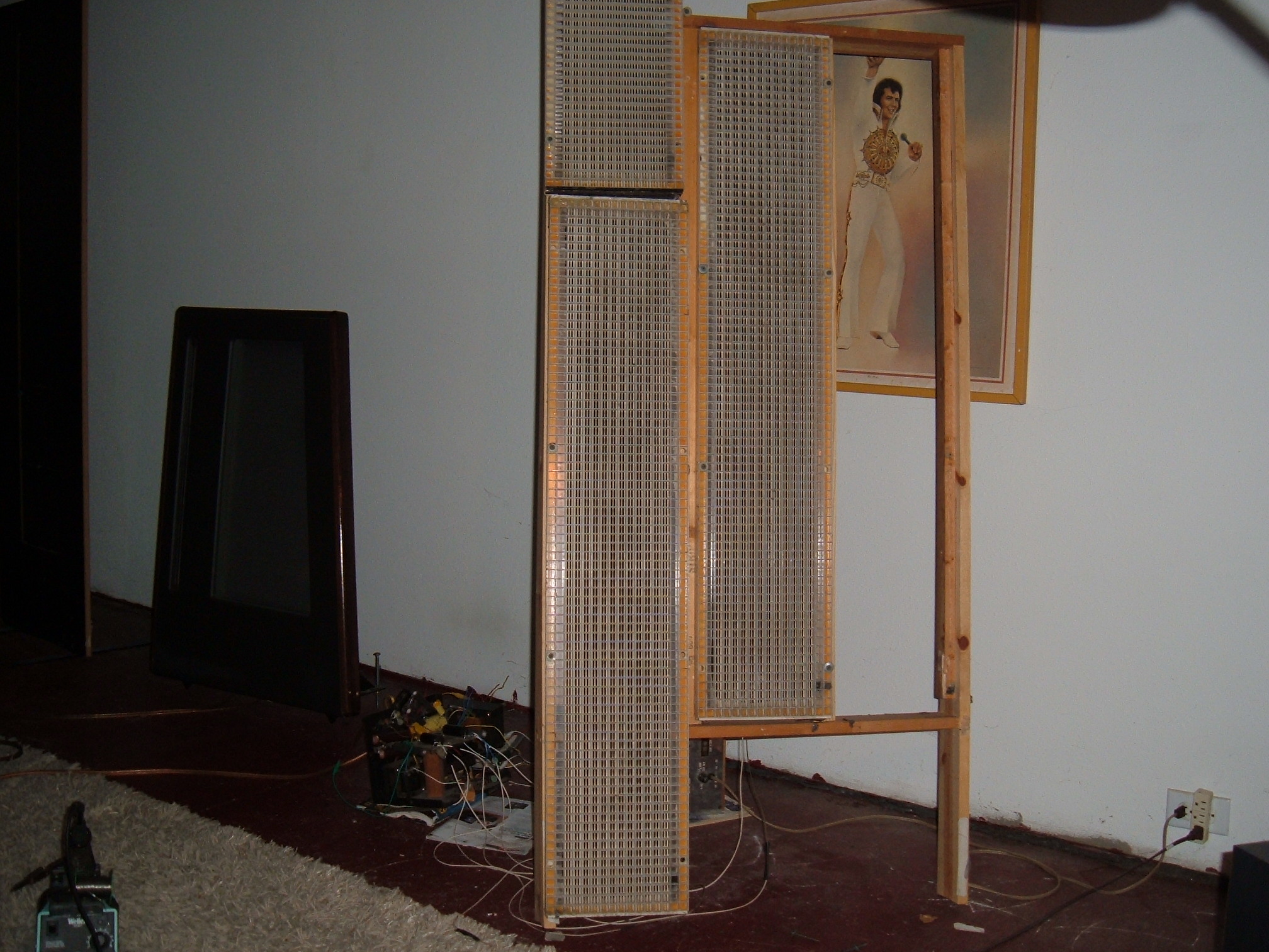

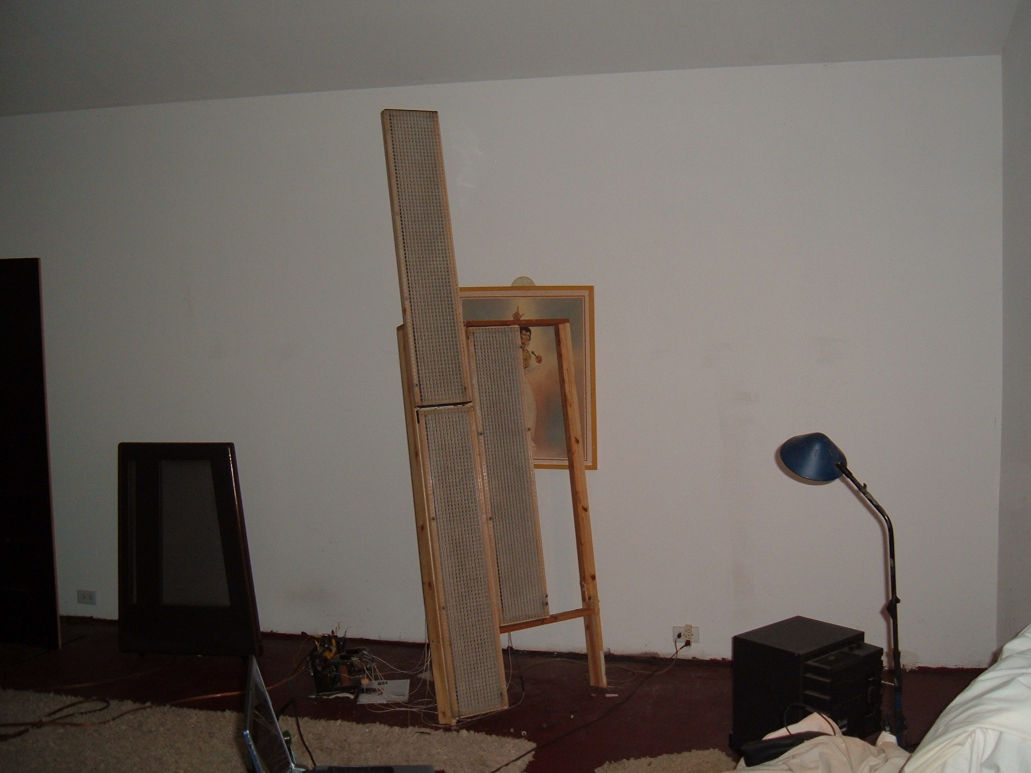

I have just layed the panel in the frames...........an got less noise over all.........
better top end....that an max output of the panels have been my quest...........
I have got there....................best tweak ever.....................dropings bias feeder res from 500mg......to 30-10mg...........................................i run 10mg.....the full topend..

Seriously, loosening the bolts give much cleaner bass. Best Acoustat tweak yet. Cranking Bob Marley Exodus bass is unreal "Family Man" Barrett lays down some big bass lines. No subwoofer needed. Acoustats can do bass. Wish I had room for another panel per side than we'd be talking bass.

Tyu, I tried your suggestion to remove or loosen the screws securing the panels to the frame. On my M3's I removed all but 2 on the opposite corners of the center panel. I left them loosely installed just so the panel won't accidentally fall out. The side panels I removed all the front screws and the two center screws on each in the back. I left the top and bottom screws loosely installed in the back to prevent these from falling out also.
The improvement was immediately obvious! Much more micro detail in the highs, like the panels are relaying more musical information that just wasn't audible before. The bass is prodigious but still detailed like only an electrostat can reproduce it. It's the first time I've ever heard low bass on the level of a subwoofer come from these panels. Amazing!
It's like the panels were always meant to be suspended rather than hard mounted. Maybe some compromises had to be made in the packaging for home use.
I wonder what the result would be if the panels were suspended in a frame that allowed them to move freely, maybe springs or rubber, but still held them in the optimum position for listening.

Any thing or...........any added mass changes the tone of the panels........less is more..........
the mod I posted for wireing the top an bottem of panels ......help get full output an well help kill any noise buzzing ...that might be add....
The way the stock panels are made.............only get about 1/2 the panels output... .....this is why the Acoustat went to the 5 wire panels...................................this put a input an output for ea side.... of the front an back......so the panels mylar would be drive more evenly
an give more output......have fun with Acoustat still room for inproment
