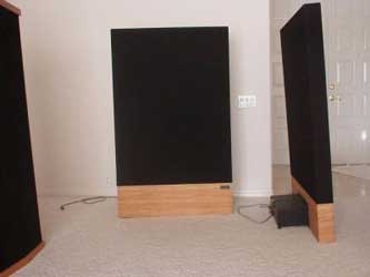

"are you saying the panels should be tilted down towards the listening seat "............
NO ...an by the way....what speakers are made to be setup that way??...........I never seen any

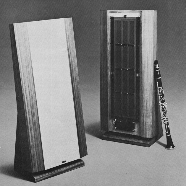

canted back..........here you can see in the pic.....for get pic 3sorry

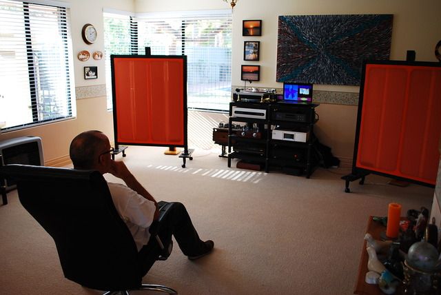

pic 1 staxs....
pic 2 M4s....see stock Acoustat with the ajustabel black brackets....for canting back...........

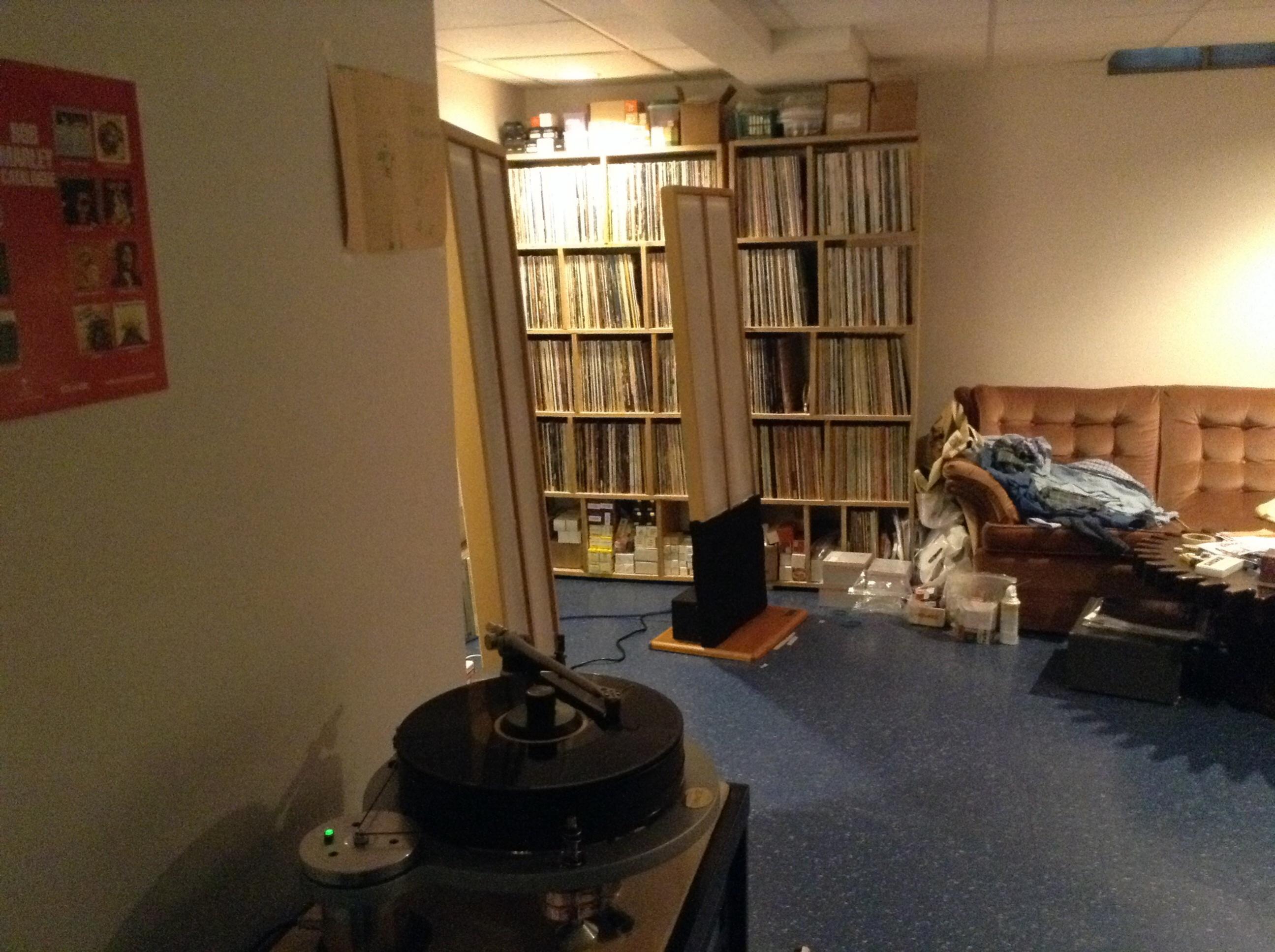

pic 4 M3s....see the cant back....
when canted back.....the ear is more inline with more opening too the mylar....there for you get more output to the ear......less diffraction from the top of the lovers square..............when at 90dedg........ear only hears the lover dead on...less output to the ear..................now I am not saying you don't like these panels setup any way you can.....................for me more output is better one more db output makes a diff.....with ESLs anyway....

I see, you mean tilting the panels backward. That can be done with my Spectra's I will give it a try. Thanks!

Well I did tilt the panels back as Tyu suggested and the sound is better. At first I thought it softened the treble too much but after listening for a bit I think the top end is actually more neutral and less beamy now. Soundstage is better and sweet spot is larger. I guess that's why Acoustat built the ability to tilt into the speakers. Well worth trying if you have Acoustats.
Don't think my tilt is quite 70 degrees. I will be experimenting.
I use a trypoid 3 leg type setup......a back leg.. that run from the floor up too the top plate
take them back more...... then little by little back up.....you hit the right spot an youll get more output..........that the sweet spot....

Another area of interest is the frames. Rather then building new ones I am thinking of reinforcing or strengthening the existing frame. Has anyone tried something like a Mye stand to brace their Accoustats?
Well what I have found is the the less rigid the panels are monted to the frame....the better high frc.....an more output I get out of these panles
In the 1980s when I spoke to Jim Strickland....he told me the panels could be used on there on.....like free standing driver that would work fine ...
I was thinking. like 1 panel maybe rear Surround Sound Speakers .....he had panels hanging an playing in his shop. with out frames....
So in my stock frams when the speaker are canted back......I losen all the 8ea screws.....are even remove them.....I get less noise out of the panels this way....when driven hard.......gofig..

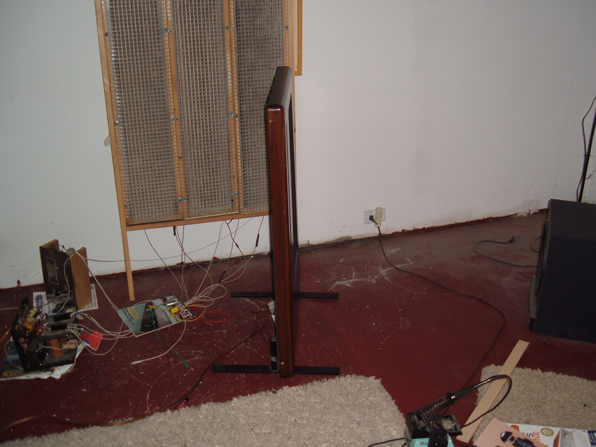

In these pic of a set I have put to gather......to see what is lost or gained when the panels are play over your head....like the 1+1s..2+2s an so on...6s...8s..............the top panel only 2 screws holding an no frame ....what I hear with the 7' panel......is better bass....a little more three-dimensional sound....not much...
I have had the 1+1...2+2s....but never cared for the sound ....may be it was that at the stock 90.degrees the standing wave.in the room......never sound right..................
I tried canted them back....but the Acoustat M3,4s always sound better to me
I have also found that not have the panels ran to the floor sound much better...
1... the top an bottem of the panels mylar give less output.....than in the middle that give most max output...........when the panles near the floor the top of the panels close to the ear.........an then when the panels are stacket... the bottem of the next panels starts an now.....2 of the lest output spots of the panels....at the ear....
2.. the floor reinforcement.....is not need for good sound..or bass.....an better image...
Also you see in the pic....that there nothing on the bottem.....it open....just the panels are framed.....I had this closed in....but lost so much I pulled it out................
I have found this give more output....better bass...meds....highs...
hay....now I am not saying that the 1+1s An 2+2s don't work are that thay don't sound good...great.....thay do.....this is just one mans finding after 30 years with these Great panels......................

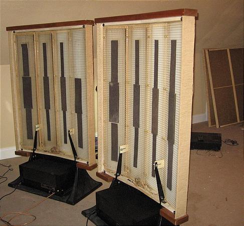

heres one system in Australia that fits with your thoughts:

Also I had to tilt my panels up a little more as I lost too much highs as I sit on a low couch and speakers are only 7 1/2 feet away. Got my highs back and still have the superior imaging you get with the tilt. I would say I have about 75 to 80 degree tilt.
Man these things are directional only a tiny change in tilt or toe in makes a big difference in tone and soundstaging. And these are Spectras which are supposed to address the directionality. Can't imagine dealing with the earlier full range models.

Kazap......thanks for the pic...................looks like M4s....open on the bottem....I have went back an forth...with this.... but open give the best sound... I new it sounded better the frist time I heard it.....but all the stock Acoustat have the bottem filled in to the floor....funny ...trust you ears.......................vary cool pr of 4s..... but what type with the super tweeter....??
I have Spectras an the early frist ones...I like all only ran fullrang....I posed this..
but all are vary directional....
I think all Acoustat panels must be monted flat..........the Spectras are even more directional............because the panels there not realy delay.......well to my ear........but thay work because there Acoustats............. vary hard to make them sound Bad...............
2ea screws per panels sounds about right to me..........have more fun....
