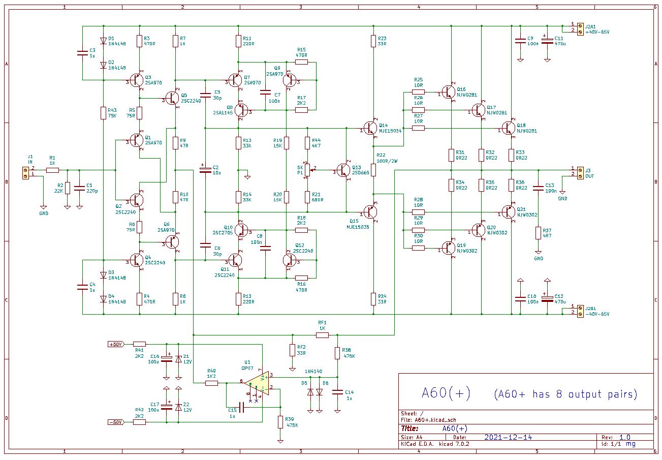

Thanks Berlusconi! Please notice a change in the original schematic, as I noticed a double annotation. (Two resistors)
The schematic that corresponds with the BOM is here.
Thanks @m0rten ,
I think it is the right time to edit the Opening Post and add important stuff there. This scheme along with the BOM should be at the prominent place.
Now, look at the attached table below with parameters of 2SA970 and KSA992. It appears that all transistors can be replaced with these from reliable sources. I am not saying that the existing CDIL are bad but I prefer verified components.
Therefore, I plan to perform the following substitutions:
2SA1145 -> KSA1381
2SA970 -> KSA992
2SC2240 -> KSC1845
2SC2705 -> KSC3503
2SD669 -> KSC2690
Somewhere, I've heard that KSC2690 is used as output coupled thermal regulator in marantz 2245 and 2270. Otherwise, I have an alternative UTC produced 2SD669.
I will report later on on the success/failure of these replacements.

Here is the m0rtens BOM from post #642 , in plain view
Component Count:98

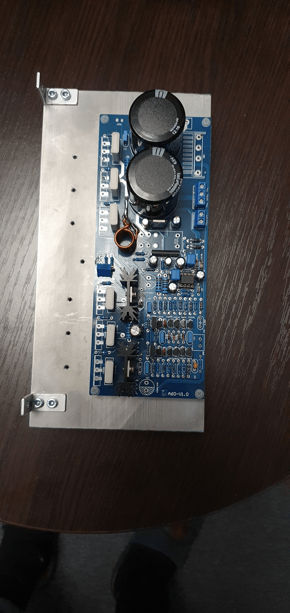

Hello everyone. Question to our experts. Is it possible to install the A60+ board in a separate case horizontally (2 monoblocks), placing the output stage transistors on the right and left on separate radiators? Will the thermal conditions change significantly? There is only one small temperature stabilization transistor and will be located on one radiator. Of course, all this is connected to each other on a thick chassis. What are your opinions?:rolleyes:
I made a relay switch with a remote control to compare 2 amplifiers with switching to one acoustic system. After warming up, blind listening to Dartzeel and A60, 4 people (I’m on fast switching). Cardas interconnect cables, for speakers Kimber Cable 12TC, for the switch all homemade braided 4,2mm section. No winner identified. 2 votes for A60, 2 for Dartzeel. Everyone noted a small difference only in the middle. A60 is brighter, Dartzeel is softer. The only difference is in the connection. Dartzeel played through a pre-Krell with a relay volume control, A60 from the same, but only with a volume control since it has 2 switching outputs with and without pre .The volume is the same. Now I can safely recommend both for production, Dartzeel requires the highest quality components and a good power supply. All the best to everyone.
Hi, It is possible if you have a good thermal conduction between the 2 radiators like a mono bloc radiator or a thick Alu plate (5mm) to fix the radiators. You should place the thermal sensor transistor strategically between the 2 radiators to sensor an average heat dissipation. I think it could be better than one radiator.
