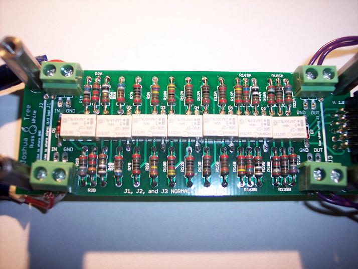

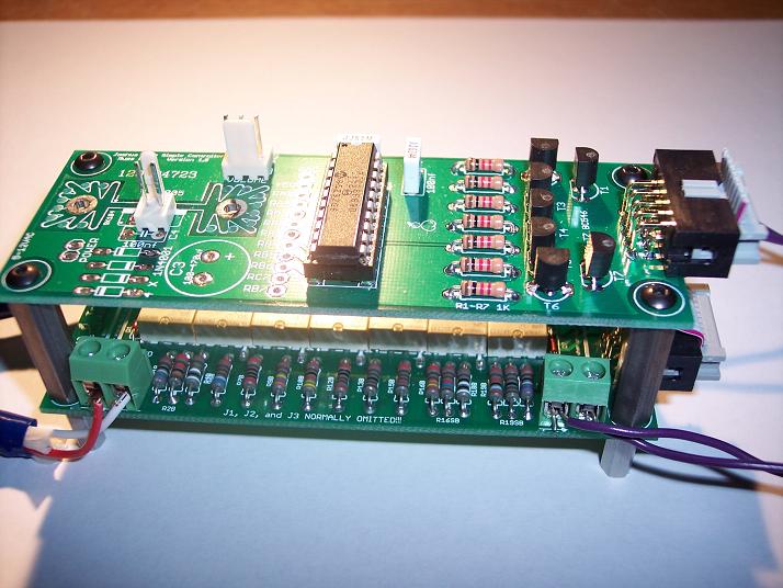

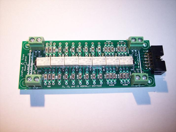

Hi Folks. Well the PCBs got here a few days ago, and I built an SMD version of the Joshua Tree and a through hole version with the kit .6W Pheonix resistors. I can say I like ethem both equally.
There was a small production error on botth the controller and the relay PCB which I was able to correct with an exacto knife and a jumper wire, but I had to have the whole batch remade for the kits. Not going to make you guys mod PCBs. So the kits/PCB may be delayed a week or so, but not more. They actually may get here on time.
Here is a stacked controller with the Pheonix JT.
