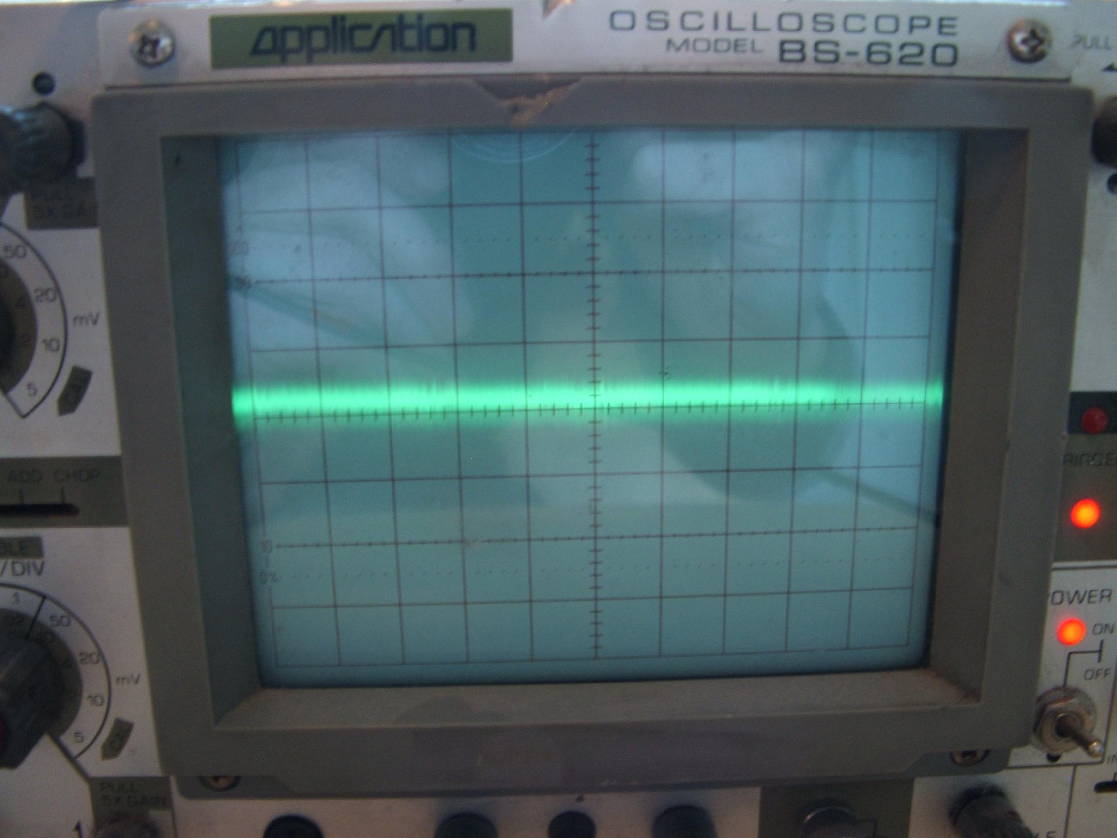

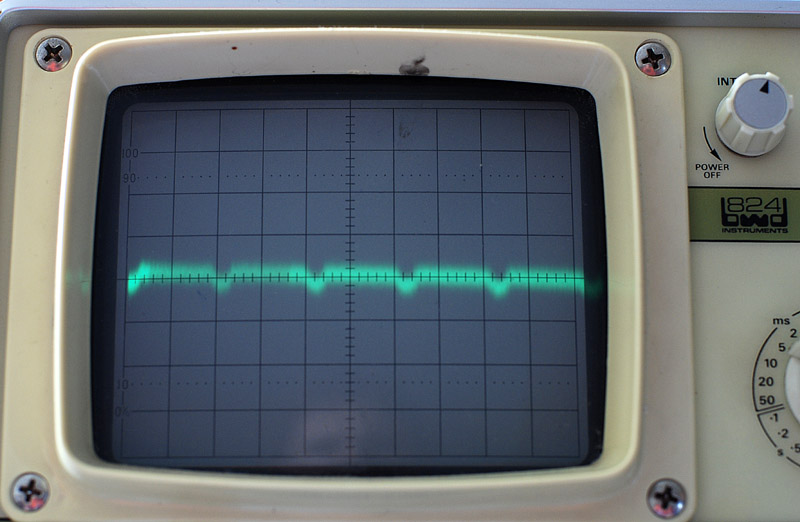

No progress on the chipamp... have been working on finalising the layout of my LM317 dual rail supply. I Unfortunately lost the last changes to the layout when I thought I'd saved the latest version to the hard drive but had actually saved to my usb key (and copied the HD copy to the usb key) but it is an opportunity to re-think and do it better
The noise on the chipamp is very minor, so I'm not concentrating on it too much at the moment, but after seeing NO noise is possible it is something I'd like to address, and will do so before tackling the PSU for the playmaster.
Attached is the measurement of the noise on the output of the chipamp scope was set to 5mv/division (max res of my scope) and 5ms/division I can only hear this with my ear right against the speaker.
Tony.
Tony.

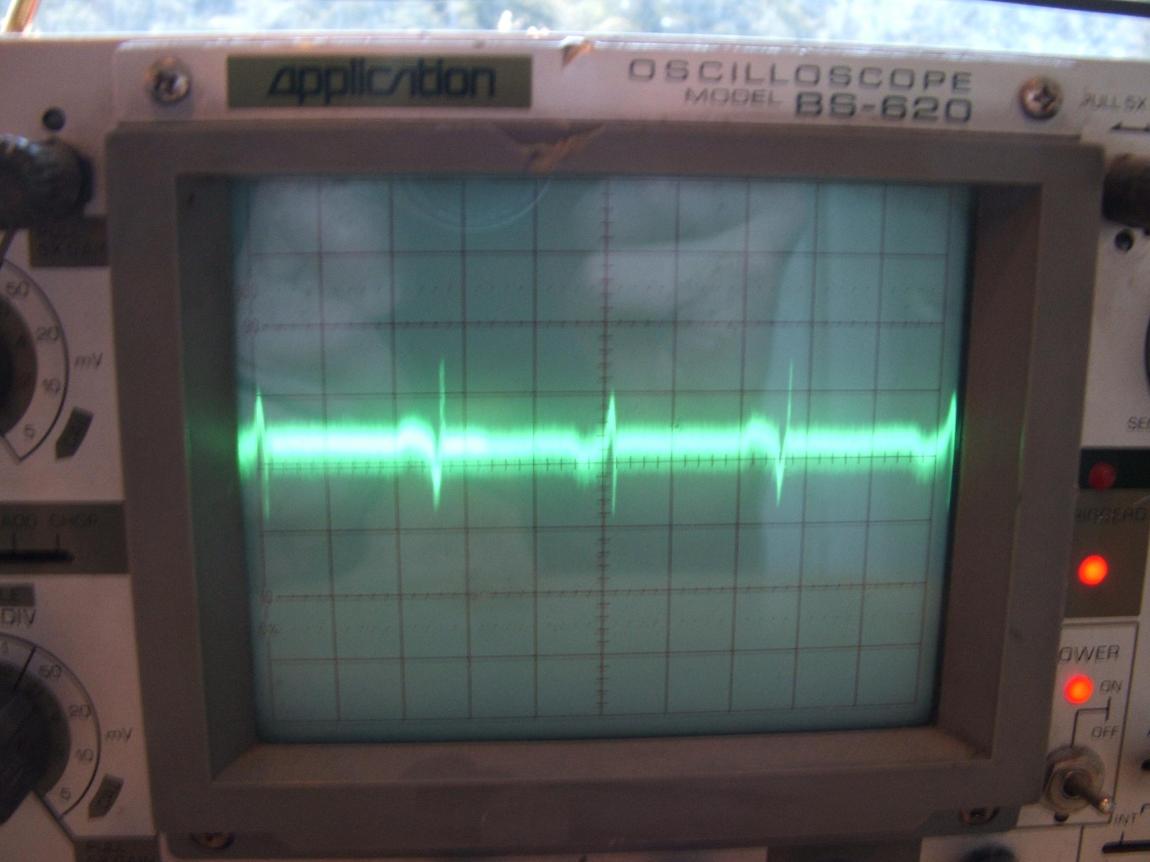

Time to get the scope out again...
First I measured between the DC servo input andf the signal ground point.
For amp1 this looked ok, for amp 2, I could see some ripple.
I then tried to measure between the servo input and signal input on respective cards.. Those measurements showed a lot of noise, but I think the first measurements between servo and gnd are the relevant ones..
Looking at the way I've wired and connected my servo/ protection cards, it is far from perfect..
Looks like I have some potential improvement I can try here before pursuing the ground break resistor option further..
