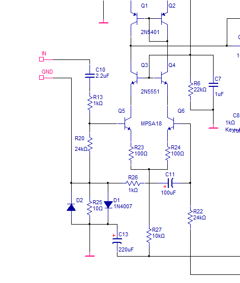

I've attached the schematic of the amplifier card circuit.
Looking at R1 in the input network, there is a connection to the card 0V and a connection pin for the input signal ground.. Would it be possible to do something clever here??

Yes, lead length (within reason) has nearly no impact and certainly not anything that can be heard.
The amp disconnect:
The diodes are needed as there can be a huge potential across this that will burn out a low wattage resistor. The diodes also maintain the safety earth continuity.
looks like your amp boards could be modified - you have to "lift" R22 gnd leg and solder a low ~ 10 to maybe 50 Ohm R in series to the board gnd (the hole you just removed R22 gnd lead from should do)
this lowers loop gain when nothing is attached, but by a very small amount - if the amp were really marginal it could reduce stability - be sure the new resistor is secure - the amp will almost certainly oscillate if the connections are bad or break
the new node is your "differential gnd input" that gets wired to the Xover board gnd with the signal_gnd wire twisted with that channel's signal
you would also add a new 12K (if I read the value right) R from R3 to the Amp board gnd - ideally to the "same" electrical "point" as the 10 Ohm added R, but don't create shorting problems or make a big loop or antenna trying to stretch the lead too far
this forms a divider that ~ turns your amp into a "single op amp, 4 R differential amplifier" the ratio should match the feedback gain ratio (with the added ~10 Ohms assumed to be shorted out )
the added 12K does raise the lower frequency corner with the 2.2 uF input C - to ~7Hz - not a problem at all on the higher frequency outs, if trying for really low output on the woofer amp board you might increase the cap value
the added 12 KOhm also lowers the input impedance and level matching pots in series with the XO op amp outputs will upset the division ratio
the positive signal input to the amp board remains the same - do twist the signal with the signal_gnd wire to the Xover board
I don't show how Xover PS gnd and Amp PS gnd get together since there are a few more options with the diff input amp scheme
Thanks John!
This is really interresting info..
As described in a previous post, I tried to insert some resistors between the signal cable screens and the ground on my x-over card.. perhaps I had the (sort of) right idea, but incorrect implementation. I can see that my implementation would not "isolate" the ground reference in the amplifier input network from the ground of the amplifier card in the same way as with your schematic.
It should be wuite possible to implement this on my amplifier cards by cutting a trace and solder a resistor across.
Adding the pair of diodes makes things a bit more complicated though.. Obviously, they are not required for the signal ground "isolation" point of view. But for a serious short or malfunction taking place "upstream" they will prevent the resistor from burning out from current seeking a path to the star ground point. Having said that, I assume that such a current will take the path of least resistance through the ground wire going from the X-over card to the starpoint.
Here I assume that implementation of these resistors will allow screen to be connected both at the amp and x-over end, and that the x-over grounding should then be done directly from the starpoint and not through the x-over to amp signal cable screens.
Regarding huge voltage potentials across this resistor, I'm struggling a bit to see where that can come from, and wouldn't that be shunted through the X-over cards ground connection to the star point?
Sorry if I go on here.. I just need to get my head arround this properly before making a move to modify the amplifier cards as it is a big job to disconnect and remove them from the chasiss and the heatsink.

the XO PS gnd does have to have a safety gnd connection (or double/reinforced insulation and construction and pass a 4KV HiPot test)
you could use (but may not have to if the diff recievers do a good enough job) the shorted diode bridge "gnd lift" trick between the XO PS gnd and the safety gnd (+ Amp PS, Star gnd, chassis) - be sure the diodes and any PS gnd wiring are rated for enough current to blow the house breaker
then you only need one clamp circuit instead of diodes at each amp board
the amp boards reach safety gnd on "the other side" of the added input R - so they sould work the same as before for safety gnd

Just to try to get this straight in my head..
If I have the X-over 0V connected to the main 0V star point, could I then Implement John's "disconnect" without the two didodes in parallel to the 10 Ohm resistor?
If so;

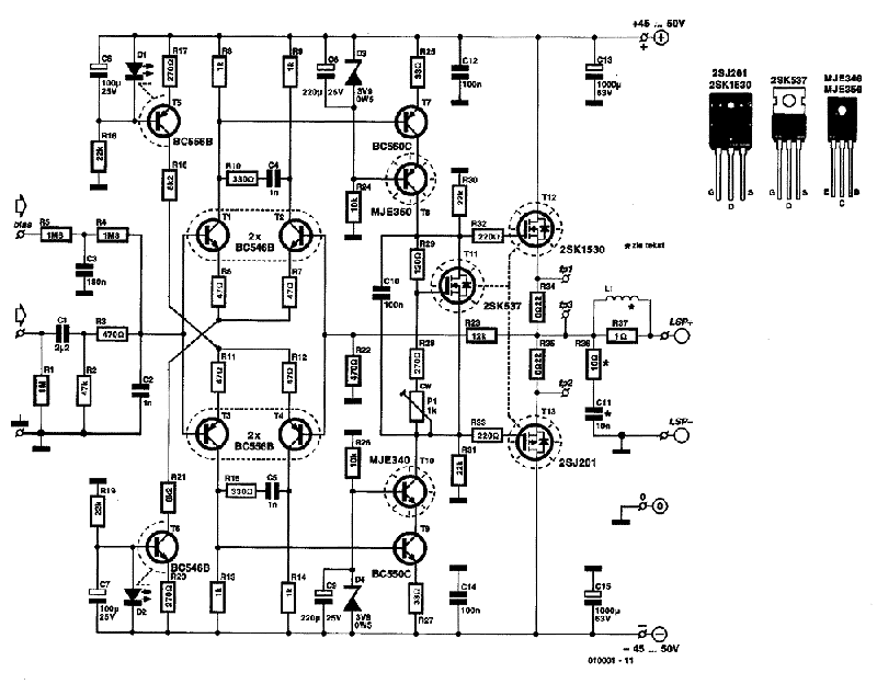

Looking at the schematic for my amp, I'm trying to figure out where this could be implemented.
Looking at R1, there is a ground connection just next to the input ground pin in the input network.
If that ground connection was broken and a 10 Ohm resistor soldered across, would that do the trick?
If so;
