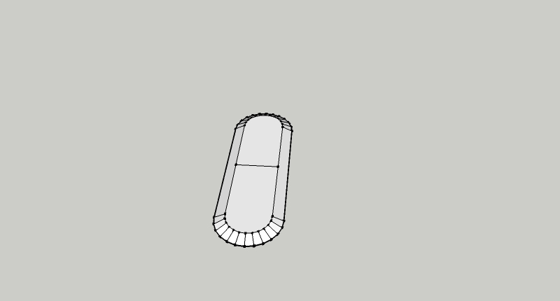

So far i tried to make the pancake coil to sandwich in between the 2 paper roles, tried 4 and all came out awfull. so im making a bobine, not sure if that works yet.
here is the design of the bobine in sketchup. im gone 3d cnc it out of HDPE since super glue does not like to stick to it. i could not find a bigger block to cut it out (only leftover i had)
https://youtu.be/mWqa6Hu7O48
i make 2 halves and because of the bevel its easier to get the wire into the 0.2mm slot.
The 2 halves are spaced with 2 pieces of nomex paper, also video on cutting that. its pretty hard somehow my knife does not like to cut nomex, it needs allot of force, out of the 6 pieces i could only use 3 the others are not cut trough and trough , and this nomex is even hard to tear. damn nasty stuff. so i could not get the holes punched out its to strong.
https://youtu.be/vtPPk_XDrGw
By the way, self bonding magnet wire would be awesome for this purpose!! wind it on bobine trow into oven , wait and get it out, and you should have a nice self supporting coil
(ofc i then need to make a bobine out of aluminium or my misses will be angry!)

well this is harder then i thought. its not easy to wind a flat coil. it either does stick to the bobine. or even worse it does get nice and tight and the ends of the bobine since there is where the bobine is under the most tension when grabbing the next amount of wire, since its not a round bobine. the part in the midle is not as compact and tends to bulge so it becomes more of a O with eating disorder instead of an I
. next thinh i try is drilling some holes in one of the bobines, at places where the wire will be on the inside. now i try to wind the bobine without glue that can be in the way of winding tight. then when im done i use a seringe to push some 3M 30nf glue in let it soak around all the wires. then drop it in a oven to cure faster. and i should be able to disassemble the bobine and have a glued coil.... well thats theory
aaaauw that thing is hot..... my over cant go lower then 100c.... 30 under melting temp of HDPE , i let it coolo down before i open it. im so curious. it wont be perfect but i hope better then al my previous attempts

Please excuse me, i'm tired. The V shape in laterall influnce the directivity of sound and not the Spl.
You shoul make the Janus 50 to really compare these speakers.
Thx !!! I dont think THE 30 degree angle is going to do anyrhing iets just à baflle , i indeed should play with THE form an the material it self.
