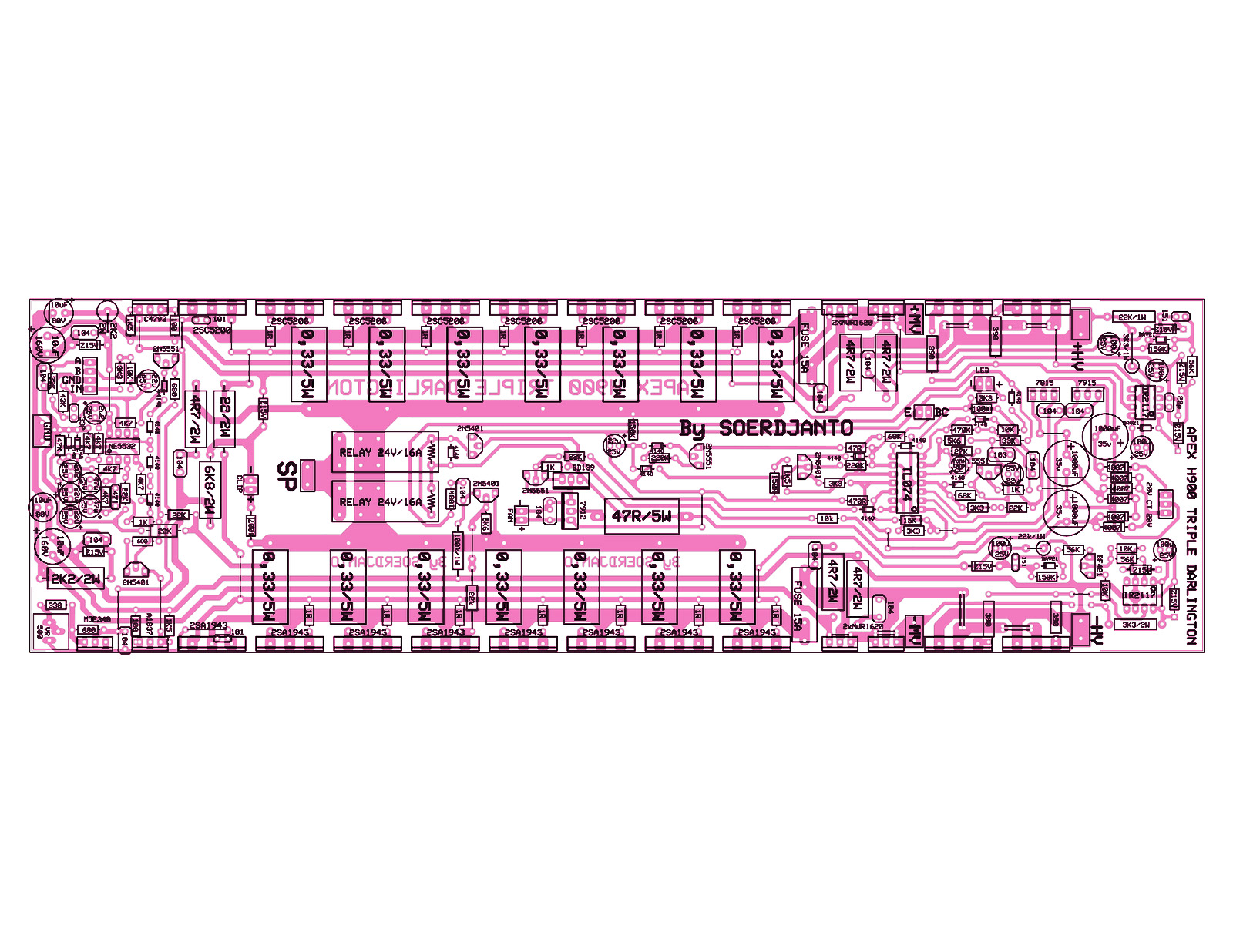

PCB
Please upload the pcb (design) original.
also raises the pcb (design) original. the previous message.
ohhhhhhhhooo realyAn externally hosted image should be here but it was not working when we last tested it.
can u giv pdf file
soerdjanto;3303885 Could u shared me about u'r design with sprint layout? said:yah... sudah ada contohnya tinggal digambar ulang (just re draw .. )
ok,.. thanks mr hand_rich

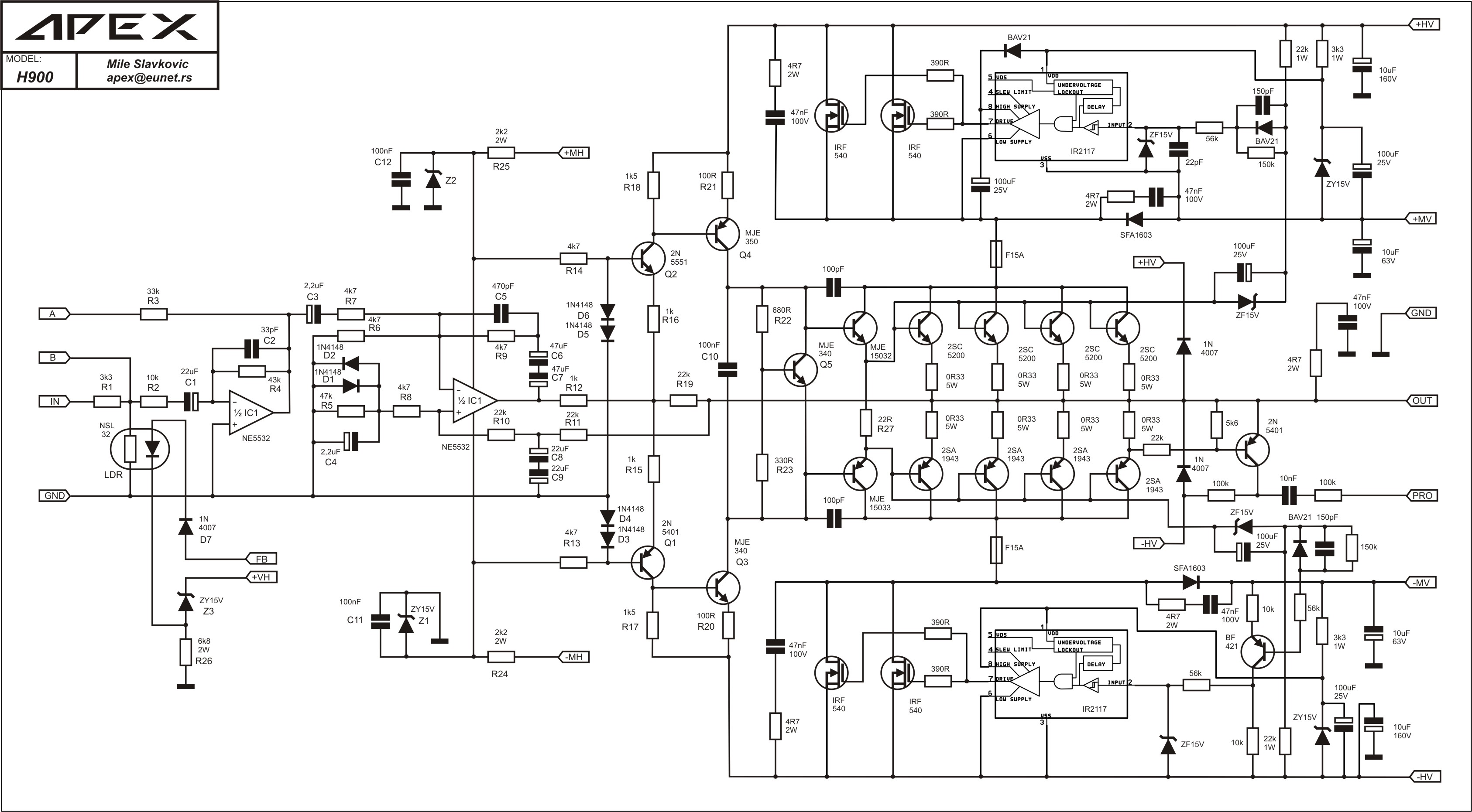

I'm wondering if the Apex Step Driver will work with my Panson Audio Initial Series 4 Pair Output board...
If i understand right my reference point will be fed from the pre-drivers. Is this correct??
Power would be fed by 2x 800VA Toroids ( 80VCT, 60VCT, 36VCT and 24VCT )
The 80V and 60V sections would be fed into its respective my rectifying board, that are loaded with 6x 15000uF caps and the other sections would be a simple 5A or 10A bridge and 1000uF cap.
This is will be applied for each Monoblock...

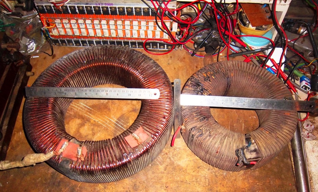

my h900
Nice work, transformer about 20kg?
rohmad fauzy is my good friend,
he build toroidal transformer almoust 40kg
use voltage for apex h900tef 120vac-60vac-ct-60vac-120vac or 170vdc-85vdc-ct-85vdc-170vdc
and 12 pair c5200/a1943
with my design pcb h900tef
CIIMW
- 900W H-class PA Amp with Limiter
