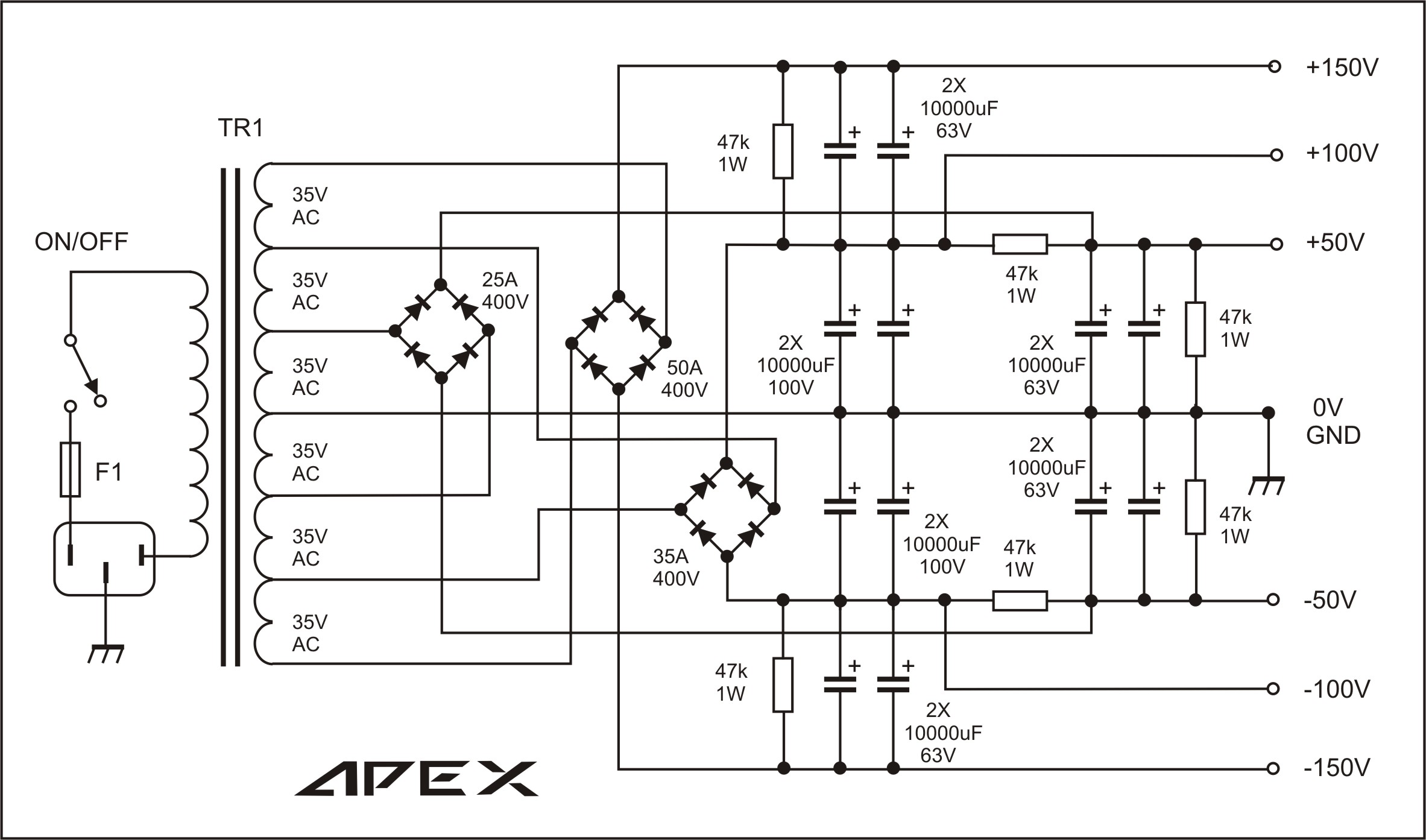

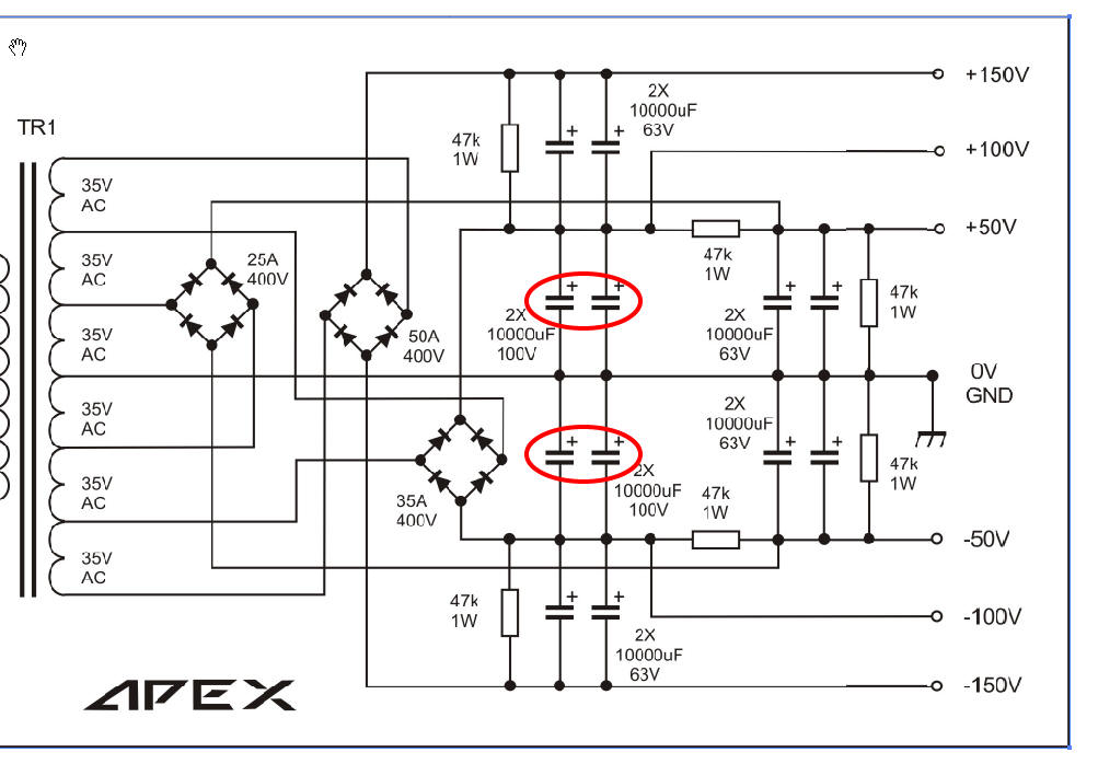

The 50Vdc from 35Vac transformer varies with mains voltage. This applies when regulation ~4%
It can be as low as 48Vdc and as high as 53Vdc
If you double this from a 70Vac tapping then the maximum voltage could be as high as 106Vdc.
If regulation is >>4%, then the worst case highest voltage can be >>100Vdc
I would not do that !

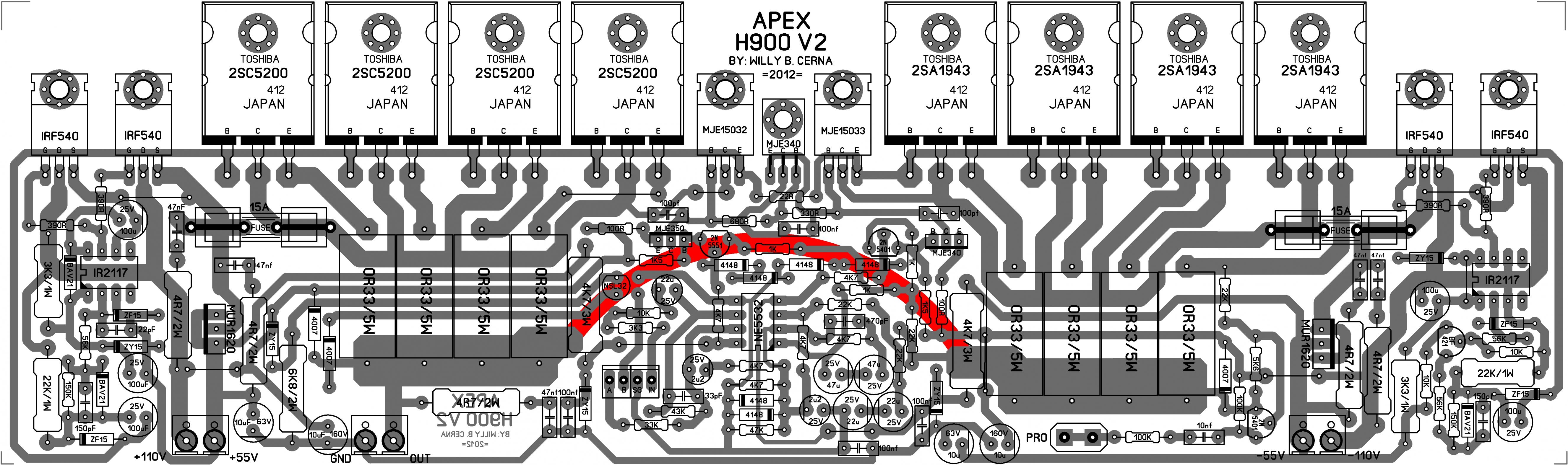

h900 v.2
good job sir,...
thanks n regards
i've cek your layout, thats nice n good layout, so there are more space for some component. your layout has true.. please send to : ugho_mdlx@yahoo.comHello Rizqi,
Thanks.. This design have not been tested yet i'm still trying to find some error before i etch, but you can also review and let me know if you found any mistake so i can correct the error.
Send me your email add so i can forward you the sprint layout file.
good job sir,...
thanks n regards
good job sir,...
thanks n regards
File sent, please check your mail.
Rizqi,
Please dont forget red Jumper.
Ok sir,... thanks for all...Rizqi,

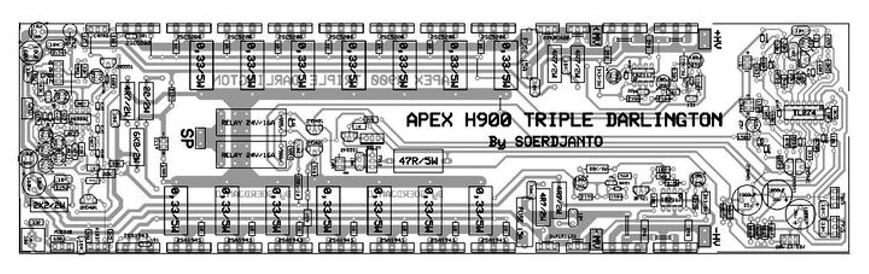

I need the circuit H900 TEF and design layoutnya, can help me
Basically laout is b500 tef. B500tef has uploaded in this forum...
I found these files, where are the p.c.b. files
In that part is complete with all the PBC data.
Please could you upload
This is all what I could find, I will make p.c.b with it's help. but will have to wait
: D.No problem.
I'll wait for you to finish.
