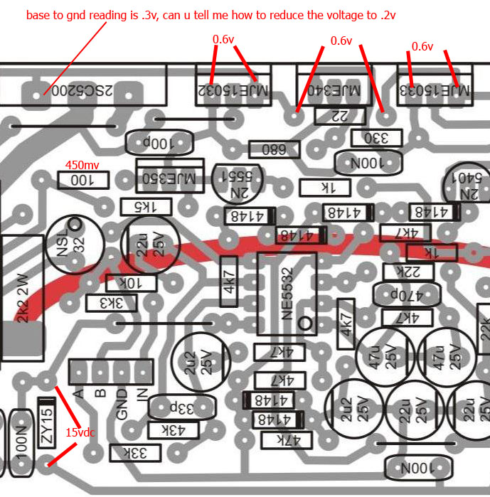

hi apex sir,
can u tell me how to reduce the voltage base to gnd, on outputs
hi rizki and ravpeet i need 0.2v (200mv) base to gnd without vr.
if i put 560ohm instead 680 ohm resistor.
firstly add 1k pre set and set voltage according to need .first time set pre set in center and rotate slowly .....after set voltage on base . remove the pre set carefully and check the pre set on multimeter according the dmm reading you add resister on place of pre set....
