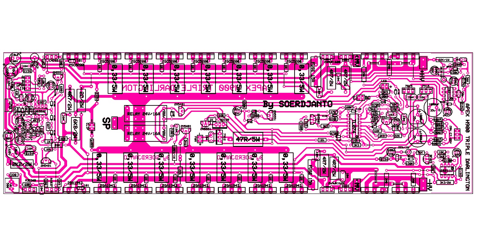

he build toroidal transformer almoust 40kg
use voltage for apex h900tef 120vac-60vac-ct-60vac-120vac or 170vdc-85vdc-ct-85vdc-170vdc
and 12 pair c5200/a1943
with my design pcb h900tef

isn´t that a little bit too much? at peak power there would be about 300Vdc of Vce at output transistors and max for them is about 200V... it will burn even with no load!

I'm wondering if the Apex Step Driver will work with my Panson Audio Initial Series 4 Pair Output board...
If i understand right my reference point will be fed from the pre-drivers. Is this correct??
Power would be fed by 2x 800VA Toroids ( 80VCT, 60VCT, 36VCT and 24VCT )
The 80V and 60V sections would be fed into its respective my rectifying board, that are loaded with 6x 15000uF caps and the other sections would be a simple 5A or 10A bridge and 1000uF cap.
This is will be applied for each Monoblock...

this guy is not sharing pcb layouts, shellfish guy.
may you share pcb design?

Yes, but here in this thread people have no knowledge about the reliable working of an amplifier, all they do is copy , copy and make a big amp without knowing an iota about it.
