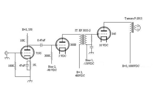

I've worked up a draft of the audio circuit I would like to use for a foundation. Again, I am relatively new at this, and I am sure it is FILLED with errors so please don't attack me. I'm finding this is a lot harder than building a simple one stage pre.
I'll work up the heater supplies when I get some more time. I'm kinda scrambled with this damn transit strike. It's times like these I wish I didn't put off shopping for the last minute.

Hi Bryan,
Your design looks pretty good, I would reduce the value of that 300K resistor on the grid of your 300B to about 100K, the cap value should be fine as is. Reducing the grid resistor is to prevent possible run away due to grid current - also the data sheet of most types I have seen recommend 100K with fixed bias - which would be my choice incidentally.
I also recommend adding 1K grid stopper resistors right at the sockets of all three tubes as this is a sure way to prevent parasitic VHF oscillations that frequently occur.
The design does not look too different than what I am currently working on. A first for me, I am not planning on using voltage regulation in this design at least initially.
I think there is just enough gain to drive the 845 to full power, although the voltage sensitivity of the amplifier might end up being around 3Vrms or so..
On regulation, don't regulate the grid bias if you are not regulating the B+, although the match is imperfect the two supplies will track each other and this will result in less variation in the operating points of the driver and output stages.
Brian,
I concur with kevinkr's comments about the 300B grid leak, an alternative would be to use cathode bias for this stage.
Other than that, the schematic looks as if it will work to me, as long as you ground the -ve heater connection of the DHT's. You'll find it less trouble and certainly safer if you put a small resistor (say 10 ohm) in series to ground as a means of measuring the current. Also, a 100mA fuse in the anode supplies will save the valves if you accidentally lose bias volts...
Thanks for the comments guys,
Like I said, this circuit will work as a foundation for me to improve upon as I get things wired up. I imagine I will need to "tweek" a bunch of factors to get the final product polished.
I'm now curious if there is a method to approximate the total power one can expect from an amp without the use of sophisticated simulation software? Furthermore, are distortion measurements only obtainable with hardware?
John, you mention the need for a low impedance source to drive the 845's grid effectively, aka to provide the "growl". With my current set-up, I assume the impedance is solely a function of the 300B's characteristics? Is there a simple way to calculate this? What values are acceptable here?
Hmm, effect of lowering the 300B gridleak... OK, I think I'm getting the picture here. We lower the gridleak value, and thus current from the previous stage has an "easier" source to ground. To cure this we need lower source impedance and/or high gain. This could be achieved by changing to SSRP, or even more effectively using a mu follower. Is my thougth correct here?
This raises another question. If one changes from a comon cathode stage to a SSRP or mu follower, which tubes dictate the "sound" of the stage?
Lastly, what does one do if they don't need the gain, but want lower source impedence???

Yes, once you hear some sound and can see some waveforms it will seem more "animate".Like I said, this circuit will work as a foundation for me to improve upon as I get things wired up. I imagine I will need to "tweek" a bunch of factors to get the final product polished.
Around 25% of anode dissapation in class A1 single ended triode - it's the least efficient. Have a look at page 20. here .I'm now curious if there is a method to approximate the total power one can expect from an amp without the use of sophisticated simulation software? Furthermore, are distortion measurements only obtainable with hardware?
There are many web resources for info. My own reference is the RDH Radiotron Designers' Handbook. Well worth looking out for a copy. All the math is in there. Once I'd nuckled down, it even allowed me to predict the even vs 3rd ratio of my 7519 project - yet to be proven in practice though....
For triodes, there is a spreadsheet on Steve Bench's website, though I've not used it.
I wouldn't use "growl" as we're not talking about the way it sounds at any level, but at a particular level (peaks).John, you mention the need for a low impedance source to drive the 845's grid effectively, aka to provide the "growl". With my current set-up, I assume the impedance is solely a function of the 300B's characteristics? Is there a simple way to calculate this? What values are acceptable here?
The impedance driving the grid will be formed by the ra of the 300B and the DC resistance of the IT. Neither will be significant until grid current is reached.
The impedance will be lower when the 300B is run at higher current, and with no voltage feedback in the cathode ie capacitor bypassed resistor if cathode bias is employed. The 10 ohm resistor I suggested is insignificant. You could also reduce the impedance by applying local NFB to the grid.

The resistor on the grid of the 300B allows for a path for grid current to flow. In an ideal world there is no grid current, but our tubes don't live in an ideal world. In reality there is a small amount of grid current in most tubes. This varies with the operating voltage and the tubes temperature. It is highly dependant on the quality of vacuum in the tube. In any case this grid current tends to oppose the bias, causing the tube to draw more current, which causes more heat, which causes more grid current. In worst case situations, the tube will run away, glow red, and die! This is why there is an upper limit on the value of the grid resistor. It is in the tube manual, specified for most every power tube, and manny small signal tubes. These specs are often copies of old tube specs made back when they had good vacuum equipment. Some tubes of current manufacture may not have a vacuum as good as those made when the spec was written. This is why the grid resistor should be kept as low as posible. Fixed bias is less tolerant of grid current than cathode bias.
On the subject of power, I get 21 watts (at 5%) in class A1 with 1KV plate voltage with a 10K transformer. I get 25 watts (5%)with 1150 volts (A1) with the same transformer. The 845 is one of those tubes that remains linear well into the positive grid voltage region, so if you can drive it to +50 volts on the grid, you will get lots of power. In the same amp, at 1150 volts, the distortion at 30 watts is 1.22%. The amp is well into A2 with the grid voltage reaching +30 volts on peaks. I had to turn up the power to 37 watts to reach 5% distortion. Hard clip occurs at 39 watts. The grid voltage reaches +52 volts at this point.

Changing the grid resistor on the 300B from 300K to 100K should not necessitate any change in the driver stage provided that the current "lost" in this resistor is roughly equivalent to 10% or less of the signal current flowing in the plate circuit based on my experience with 6SN7, the change in effective plate ac load line is relatively small and in any event I don't believe you typically will be swinging anything close to the roughly 80vpk required to drive the 300B to full output. I would leave it as is.
I strongly recommend fixed bias operation, there is then no issue with the quality of the cathode decoupling capacitor or potential blocking under overdrive conditions. (Admittedly unlikely as I doubt the driver can drive the 300B into hard saturation.)
In terms of referencing the dht filament to ground it is better in my experience particularly if there is any noise on the filament supply to use a pair of 22 - 27 ohm resistors, one from each filament pin to ground, neither side of the filament supply being directly grounded. An additional small resistor in series between the common point and ground makes it easy to measure the cathode current.

I am going to build the circuit as is and see what my ears and the scope think. I can sit around and pontificate for years, but in the end the "perfect amp" wont come to be, solely, on paper...
I will draw up a few circuits for the bias's and heaters over the next few days and post. As long as things look good, building should begin shortly after Christmas.

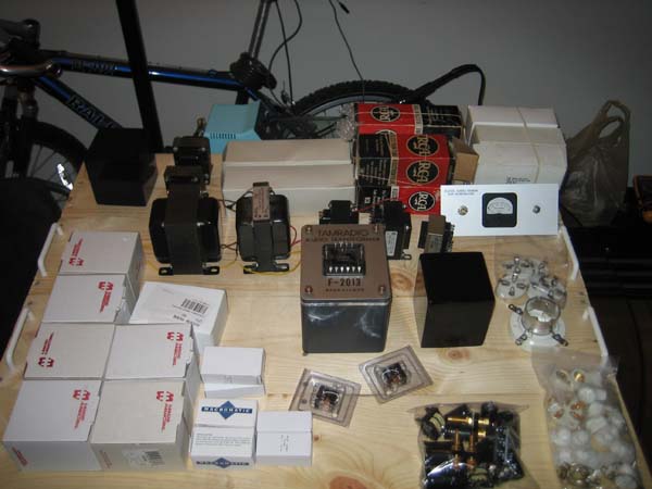

Bryan said:And here are SOME of the parts laid out for ONE channel. Oh man, my gf is going to kill me when she gets home!

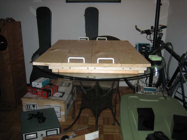

Once again the dining table has been converted to a work-bench!
The next dining room table I get has to have good overhead lighting and a power outlet strip under one side.
