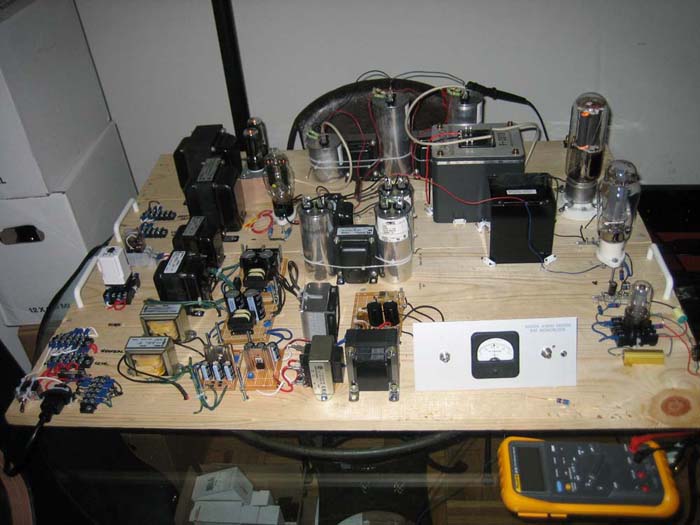

Hey Guys,
I decided to post a photo of the monster I've been working on. I feel like a proud father with his new son.
The previous problem with the OPT was a small sloder lug on the underside of the speaker terminal had moved while tightening the bolt and made contact with the other terminal resulting in a short. Good call guys!!! Thanks.
Anyway, he works and I have never been happier listening to just one channel.
Initial observations are that the gain is low (but we all know that was going to be an issue). I have played the amp through my AV speakers which are 90dB and the volume capability is fine. They get pretty damn loud, loud enough to fill the room with ease, but the volume pot is near its limits at this point. I may need to tweak with the input tube in the future.... More measurements and tweaks for another day....
Once I burn it in a little more (ie am sure it is working fine for more than 20 minutes) I will attach her to the ProAc's and see how it sounds. If the test speaker is any indication, I will be happy!
Thanks again for everyones assistance. If any of you make it to the NYC area, home-brews await you!

What color 'ya gonna stain the board? :D
Don't you think you should have left room for serviettes and utensils (plastic recommended). So how many can this amp serve? I've heard of dinner by candle light but by DHT?
Now that I got the cornball jokes out of the way. I'm very glad you got it working! I'm interested in seeing it after it is in it's final form.

All is good with the amp, and it is nearing it's final stage.
I am currently designing PCD boards for the fil regs, fan voltage source, bias curcuitry, etc etc. Once that is done, I plan to work on layout of the PS.
I am going to make this a 4 chassis monster. Individual PS and Audio chassis for each channel.
