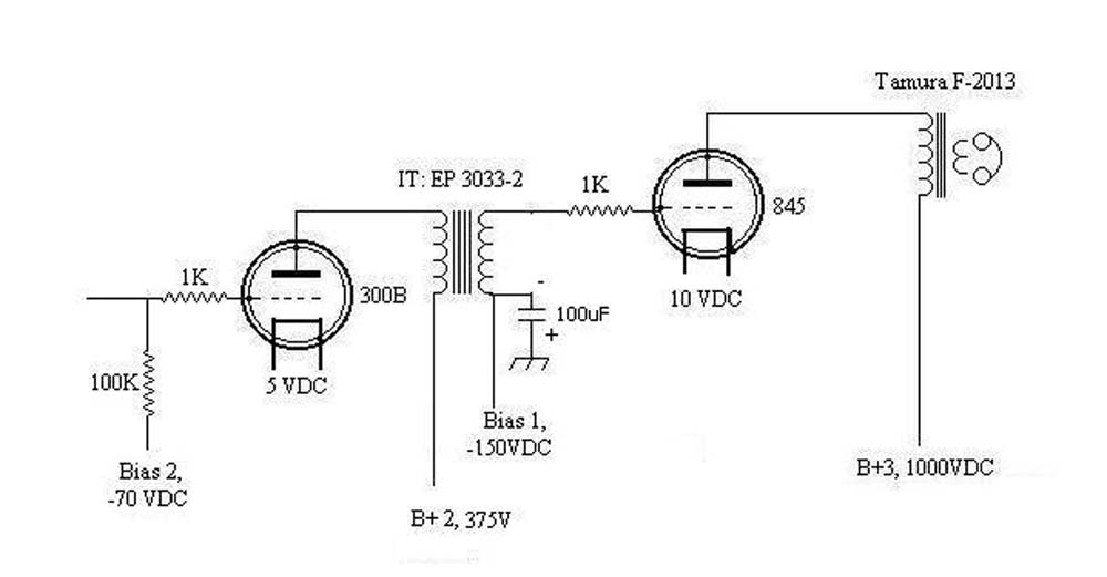

Hey Guys,
Your line of reasoning seems logical, and consequently what I have done.
The 845 has plate voltage, negative bias, and current which is adjustable with the bias pot. Yet, no sound. I will double check the wiring around the secondaries, as it is possible that I am shorting the AC path with a miswired cap off the TOP of the IT....
Heck, maybe my speaker is busted and I just don't know it... I'll check that as well.
With respect to signal on the output, what should I observe here if I probe the output terminals. Obviously some AC fluctuating... But at what voltages...

If the plate current of the output tube is swinging with the signal, then it is obviously getting signal. This implies that the problem must be between the tube and the speaker. There aren't to many things in that path (the OPT and the wiring). Check to make sure that your speaker is connected, and there is no accidental short across it. I know it is unlikely but check to be sure that you don't accidentally have the OPT connected backwards (primary and secondary switched). I have actually done this using the Handwound transformer, because of the non - standard color code.
With the power off and everything discharged, measure the resistance of the secondary of your OPT. It should be under 1 ohm. The primary must be OK or you wouldn't have any tube current but it should be 50 to 200 ohms. Then check the continuity of the path to the speaker.
If you put a voltmater (set on AC volts) across the speaker leads you will get random numbers (or a bouncing needle) with music. If you have a test CD play a continuous tone near 1KHz and you should read an AC voltage that increases as you turn up the volume. 30 watts will be about 15 volts with an 8 ohm load. If there is the possibility that there is no load on the amplifier, do not turn it up loud. The OPT could be damaged.
The tube current will usually stay pretty constant until you start to leave class A1 then it will increase on peaks. A digital meter will read the signal current and fluctuate around. A mechanical analog meter should be pretty constant until you get loud. If it is moving around a lot with a relatively small signal, I would suspect clipping caused by an open or shorted load.

Some input.
I've just checked the OPT wiring with the terminals and the test speaker. All seems fine. There are no shorts from the positive terminal to ground. There is also no connection referrencing the negative speaker terminal to ground, which is correct, right?
One thing I am noticing is that voltage is swinging on the grid of the 845. When I start to bring up the 845 B+ with the variac I immediately see the ammeter bouncing, enev when there is relatively low voltage on the plate of the 845.
Still no resistor between the top and bottom leg of the IT secondary... The cap (100uF electro) is present with the positive terminal to ground and the negative terminal to the bias which also conncets to the lower leg of the IT secondary as in the schematic....

Your IT wiring should be fine. Swapping the plate and grid wires would usually bring on a short unhappy life for the 845. If you can set your tube current by adjusting the bias, this is NOT the problem.
I am assuming that the voltage swinging on the grid is due to signal input. This is normal. The voltage on the grid, and the plate current should be steady with no signal. The plate current will change with signal in normal operation, most analog meters won't move fast enough to show it though.
The resistor on the IT is not needed to make sound.
The negative speaker connection should be grounded for safety reasons, but it is not necessary for amplifier operation. If your transformer ever developed a short from primary to secondary it would put 1000 volts on your speaker leads. The amplifier will keep on working normally until an unlucky person touches the speaker terminal. This is an unlikely event, but I have seen it happen! Grounding the negative lead will blow the power supply fuse.
It still seems to me that the amplifier (up to the OPT) is working. Try measuring the resistance between the speaker terminals (speaker disconnected) you should still get 1/2 ohm. Just to make sure measure the resistance of your speaker (including the wire) right at the point where you would plug it into the amp.

It's a Tamura transformer right?
Make sure you don't have the "E" or "G" connection confused with the "0" connection on the secondary. The speaker needs to be attached between the "0" connection and the "8" or whichever tap you're using. The "E" or "G" connection is for grounding the transformer case.
I made this mistake with my Tamura trans and had exactly the symptoms you describe.

I hope you get this figured out. I'm sorry that my advice appeared to be stupid because it was based on a schematic that I was referred to (post 226) that is missing circuit paths and a bias supply.
As shown, the capacitor is interupting the DC path from the 845 grid and not only will class A2 not be possible, nor will A1. In fact, that circuit as presented has no class at all! My advice based on what I was shown, to nix the cap was not wrong.

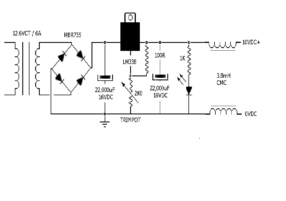

Also the 845 heater supply is critical on how you bypass that, since that is passing the AC signal current, ie..audio signal... The hot cathode needs to be at AC Ground potential...

Here is the 845 heater circuit. The 0 VDC is referrenced to earth at the fillament pin.

Bryan said:I take the bias from the wiper on the pot directly to the grid of the 845.
No, no. The wiper output on the bias adjustment pot shud go to the bottom point on the IT secondary where the capacitor is connected and the other end of the cap is grounded. If the pot wiper is tied directly to the grid it is shunting the audio feed to the 845, therefore no audio.
The 845 grid shud only go directly to the top of the IT secondary winding. A resistor across the secondary of the IT is optional and will only improve the sound, once you get it working.
I fear that you have a short on the secondary of your output xfmer. Look for a short or solder blob as another suggested, Did you try hooking the speaker between ohm taps as I suggested? Try lifting ground off the "0" terminal just for test purposes.
