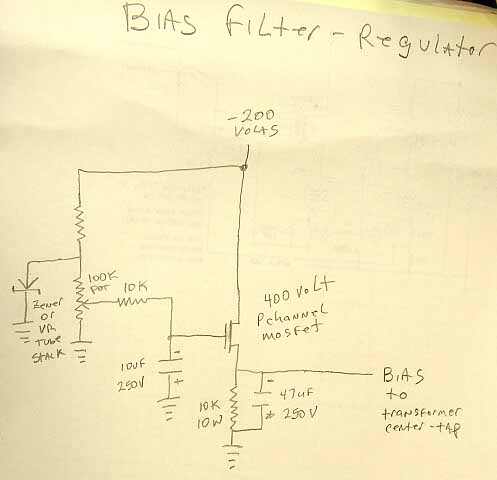

When I was experimenting with an IT I used a pot feeding a source follower made with a P channel mosfet to provide a low impedance buffer for the bias supply. I made the circuit up as I went along. I know that I scratched the schematic down somewhere, but I can't find it. You would need 2 of these, one for each channel.
It was something rediculously simple, drain tied to the B- supply, bias pot connected to the gate, resistor and cap connected from source to ground. The source is the feed point to the transformer. The resistor was big, like 10K 10 watt, but it diidn't get hot, it was what I could find at the time.

I found the schematic!
I used this with a push pull transformer driven pentode amp experiment. Some values may need to be changed. The schematic shows a zener diode. You could use a string of zeners or VR tubes to make this into a bias filter and regulator. Leave these parts out for a filter - buffer only circuit.
There is good reason NOT to use a bias regulator if you are not regulating the plate voltage in a triode amp. This will make the plate current very dependent on the power line voltage. In a pentode amp with a screen regulator, it is good to regulate the bias voltage.

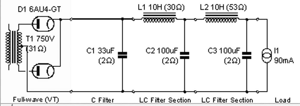

As mentioned in a few posts back, I am having problems powering up the amp when connected to the mains w/o the variac.
As mentioned in the previous posts, the 2A fuse on the mains was not up to the task. So, I decided to repeat this with a 2.5A fast blow. When the delay relay triggered, the fuse blew as observed before (expected result). That said, I then switched to the 4A slow-blow.
When the mains was switched, the fils, regulator cooling fan, and input/driver rectifier heater all powered up w/o a problem. After about a 90 second delay, the relay triggered and applied power the the input/driver B+ and the 845 B+ circuit (6AU4 heaters and HV txfmr). The B+ to the driver came up immediately as expected and the 6AU4s began to warm up. I had the DVM on the stack of bleeder resistors for the 845 B+ filter caps as a means to measure B+. After about 10 seconds the voltage starts to climb, and after another 10 seconds starts to raise at a quick rate. When the DVM measured about 400V (this is at the juntion between the second and 3rd resistor = ~2/3 B+) the fuse blew as before...
So, what I noticed as the fuse blew was an arc in the 6AU4 and a rumble (mechanical noise) which came from the 6AU4s. Also, the B+ on the filter caps was very quickly discharged, where as it usually takes a few minutes to bleed down, in this case it was down in the teens between the time I first say the arc in the 6AU4 and the time it took me to look over at the DVM (a couple seconds). So, what is going on here. Could I have a bad 6AU4, or is the 33uF-10H-100uF-10H-100uF filter causing too much current to be drawn through the 6AU4s thus resulting in the arc/rumble?
I may try to bring up the 845B+ with the variac again to ensure the circuit is intact. Everything checks fine, but the problem persists. I'll await advice before I continue.
Thoughts?

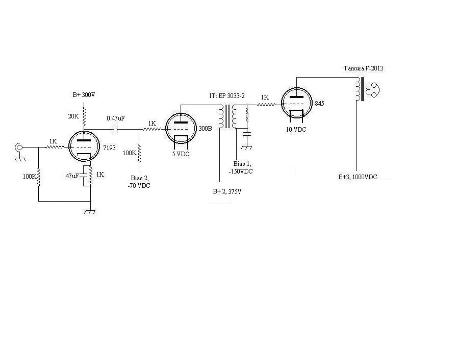

If you could post schematic...or I will go back and look in older posts....
Start-up of a power supply and circuit need to be sequenced properly... SOunds like the 6AU4 might have shorted....
You may need to put in small zeners to hold the voltages in place before the amp is up and properly pulling currents... I won't know till I see the circuit...

As mentioned, everything is powered up with the mains switch with the exception of the 845 B+ supply (HV txfmr and 6AU4's) and the input/driver HV txfmr.
When I run the sim in PSUD I do get a warning about exceednig the peak current of the diode... Maybe this is an indication of the problem.
Thoughts?

Momentary arcing usually does not cause permanent damage unless there was a continuous arc. That could cause enough localized heating to break down the heater to cathode insulation.
I get sparks in the 5AR4 in one of my amplifiers every so often. It uses a 100uf input cap which is way to large. It was the only cap that I had at the time. It still has the same tube after 2 1/2 years.
If the removal of the cap stops the fireworks, you can try a smaller value cap there. It may be possible to find a cap that gives you enough voltage without fireworks.
You don't show the heater winding for the 6AU4's. Is it grounded?
This could cause a heater to cathode breakdown, resulting in fireworks.
Another possibility is to use SS rectification with HV FRED diodes. These have a much higher peak current rating.
