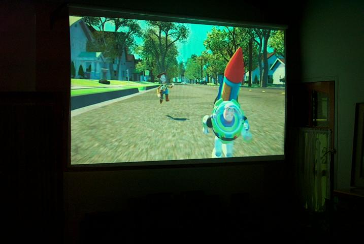

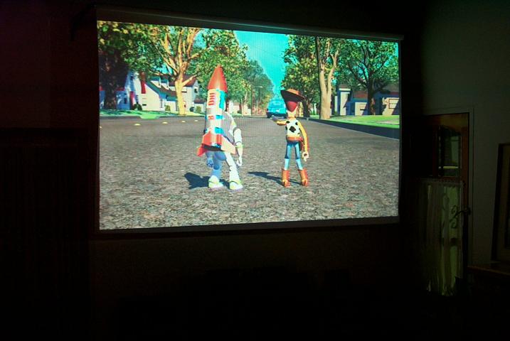

Hey beforcade, what settings have you got on the monitor? ie for vga what red, green and blue level are u running at? and whats the brightness and contrast levels?
Hi Trev !
I'm using the default values on the Lilliput. RGB levels are set by default at 50%. The same with Brightness and Contrast: 50%
But I get the same effect with composite input (and with my previous panel -Ovation 842-.)
So I'm prety sure it got to be my bulb because is the only thing in common with my old setup. Too much UV ?

It sure does, thanks!! BTW, I believe (from what I've read everywhere) that the problem you have with your blues must be because of the color temp of the bulb you're using. 6000 is too high. Film projectors use 5600, and I'v seen good results with temp even under 5000. I'd try to get something under 5500.

Too much UV ?
Nope, uv is invisible to our eyes.
For the default settings in the rgb, the rgb should be about 24%and the brightness and contrast 50%
