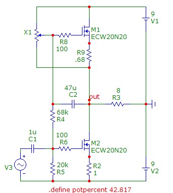

6W, Class A, hopefully something I can build. :D
Emitter resistors are necessary in the real world as they help in current sharing between paralleled transistors - remember real parts are not perfectly equal in their parameters (especially beta or VGS) ;) This is one of the points not seen in simulation.
Another point is that simulation regularly predicts unrealistic results. That's due to insufficient models and often also due to incorrect simulation. Just simulate a known amp (where you have all specs and plots) and compare. You will be surprised.
In any case, at these low levels of THD also construction details as pcb-layout, wiring, position of the toroid and more become decisive wether you reach your goal or not.
Do not keep your eye so close to the simulator, build and measure the beast. :D
Have fun, Hannes
PS: if you want real fun, measure THD while moving the wiring in the amp.

Well, I got some small heatsinks out of the monitor and will breadboard a small prototype in a minute with no parallel outputs. Let's hope the smoke stays inside. :D

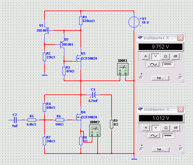

I am struggling with this Single End MOSFET Class A.
It is kinda ZEN but uses one current source at 1 Ampere.
Output devices are N-Channel.
Only four transistors: 2 x 2N5401 and 2 x Exicon ECF20N20
Think two Exicon ECF10N20 will work just as well.
At 18 VDC, 1 Ampere = 18 Watt,
it can produce 2, maybe 2.5 Watt RMS with acceptable dist.
Mainly 2nd and 3rd harmonics. The higher orders will fall off nicely.
It is not :) easy to balance gain, bias and operation voltage
to make this amplifier optimal.
But it is a nice project and fairly low idle powers.
Lineup

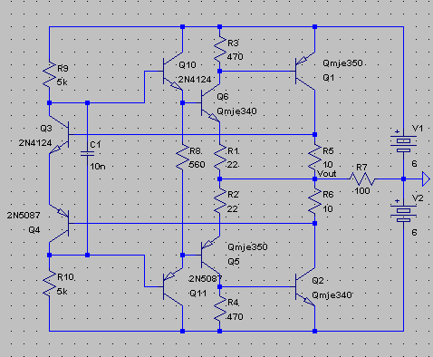

Okay, I finally have the output stage working. Didn't have much time to work on it, but he output stage is working now.
Attached file is the components I used.
The circuit oscillates if I attach anything between the emitter of Q3 and Q4.
I will go ahead and build the input and feedback parts of the circuit to see if I can get it so I can listen to it.

Q5 & Q6 are operating Iq~1.3mA that seems very low for 340/350 transistors.
I do believe that the two bias controlling transistors cannot work. I reckon that as soon as an emitter current changes, the transistor pair send corrections to the outputs and that your oscillation.
