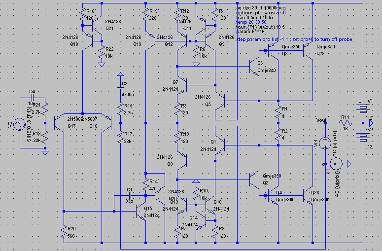

6W, Class A, hopefully something I can build. :D

Anyways, Recently I've found that the CFP has a special trick when it comes to frequency compensation. Doing this, you can adjust OLG without loading the LTP so much at high frequencies.
My heatsink now has a good fan to keep it cool. True class A. :)
- keantoken

For the most part you are right - I could get something done before Christmas if I wanted to. I would rather screw around and blow a few fuses, thank you.
What I like about the Allison multiplier is that it is immune to thermal blowout - good for me because I don't want to screw around with thermal coupling quite yet. It's safe and should be workable.
The biggest problem is that I have no good reference to gauge how good this thing REALLY sounds. So while I will comment on the sound, it's actually hard to compare with what all else is in my house. Also, I can't manage to get the input right. I have an input impedance of around 37kohms, grounding is sub optimal (but there's no grounded outlet in my house anyways). The speaker enclosure is also nowhere near optimal, as I am using the hollow bottom of my mother's "great poets award (famous poets society)" silver cup. :)
Everything works fine with my portable CD player, since it's not grounded, but when I hook it up to my computer there is HF ringing (44.1KHz?) and pops and ticks while playing.
The only comparison I've made that I trust is that the treble is better than with anything else I have in the house. Other than that, I think my reference speaker is suspect - and it outperforms all other available junk by far.
- keantoken

Another advance!
I just completely rewired the LTP and VAS section.
Before I got extreme ear fatigue after prolonged listening. Much better! Before I was questioning my speakers, now I know that there was something wrong with my amp.
I changed the LTP devices to 2N5087's, and adjusted the CFP a little. It is oscillating very slightly, but not badly.
Now it sounds much clearer. I feel as if I've accomplished something! :eek:
Now it beats everything in my house, which is what I was aiming for.
Now it needs to get louder. I haven't been running it at full volume because some kind of glitch occurs at about -4V. I believe this can be remedied with some diodes to increase the C-B voltage on the Allison pair. However this will decrease the maximum output voltage. Things have gotten tight with the 12V rails...
EDIT: Nope, Allison glitching wasn't the problem. Bias current was too low. Nwo I have higher bias current, and it works up to around 20Vpk-pk output. It doesn't seems to be glitching or anything at that volume, so everything must be okay.
- keantoken
