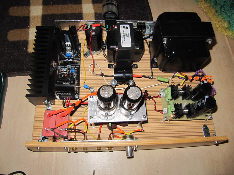

6V6 line preamp
fired it up .......
58ma stable, B+ at start was 335V soon to drop to 240V ....
dc offset was strange , both channels werent stable, one measured between 20-22mV and the other 76-80mV ... changing all the time ...
output cap leaking ? oscillation ?
at least no boom kaboom , no smokes ... :rolleyes:
output cap similar to this one only 2uf (http://www.ebay.com/itm/MBGP-2-Pape...526&pid=100011&prg=1005&rk=1&sd=250906640986&)
