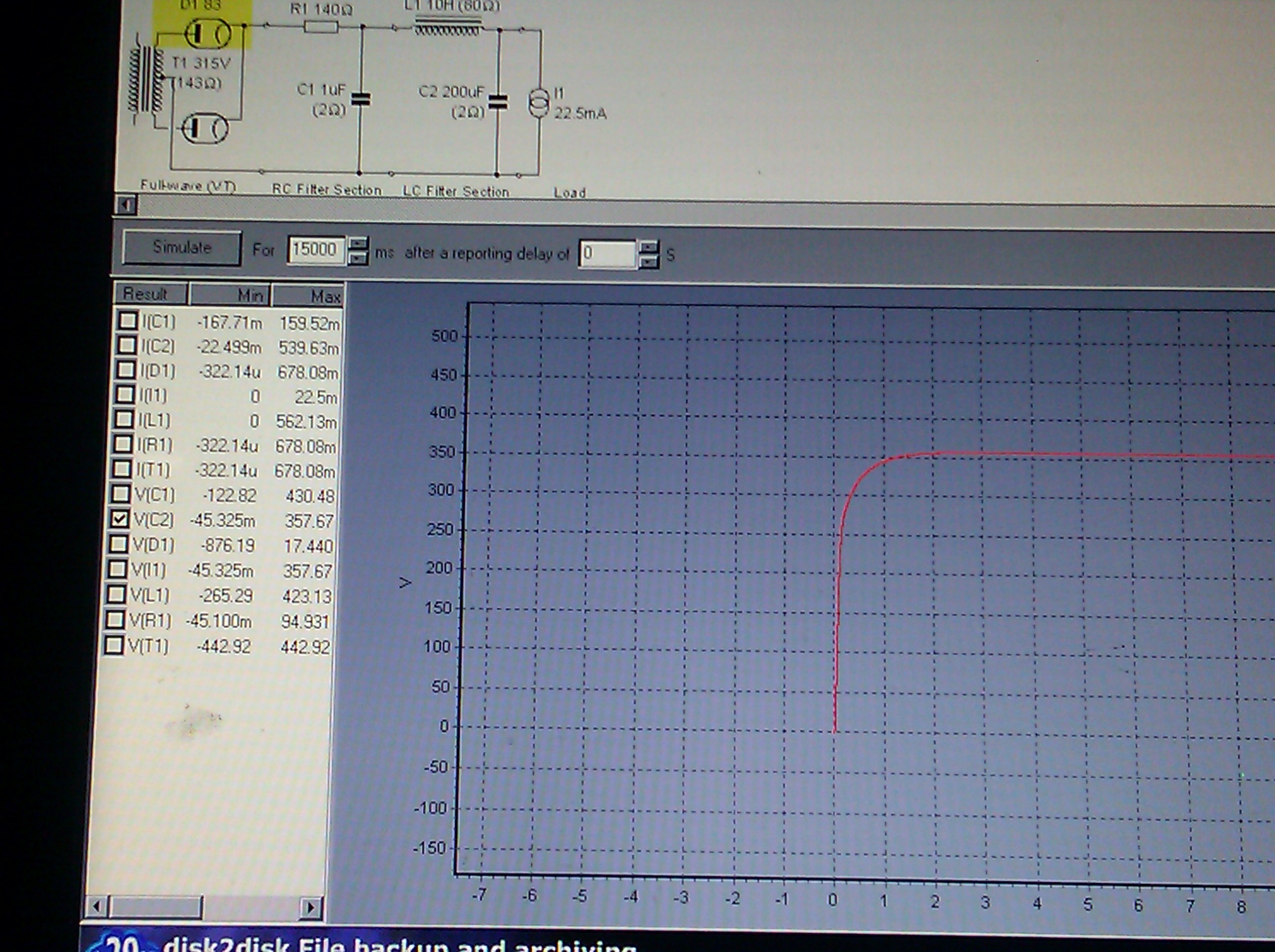

I wish everyone a Good day. My name is zach, I am new to the forum and this is my first post. I am new to diy and electronics but have built a couple tube amps from kits before and now I feel confident enough to build salas 6v6 from scratch. I have most parts to complete the preamp and have procured the power supply components to be used. I'd like to make a separate supply for each channel hence i bought 2 power transformer and 2 supply chokes. As i feel the preamp is worth the effort and cost. I modeled the power supply at PSUD designer but do not know how to attach the simulation results. this is what i did.
this is only for 1 channel!
power transformer is a hammond 272fx- 600vct@ 173ma with sec. dcr of 143ohm and hammond 193j- 10H@200ma with dcr 82 ohm. rectifier will be type 83MV.
thank you!

hi!
what is the total current draw of the circuit including 2 salas regulator? thanks
I believe it is about 44ma for both channel! i haven't built the salas high voltage regulator yet, but i don't think it needs to be accounted for when summing up the the current draw of the circuit. Im basing this only from my limited understanding( I really don't know anything) and I might be wrong., So we need the inputs of those who know.
