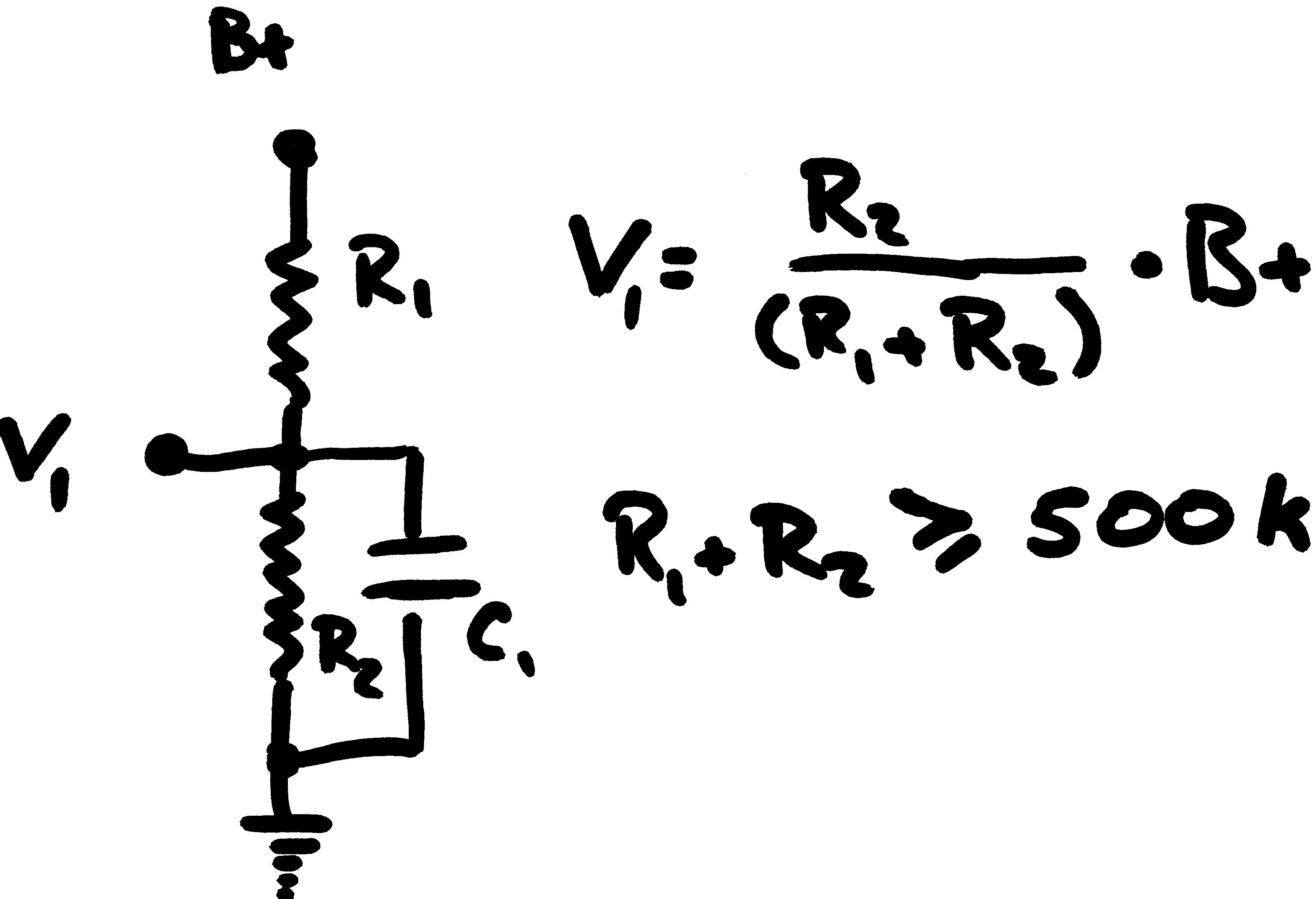

To lift the heater it is a simple, a relativly high impedance voltage divider. If you know your B+ voltage then calculate the value of the divider to get the proper voltage. You will also need to bypass the lower resistor to ground with caps. I used a 1uF poly and a 47uF electrolytic 50V I had out of my parts box. I will see if I can draw a quick schematic later and post if someone doesn't have it handy. Pretty common approach
Voltage divider for lifting heaters
Here is what I use for lifting heaters. Lots of opinion and theories as to what voltage to lift heater to. I try to keep it simple.
For me: Rule number one. Make sure that the heater to cathode voltage is within spec. Then, if feasible, select a voltage to get the heater above the operating cathode voltage slightly.

Yes. V1 is the "new ground" for the heater circuit. I just tie one leg of the heater trany out to it. In my case I rarely use the PT heater windings and opt for a seperate heater tranny. But this works in any case.

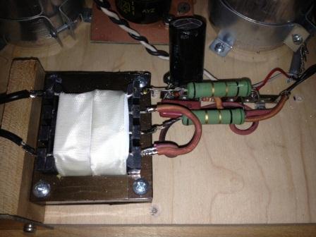

Attached photo is of complete heater supply including voltage drop resistors for 6.1V and Voltage divider for lift. You can see the caps and smaller resistors buried underneath Vdrop resistors
