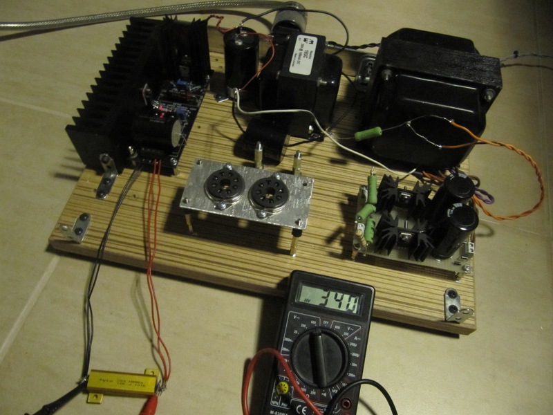

hope i got it this time ...

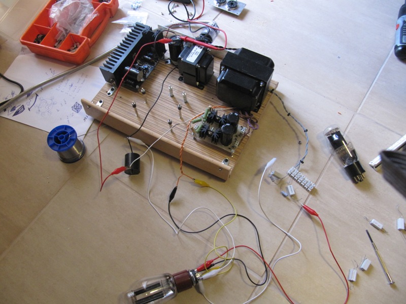

tried ss rectifier, IN4007 and a 100Ohm in series before c1, measured 440VDC with no load ...
tested SSHV2 ...
didnt have 8.5Κ dummy load, closest was 7.6K (series 4.7/2.2/0.68) ...
R4 was set to give stable 40mA, but with R11 fully turned I measured 291V across dummy load ...
will try later with 44mA to see if I get 340V across dummy (that is if I done the math correctly :rolleyes:) ...
the whole thing lasted about 5 minutes ... 2540 heatsink run quite hot, 840 heatsink was cold ...
