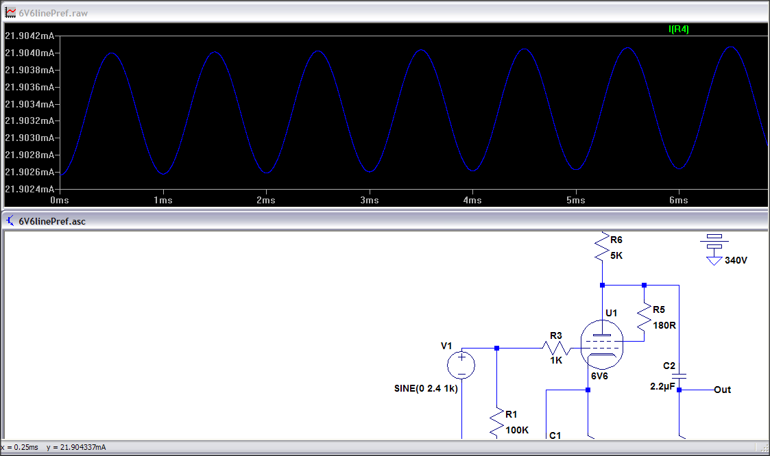

Thanks for simulating, although I don't know how to interpret this graph.
Nice to see reality conforms to your calculations.
I used Russian 6v6, measurements:
Ibias 30 mA
vK 16,2 V
V plate 255 V.
Ra is 50 W vishay non-inductive audiograde blablabla so it should be OK.
I tested with input signals +/- 1,5 and 9 V (batteries), with 1,5 output was symmetrical, with 9 V something like 2% difference between pos and neg, but who needs 50 V preamp output..
Could you please do a simulation with R load DC 22k and AC 7K? (Parallel Ra 22k and Rload pot10k)

Gives 20dB gain with 10K pot across input, same THD. The FFT I showed is a prediction of THD with 100K pot at max and input 3V peak to peak sinewave. 10K pot is rather too low IMHO. Do you need 20dB line gain? A 50K log pot would be smoother controlling I guess.

With 10K to ground after the output capacitor the gain is 18dB but THD is about 16dB worse than having the same pot on input, so I suggest you move it to the front as in the original design.

Yes it is designed for 22mA. But it has been seen hitting higher, depends on tube brand and vintage a bit also. Merry Xmas!:hohoho:
