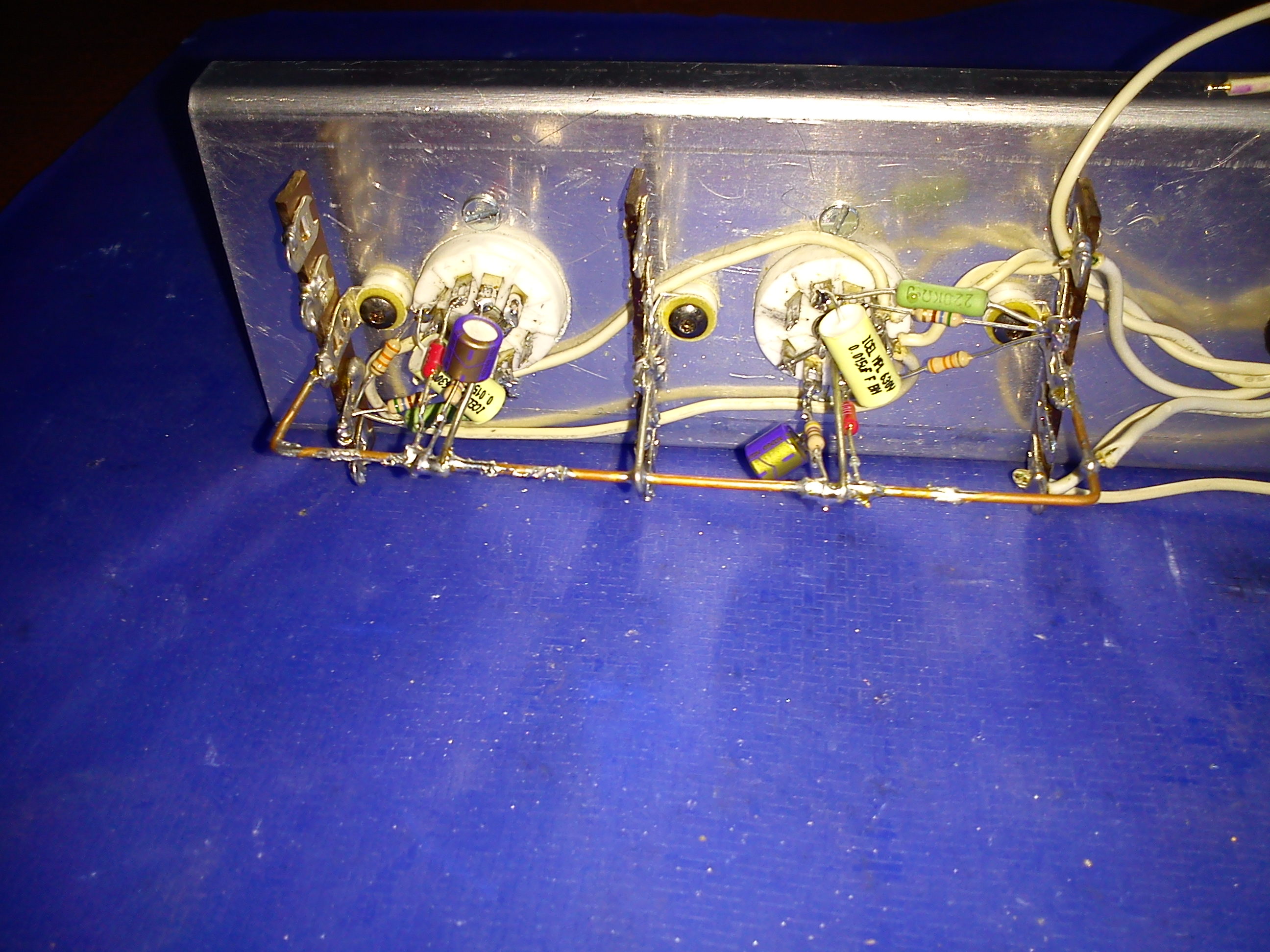

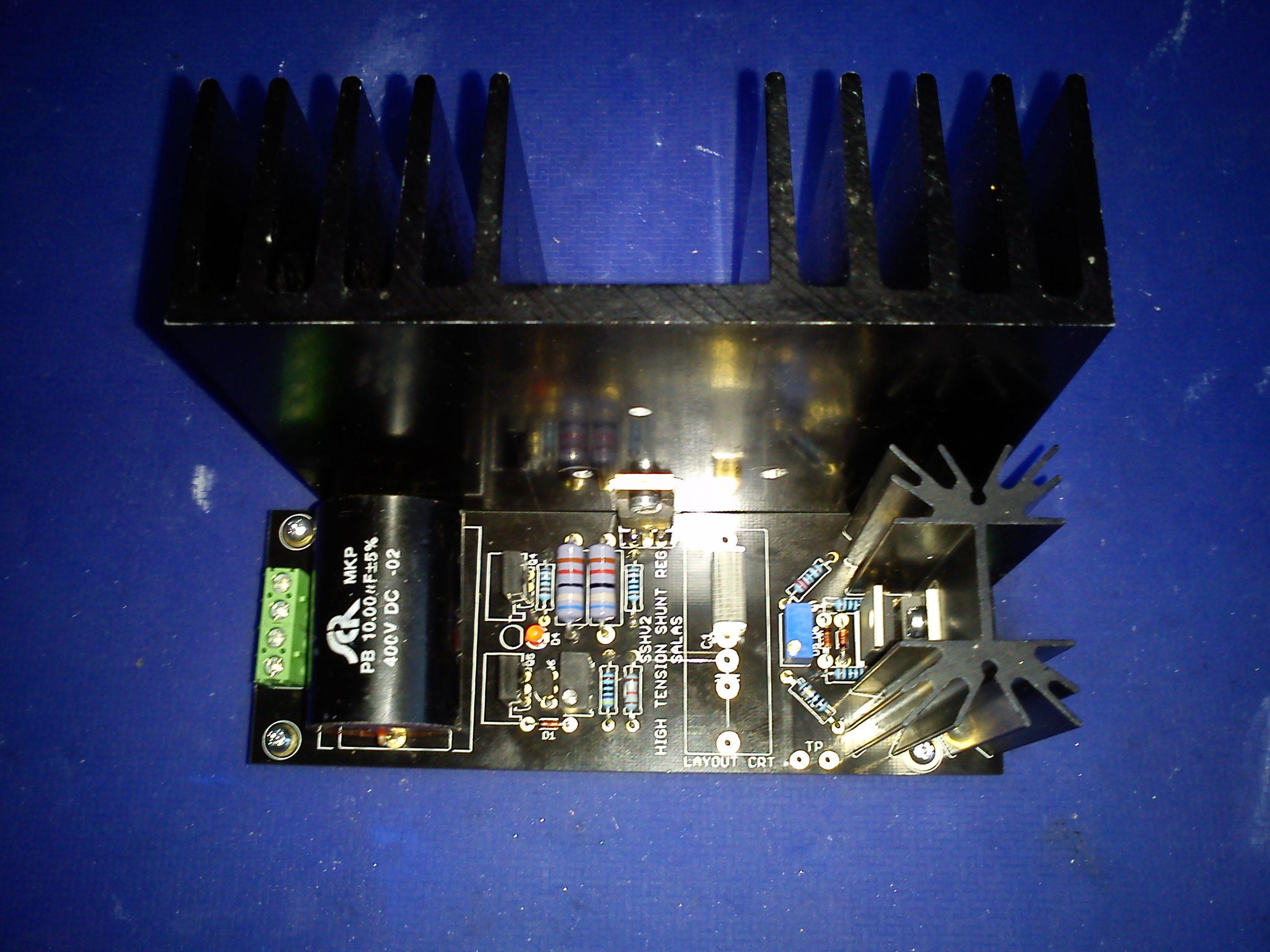

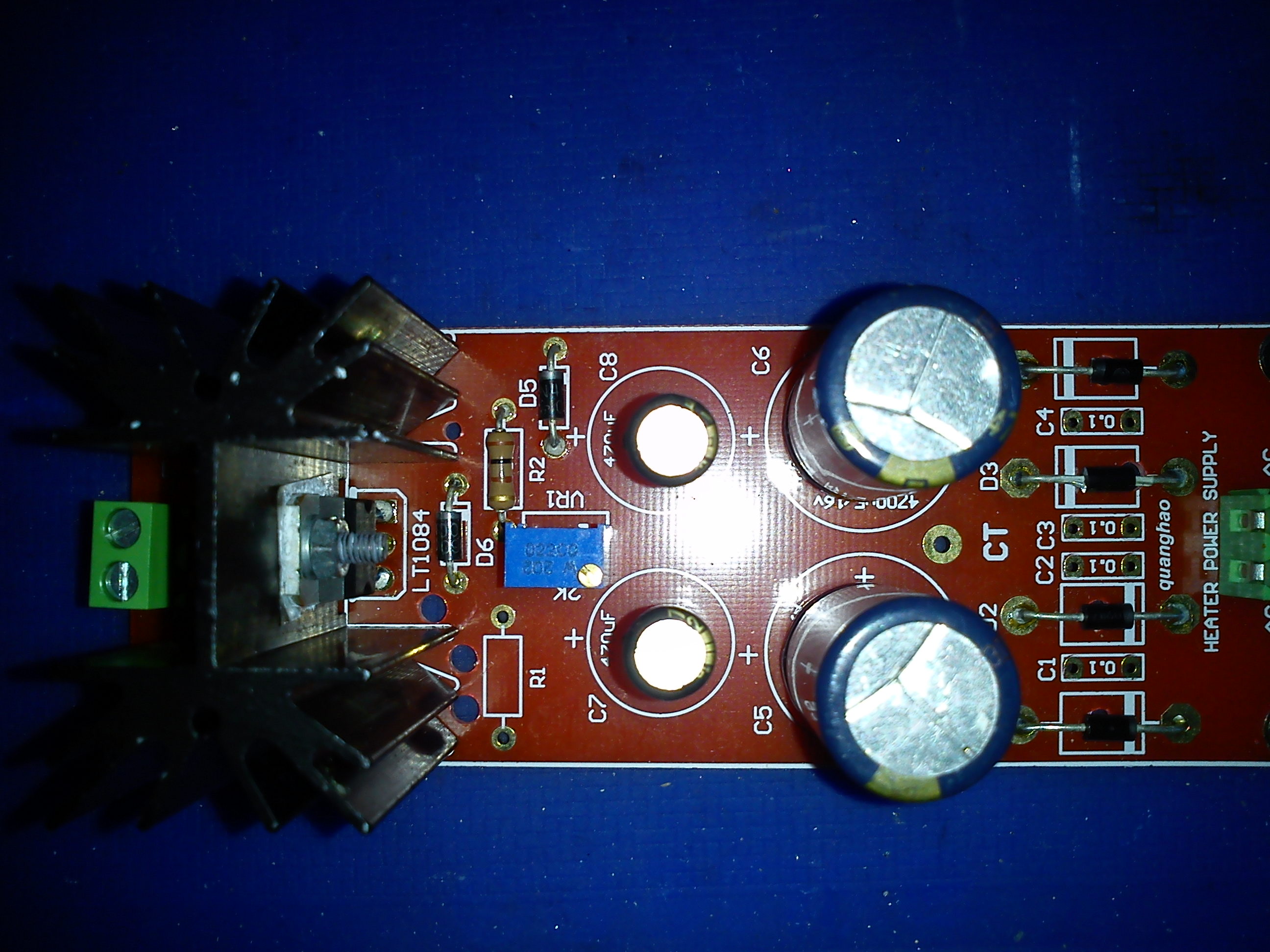

Started 1st proto with Mu-Follower due to the fact is more easy to make, the heaters of two valves in paralel with 6.3V? how much current draws to calculate the dummy load for the Salas HV shunt regulator? Attached several pics just for fun.
It's enough the heaters with 6.3V? How have to do to elevate the heaters to 100V?
Depends which tube you use. If it is an ECC81/2/3/8 it will be 2 x 0.3 amps at 6.3V = 0.6amps. If it is a 6CG7 it is 2 x 0.6 amps = 1.2 amps.
In an SRPP or mu follower the heaters usually need to be elevated. How high they need to be elevated depends on the circuit, the tube and the power supply. For most mu followers and most tubes 75V elevation is sufficient. A simple potential divider across the HT will be all that is needed with the lower arm decoupled by a 47uF capacitor. A potential divider consisting of 75K upper and 33K lower arms will work with a 250V supply.
Note that a regular 6DJ8 or ECC88 has a maximum plate voltage specification of 130 volts so your HT supply should not exceed 250V. I generally prefer to use a 6922 instead which has a maximum plate voltage specification in excess of 220V.

ECC81 exactly as the pic:
Could you draw the heater elevated schematic.
Thanks in advance for kind help.
Felipe
