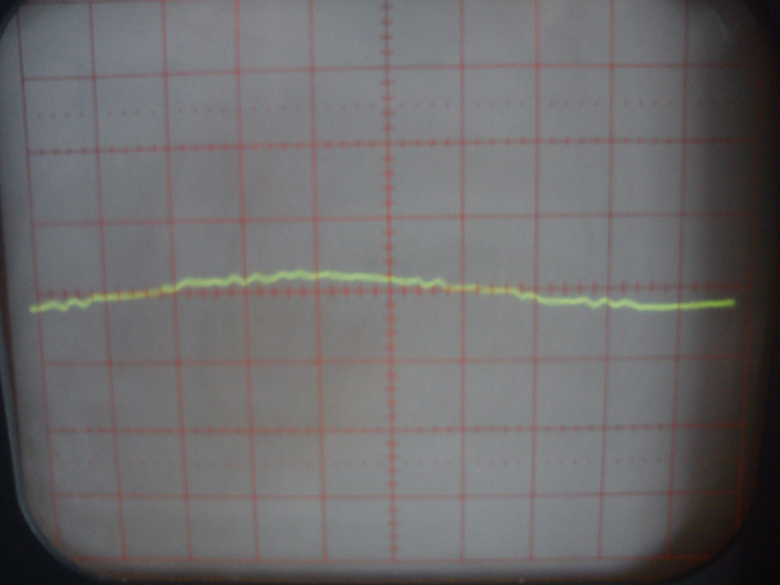

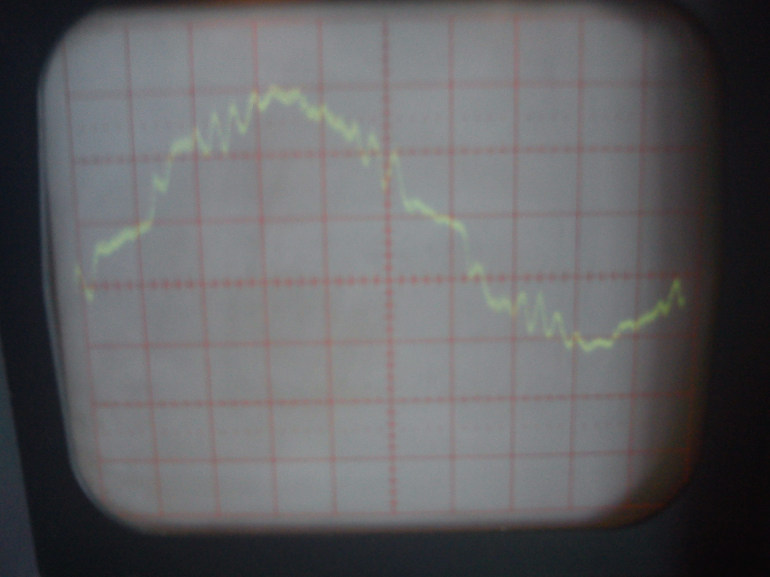

Connected the preamp but sounded wrong and woofers like having DC also it was smelling to burned so I disconnected.
New measurements:
B+ 280V in both anode channels
I have tube left channel:
between upper cathode pin 3 & 560R = 169.5V
between 560R & 33K = 130V
between 33k/15nF anode pin 6 = 47V
I have tube right channel:
between upper cathode pin 3 & 560R = 173.2V
between 560R & 33K = 167V
between 33k/15nF anode pin 6 = 27V
Pic with big sinu. is right channel small sinu. is left channel both aren't with the same scope settings, scope setting are to see the best sinu. possible.

Oooops forgot to connect the GND signal to GND chassis now the measurements are:
between upper cathode pin 3 & 560R = 170V
between 560R & 33K = 165.8V
between 33k/15nF anode pin 6 = 96.2V
between upper cathode pin 3 & 560R = 174V
between 560R & 33K = 169.8V
between 33k/15nF anode pin 6 = 102.1V
I have in both channels a nice sinu.
