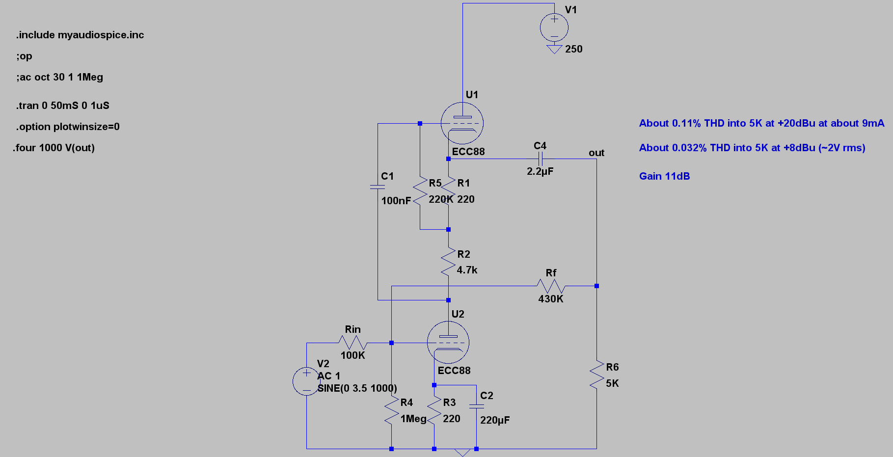

6DJ8/ECC88-SRPP Tube Preamplifier
Is this?
You're both right.
This is a Mu-follower circuit, from which you can tap off
a standard gain-stage at the anode, or
a signal off the top of the high cathode for "Mu-stage" behaviour.
The stage topology stays the same, but the interstage hook-up
changes the quality of the output and its 'Mu-havior'. ( <-- Just coined by Nazaroo!)
In simplified terms:
= this:
On the other hand, this,....
equals this:
images
Is everything clear?
You're both right.
Coin it -- Define it
Have you added something new to the thinking?

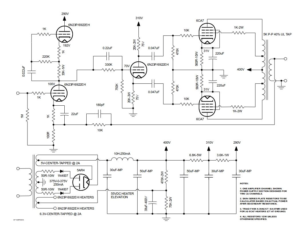

I used that circuit for my 6CA7 PP amp. Taking the output from the lower triode to drive a cathodyne inverter. Sounds excellent.
Yes: Here's what stays the same, and may arguably be the most important points:
(1) The PSRR remains awesome.
(2) The signal is hardly affected by the altered loading, if you're smart, and reproduction of original program material remains accurate.
The Mu-stage may not be being used as intended, but it remains a great audio stage.
You guys are splitting fine red hairs (we need a photo). That circuit (mu-Follower) was used in low noise radio receivers and wide band pulse amplifiers in the Manhattan Project long before it was coined the mu-Follower.
There is plate output where the output is taken between the plate resistor and the plate. There is cathode output is taken between the cathode and the cathode resistor. Along came a tube CCS in place of the plate resistor. Throw in a couple of resistors or not between the top triode and the bottom voltage amplifier (remember that the top tube has a plate resistance think of it as just another resistor between the tubes). Now that there are two tubes in series is it plate output or is it cathode output, or some degree of tween depending on where the output is placed.
Explain Mu-behavior as the circuit existed before the name?
DT
That circuit, or the cascode? A mu-follower might not work too well in a wideband amplifier as it maximises the effects of both anode stray capacitance and Miller capacitance.
