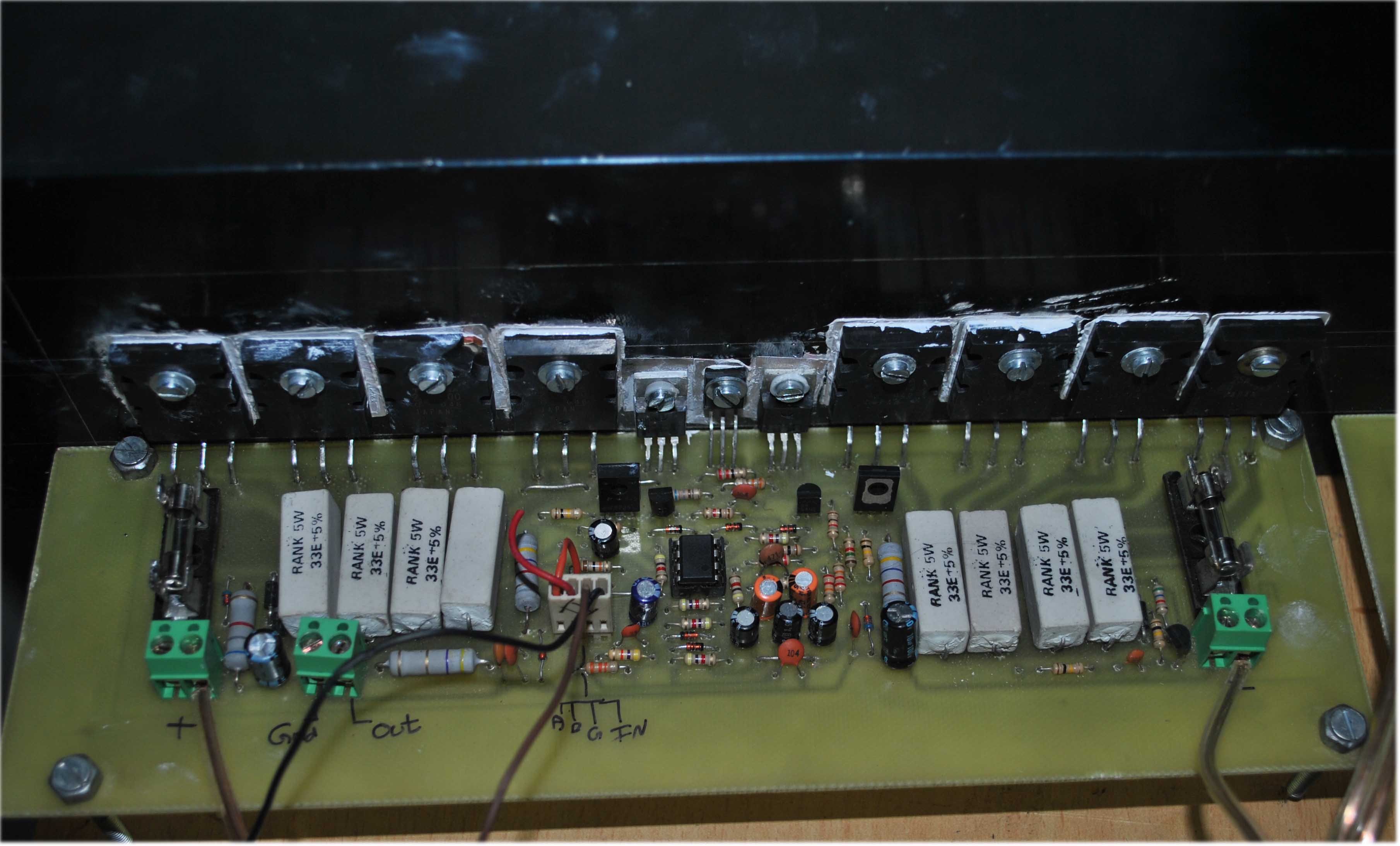

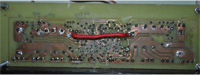

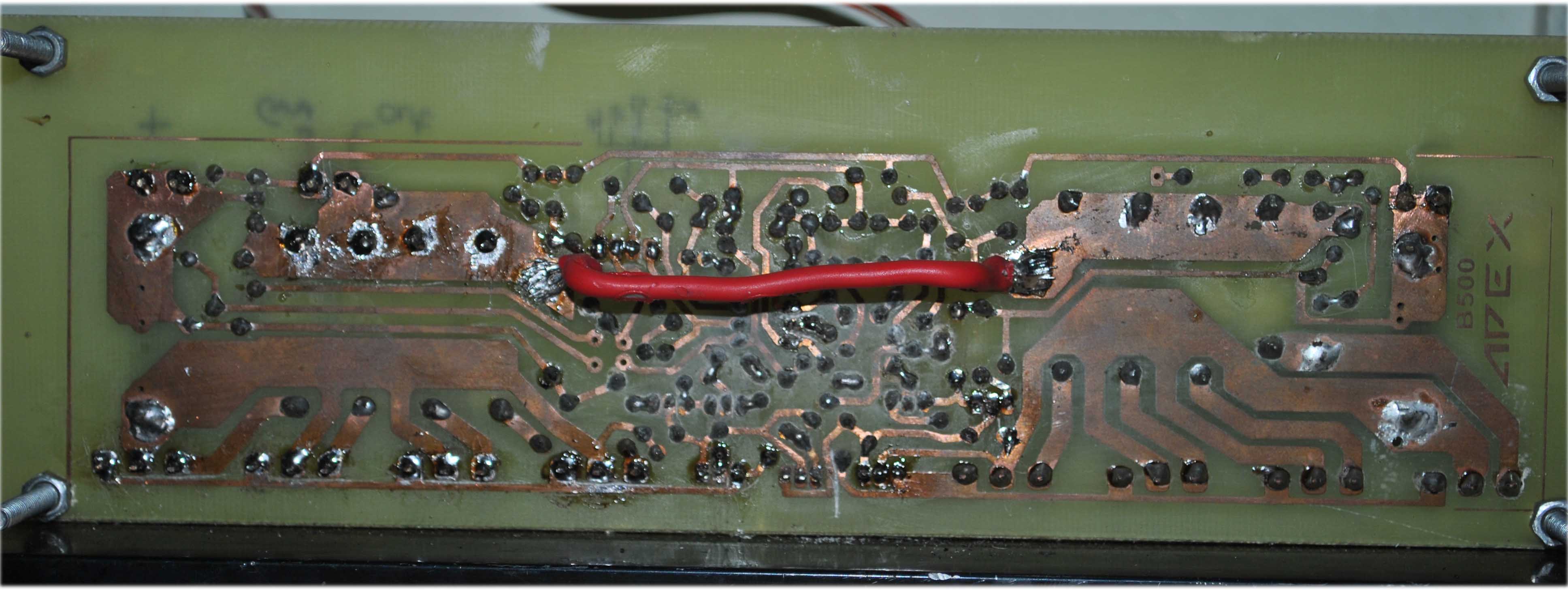

Hello,
I completed one channel of B500 Today,
Psu 37-0-37 3 Amperes.
Dc at out is 35mv.
The sound is very low, and very distorted.
I made connections as shown by mile.
Kindly Guide.
