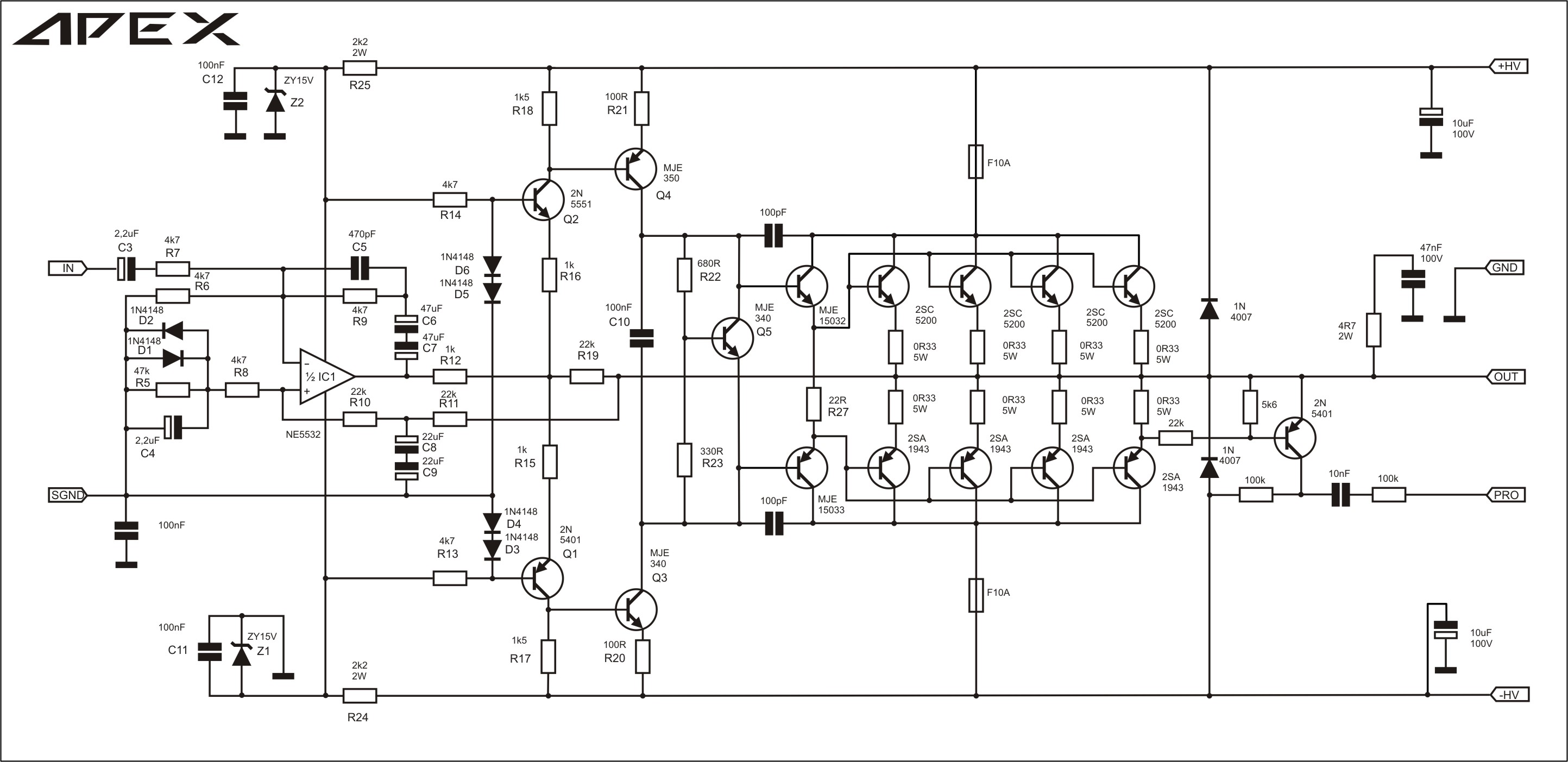

Hi Jon2xflash,
4558 can be used instead of 5532 as I'm also using the 4558 on my B500 amps.
Attached herewith is the B500 amp circuit without limiter.

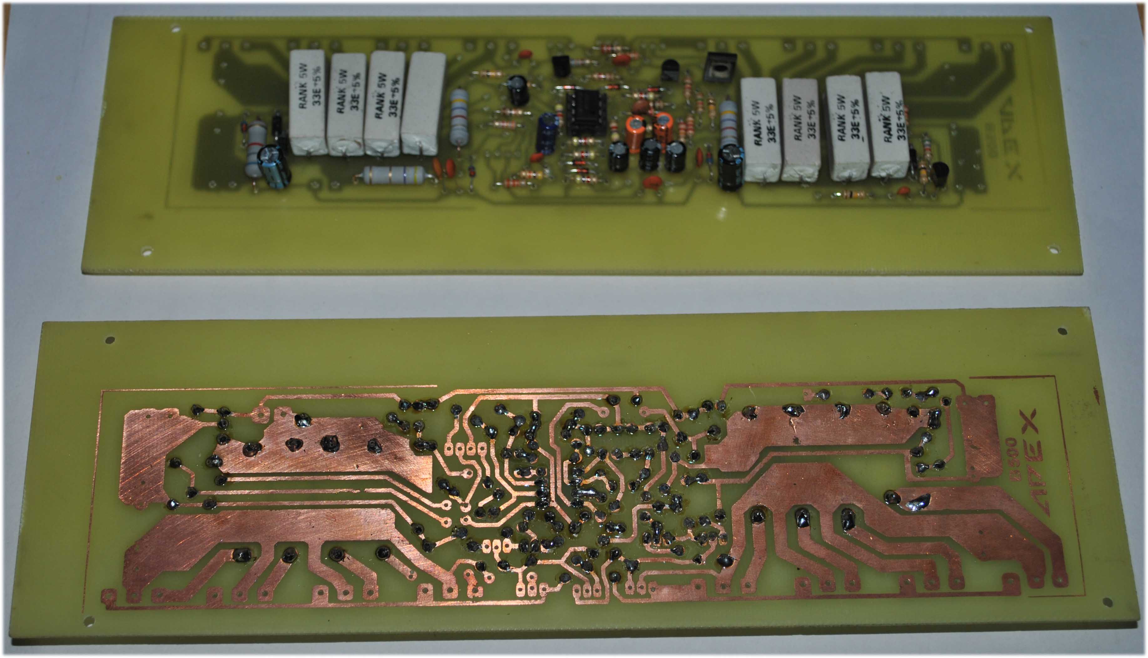

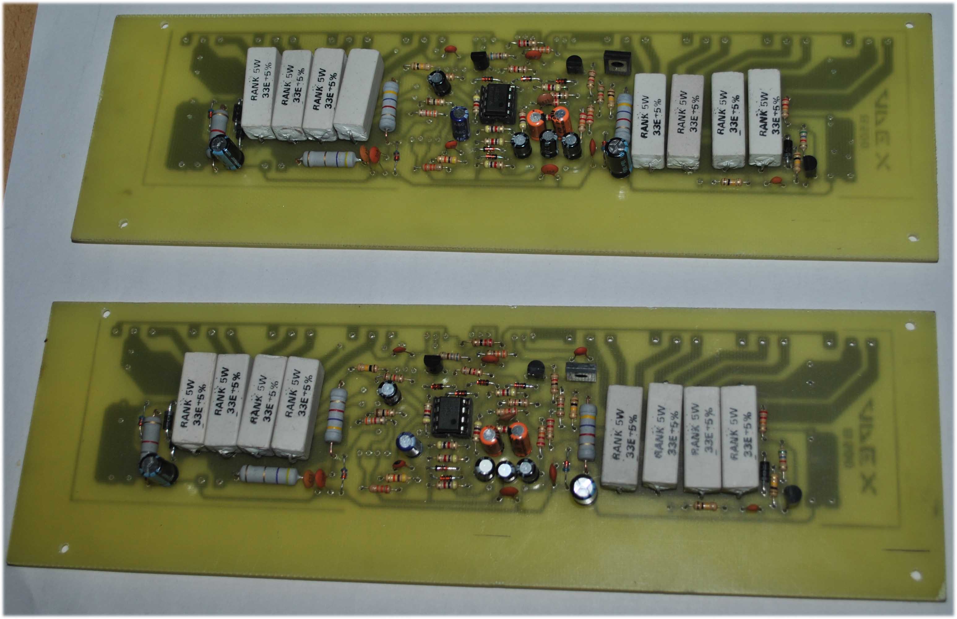

Hello,
I have assembled most of the parts for B-500. Transistors yet to be soldered.
I will be using Regulated Psu giving 75-0-75 dc, and 4-10,000 mfd capacitors, Do i need to make any changes.
Currently i am having 37-0-37 5 amps transformer, Can i use this to test the amp.
The heat sink is 15" long height 105mm and fins length 44mm, I suppose this should be enough.
Will kse350 work in place of mje350.
I am assembling a amp for first time without any help, So tell me how to set bias for the transistors. And what initial steps to take for testing the amp.
I am not getting relay for protect, can i get any photo of the sample or link where to buy it in India, is it fine if i connect the speakers without protect.
hoping for the big miracle.
Thank You:):)
