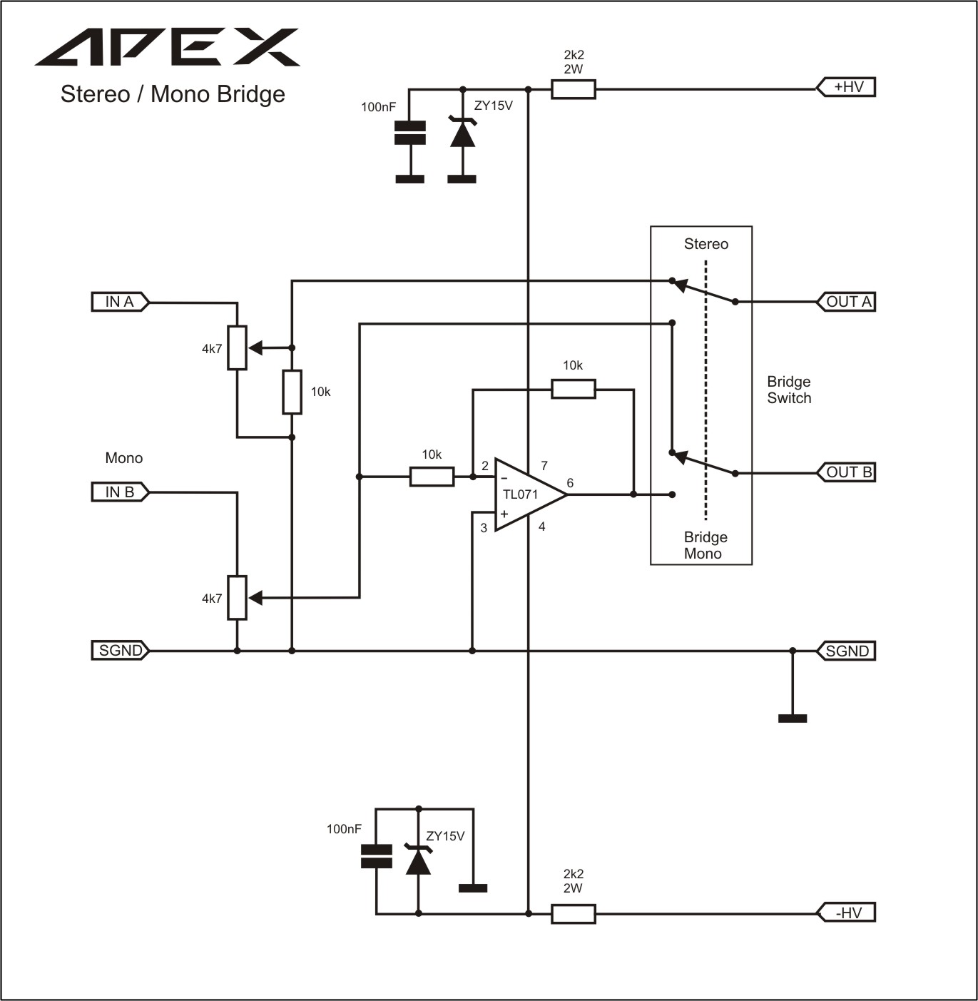

Use 1k/2W instead 2k2/2W for R24 and R25.
how many watts of output?Use 1k/2W instead 2k2/2W for R24 and R25.
in the pcb there is r24 and r25 4.7k/2w resistor why is that.
4k7/2W is only for test with +/-90V rail.

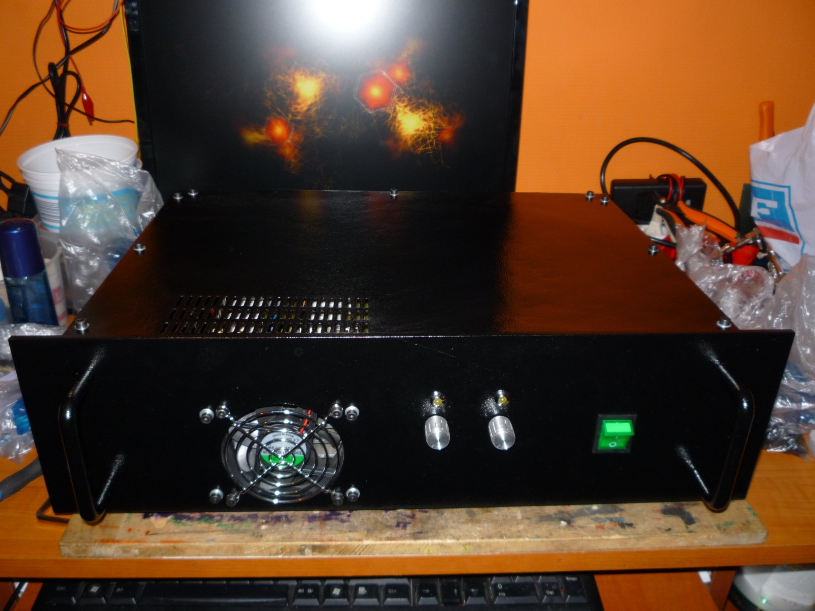

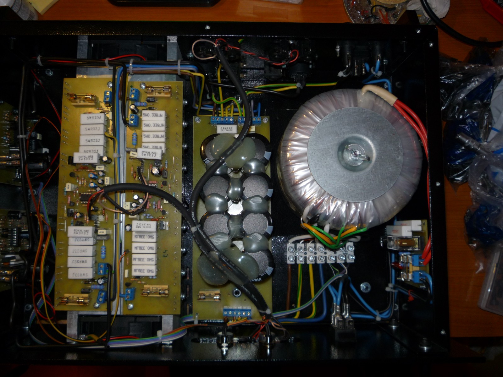

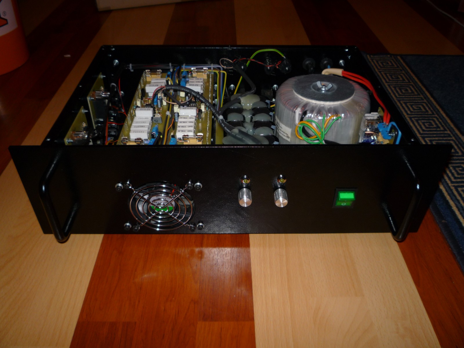

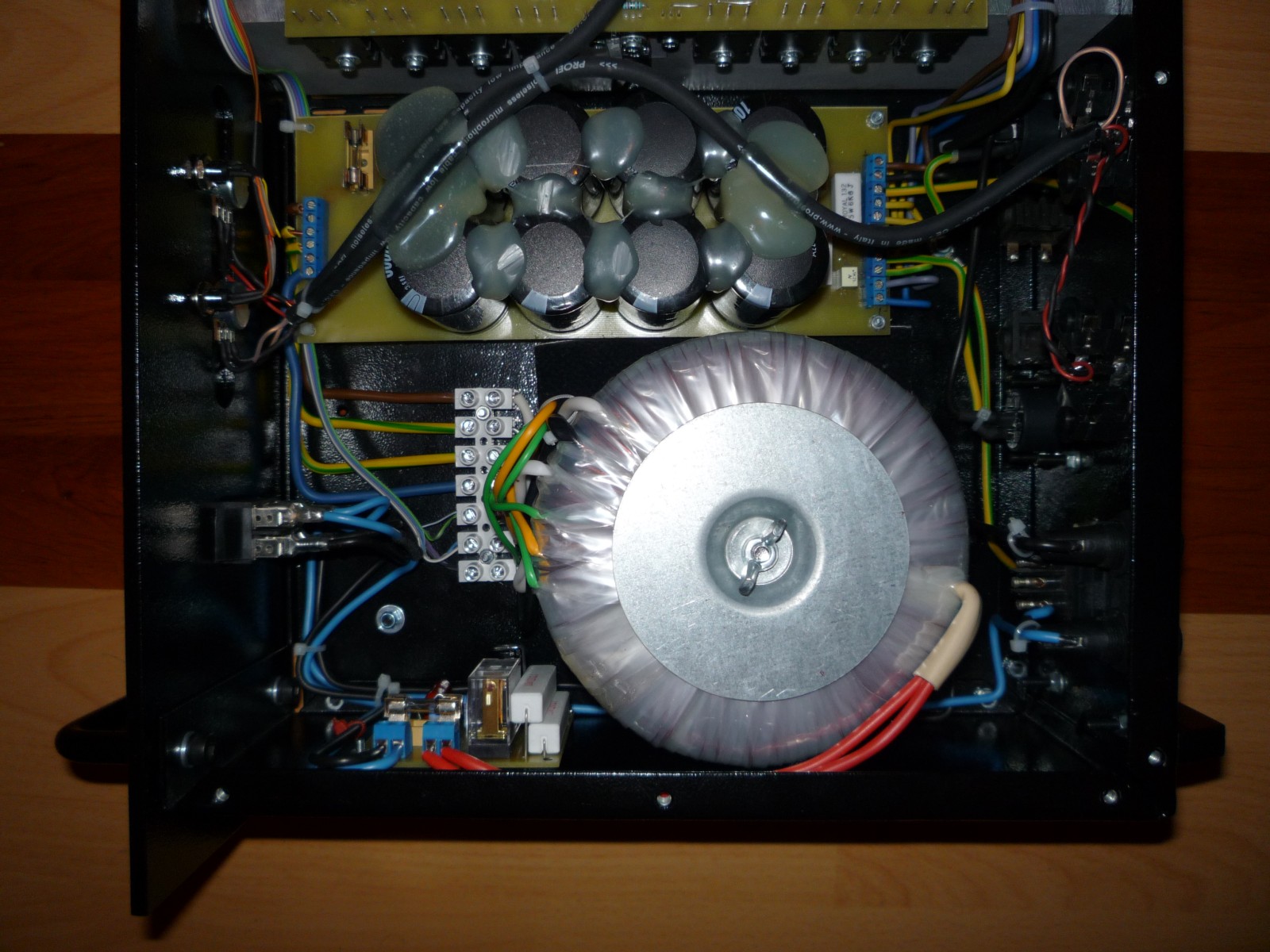

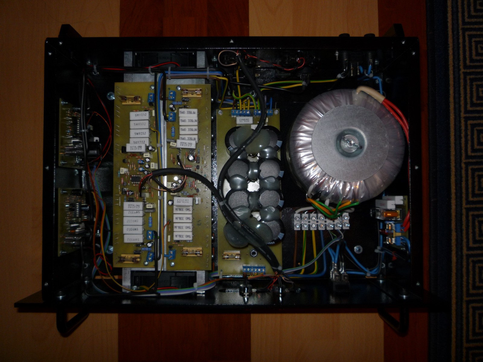

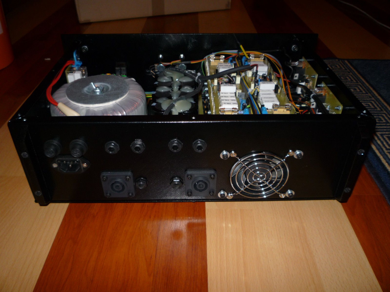

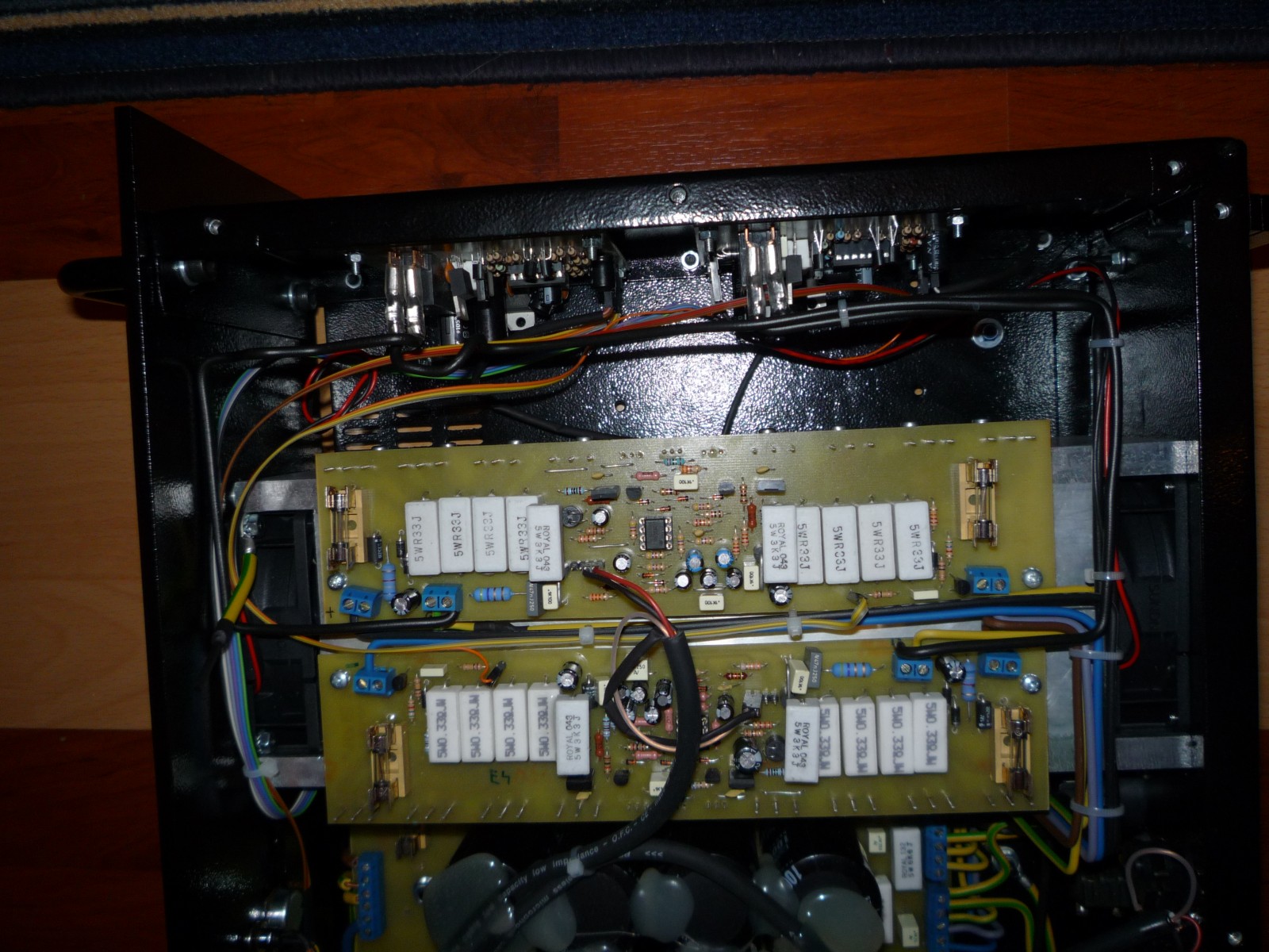

Thank you, next time i post the pictures of the completed amplifier.
