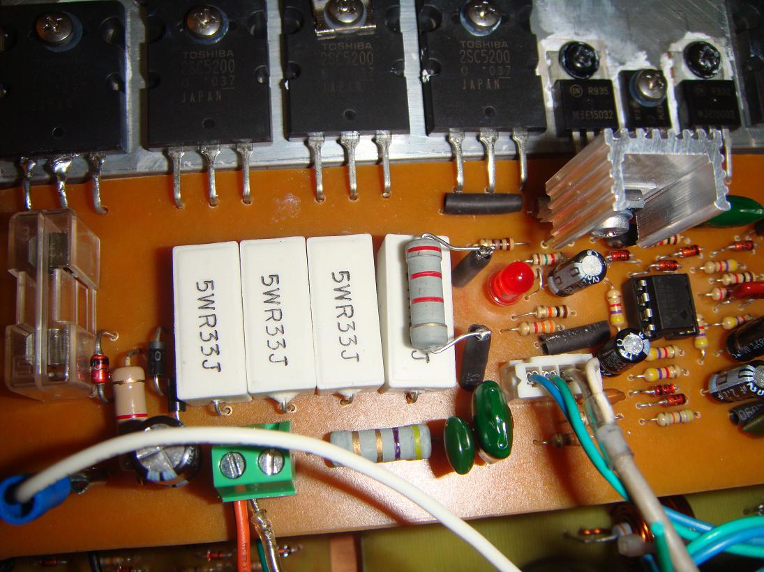

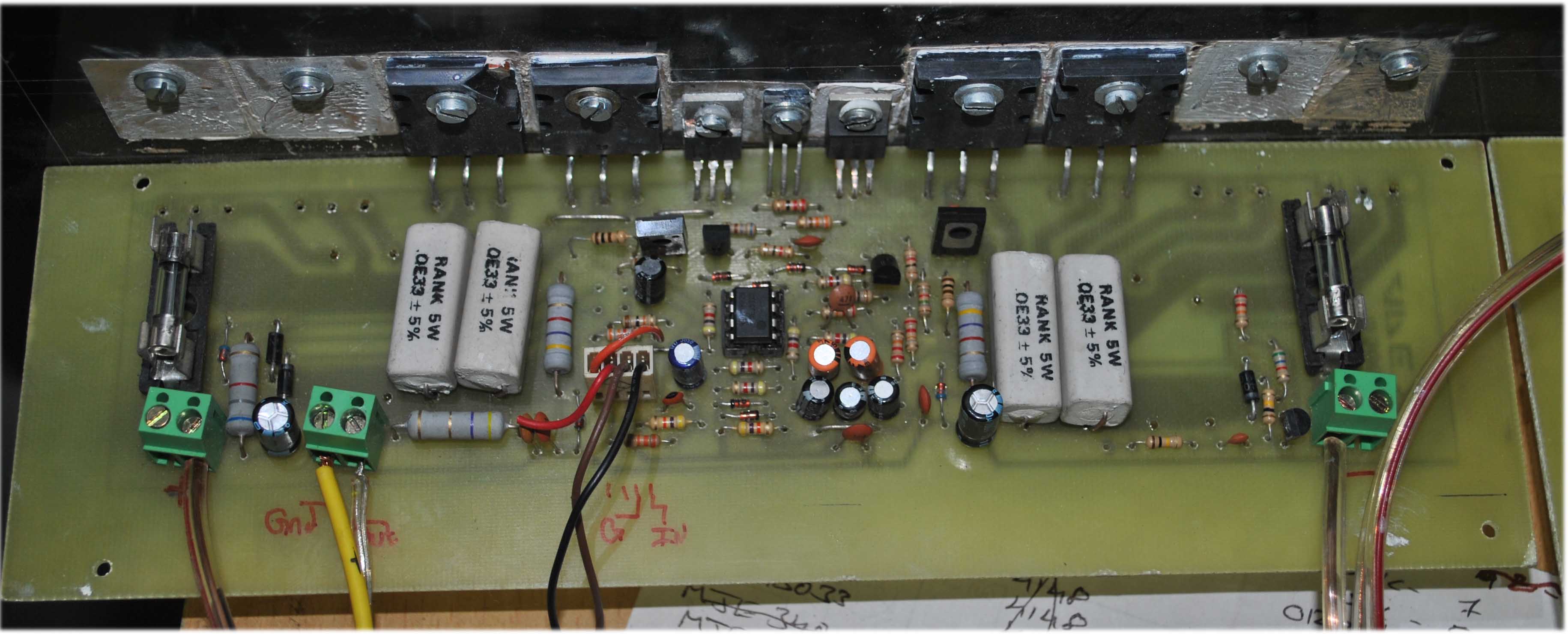

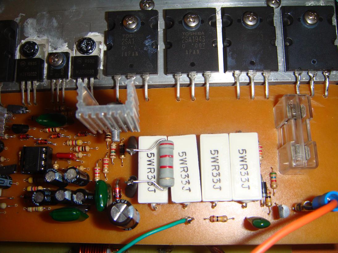

i changed the resistors to 0.33 still no sound. no activity at out.
please help, anyone? r20 and r21 getting burned

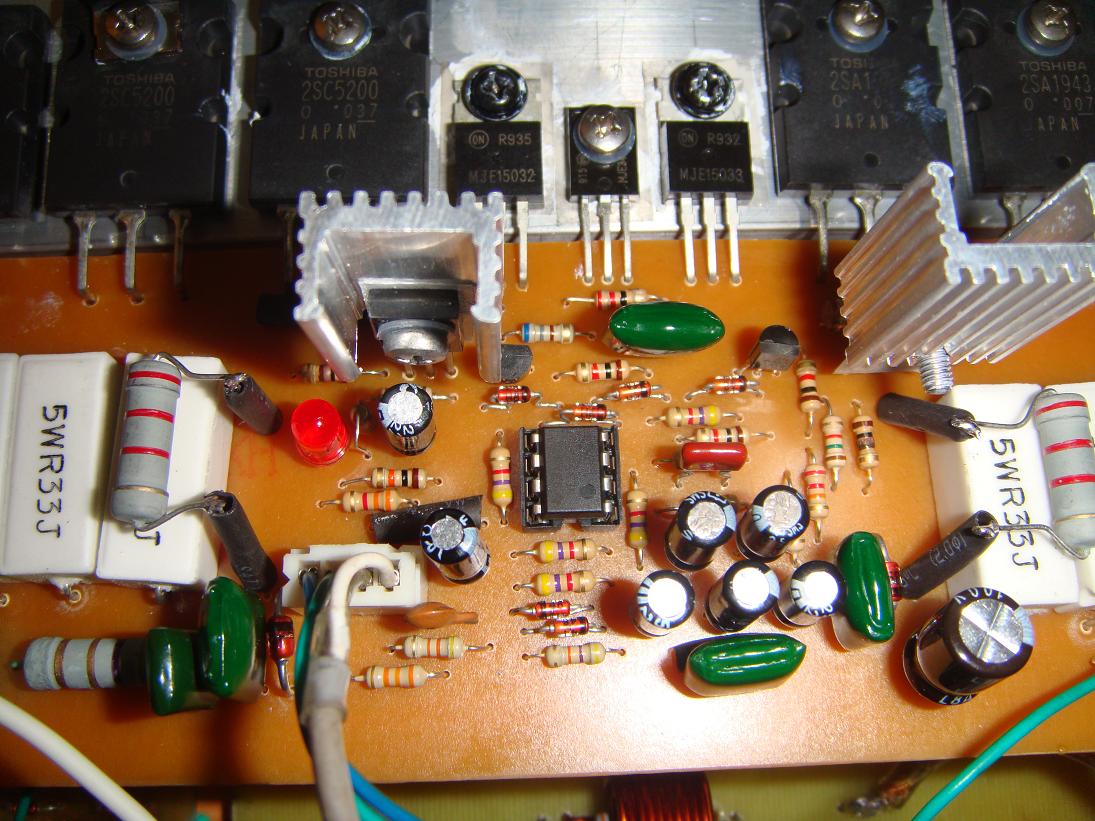

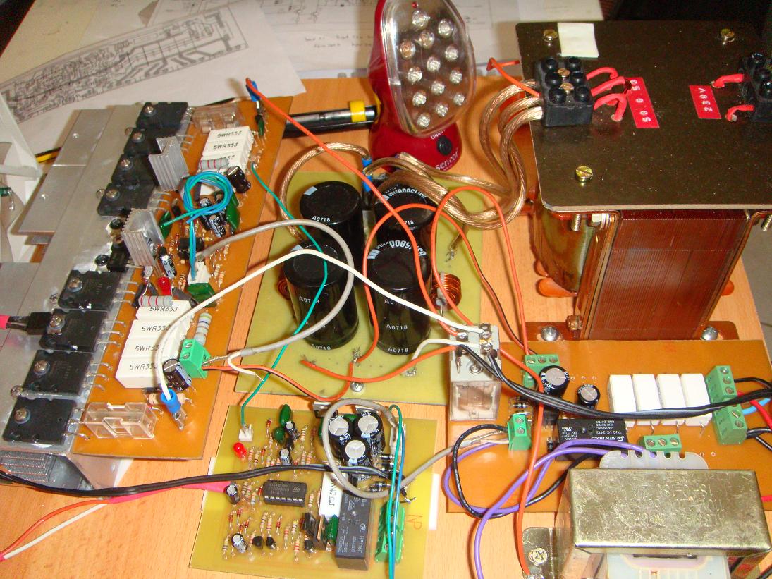

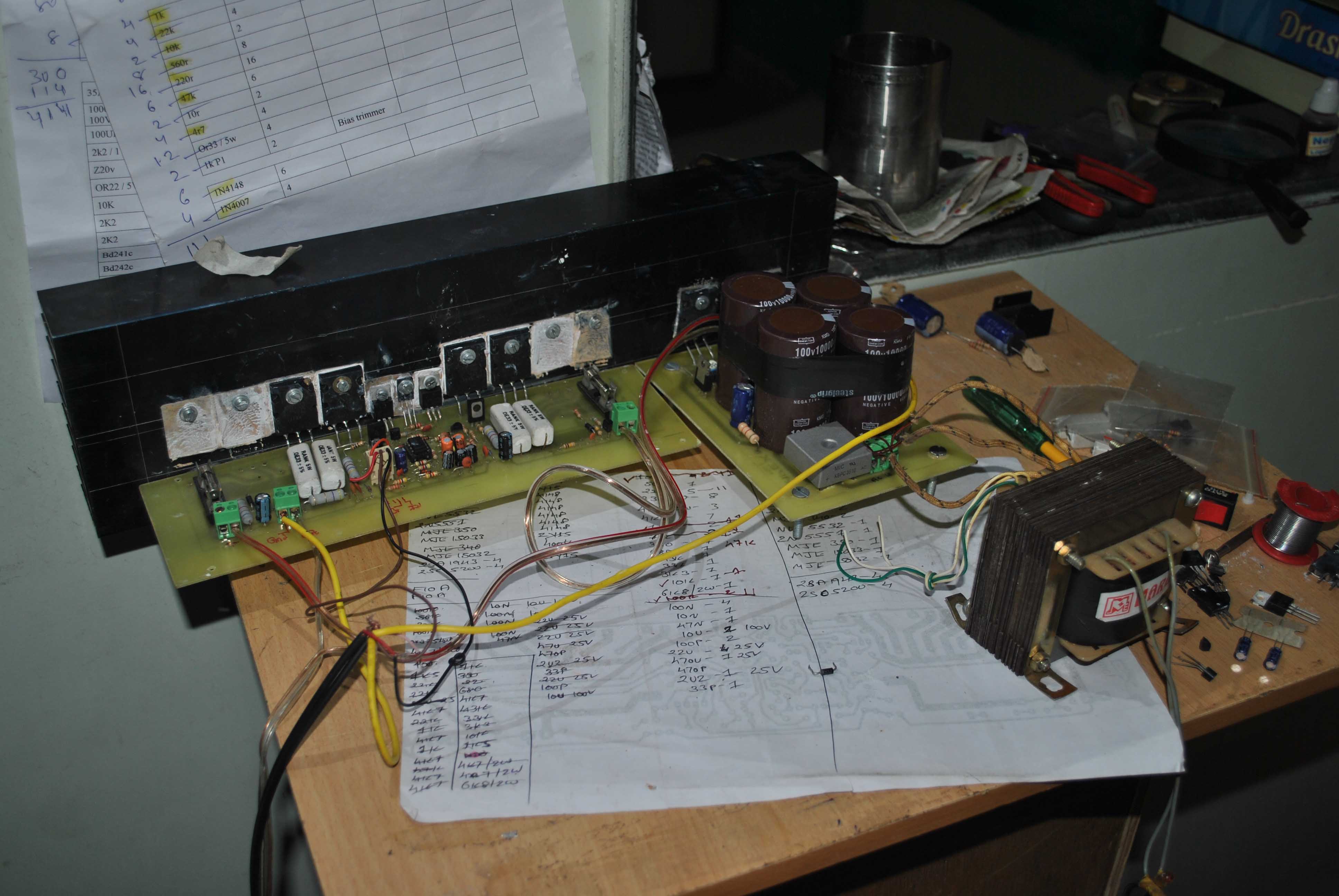

Sir Apex, I have a problem with this B500, as soon as I switch on the circuit, the 100R resistor (R20,R21) is getting burned:
this are the specs of the circuit taken from the forum and schematics:
psu: +/- 68Vdc
transistors: 1943&5200, mje340/350,2n5401,2n5551, zeners 15Volts 1 watt, R24/25 2.2K 2watts. I attached some pictures for everyone to give me some advice, tanx in advance for any help u can give.nsl32 replace by red LED and 47K resistor.

fake transistors
hi mj777
greetings i had the same problem CHECK PIN COONNECTIONS OF
2N5401 2N5551 lots of fake transistors around same make BASE PIN was at side
not middle in some base pin was in centre both transistors had these 2n5401 2n5551 HOPE this helps you out
thanking you
andrew lebon
hi mj777
thanking you
andrew lebon

Sorry but if it isnt zero. thirty three, what will it be.
i purchased . thirty three ohm resistor for b500.
please guide.

i have tried to check the transistors and all seems to be working fine, to verify that it is working(the transistors) I fixed it on my other diy amp the dx blame mk2 prototype and it is working fine. so i think the problem is not in the transistors, any other ideas u can share? and in ur nsl 32 replacement what is the resistance value of the ldr u use?

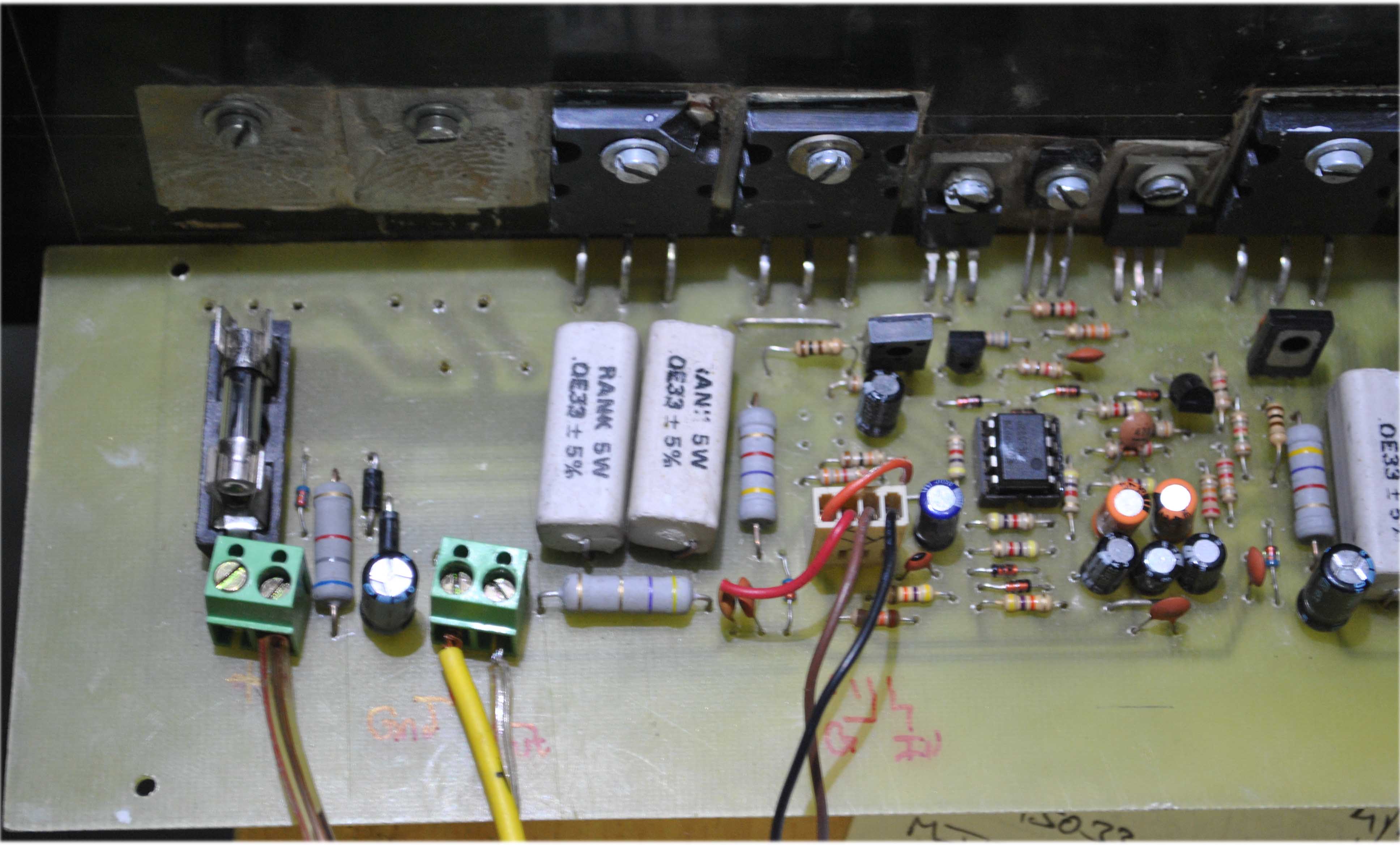

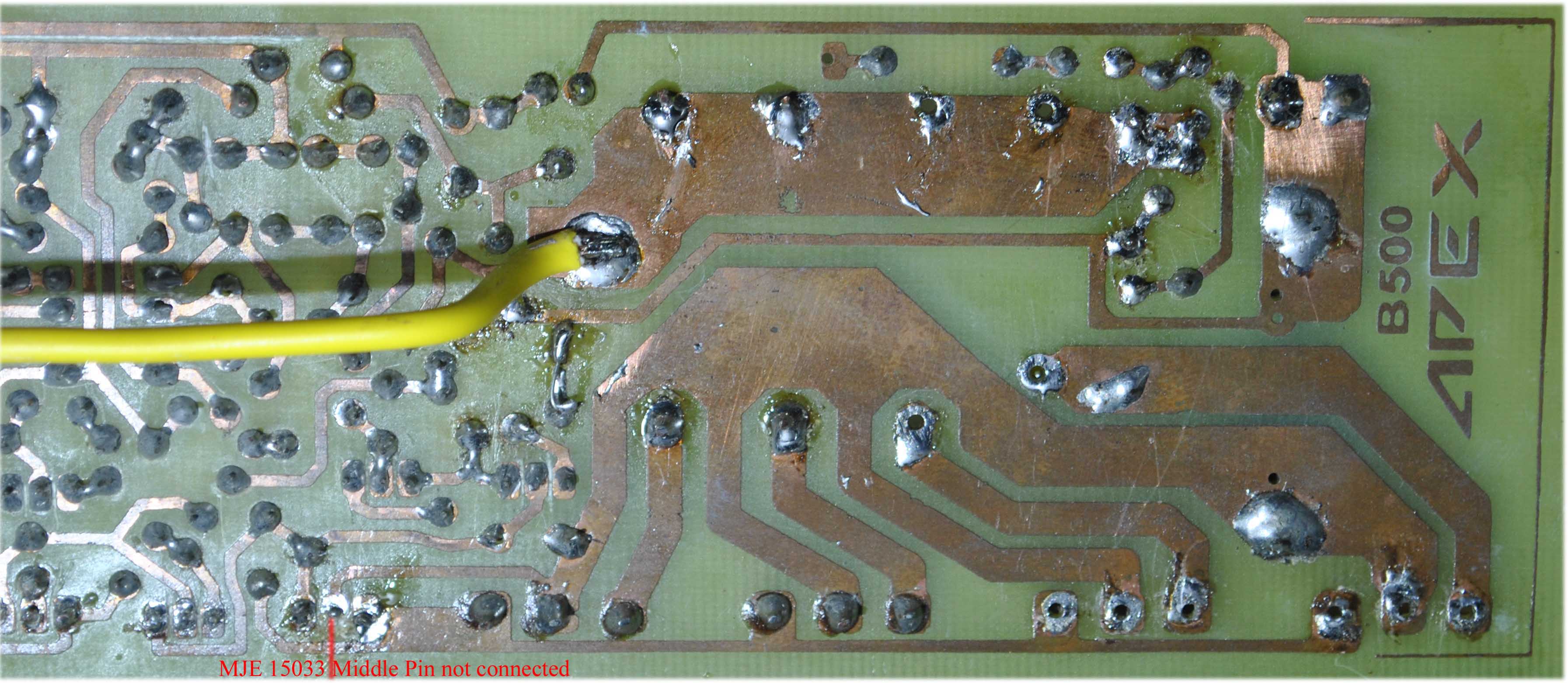

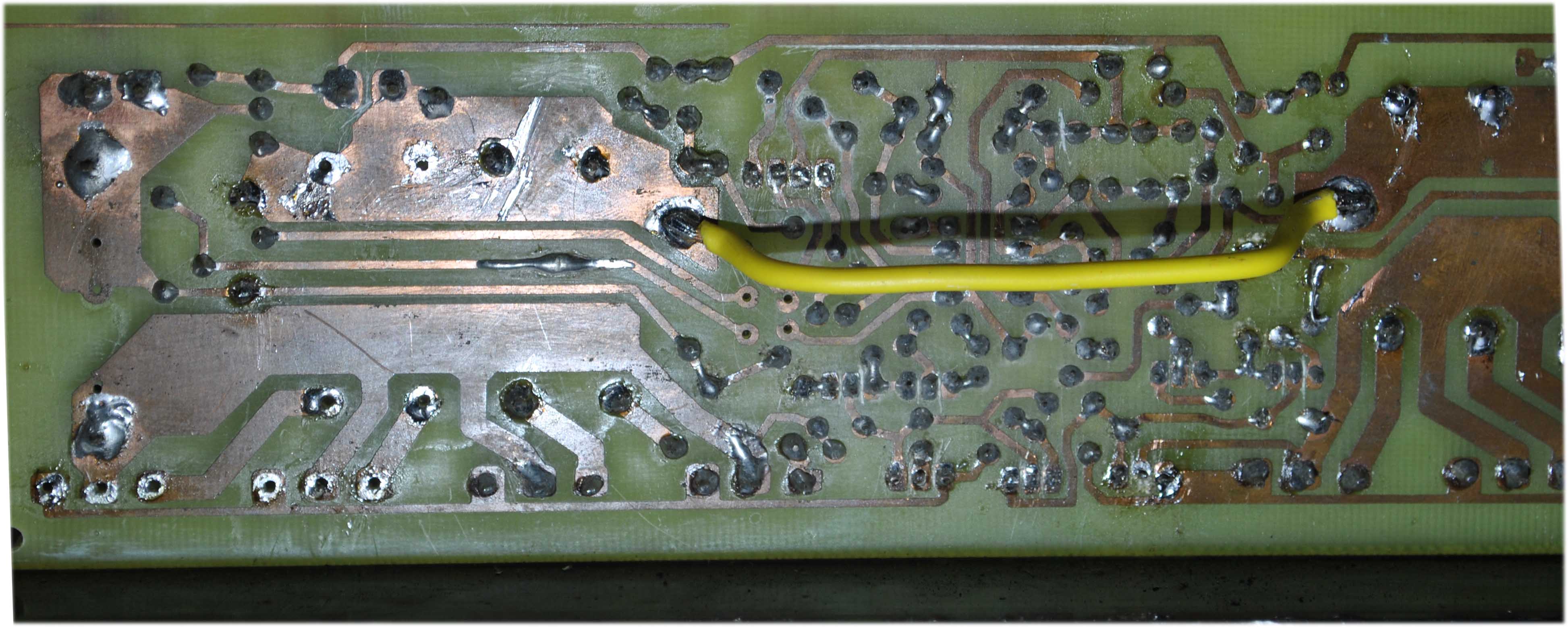

Hello,
Solved the problem of 22e Resistor Burning on psu board.
I disconnected the middle pin of Transistor MJE 15033. Earlier the volume was very low, After disconnecting the middle leg it is very loud , very very loud, But very distorted.
It seems 15033 having wrong pin orientation.
Voltage on output varies between 9 to 11 mv.
What should i do next ?.

Hi Viki,
Its normal !15032 is NPN so 1st pin base is positive. with red lead in base and black lead in 2 and 3 collector and emitter will show readings.
where as 15033 is a PNP so 1st pin base is Negative. with red lead it wont conduct; only with black lead at base(1 pin) will give readings respective to collector and emmitter
your tansistors or absolutely Ok.

hi viki,
recheck your work 3 times or more, component value & placement..then try to insulate or clip the 1/8 bolts of mje15032/33 maybe this conduct short circuit...then clean up your board with acetone or thinner.
regards,
nix
I agree with NIX better check your work many DIYER's and me have made this amp with out problem...maybe you have little glitch on placement of the parts mje 340/350,15032/33 are tricky you have to be more careful
MJE350 is PNP
MJE340 is NPN
MJE15032 NPN
MJE15033 PNP
if its original
if fake you got wrong orientation of pins

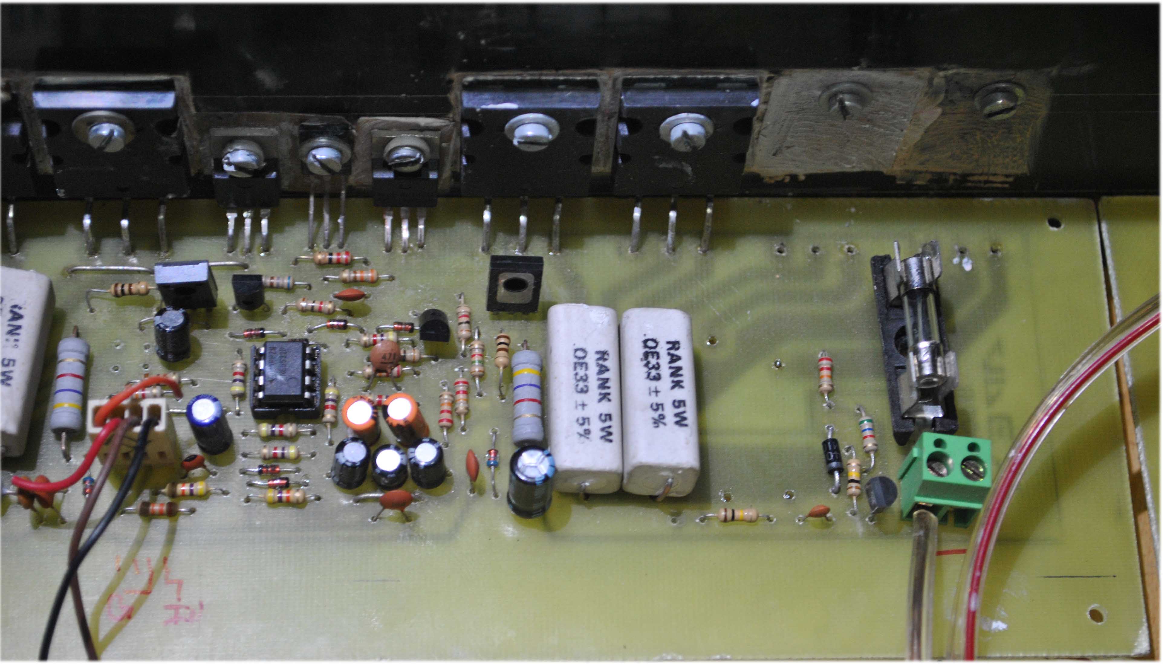

Checked the transistors for insulation, No shorts, properly insulated, checked the parts placement seems to be ok.
sound only on disconnection of mje15033 2nd leg. When connected no sound, E22 on psu gets extremely hot and burns in fumes.
