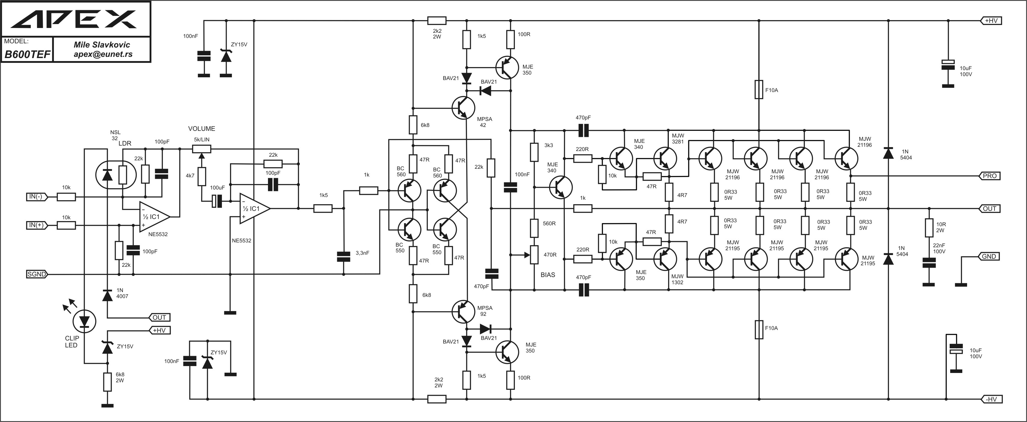

500W PA amplifier with Limiter
There is no input gnd on your wireing circuit.

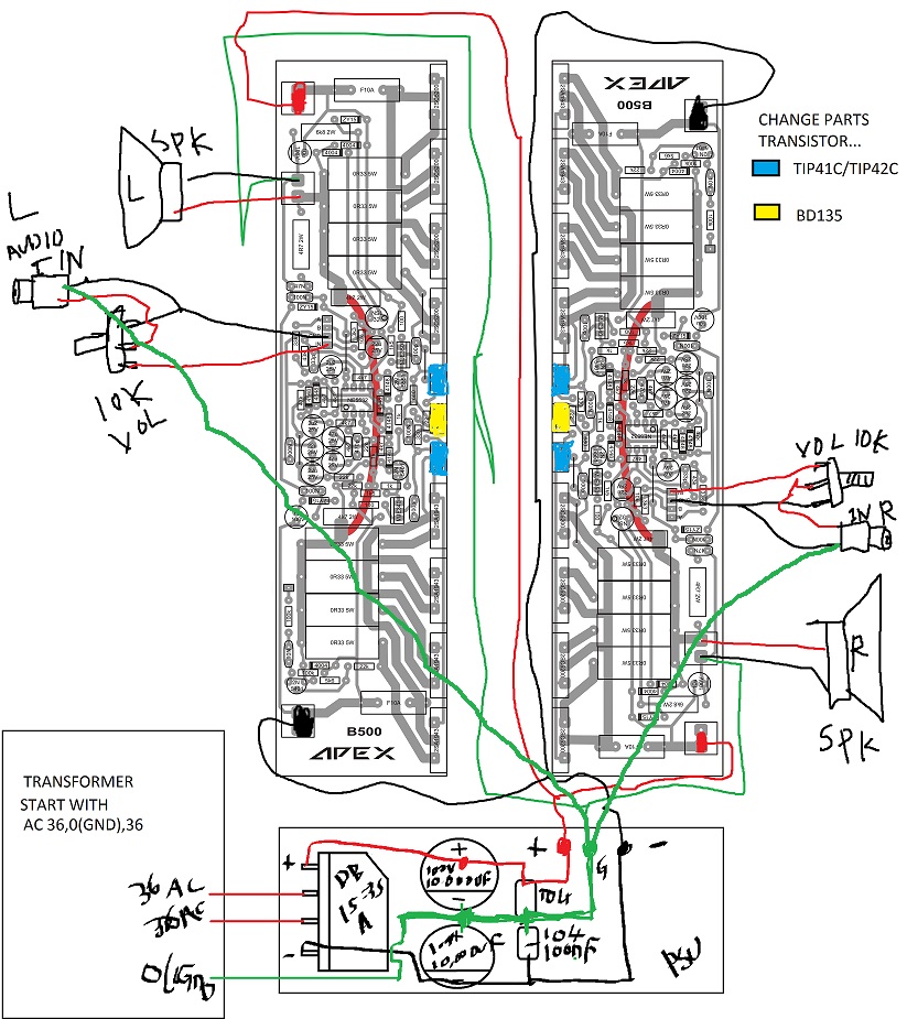

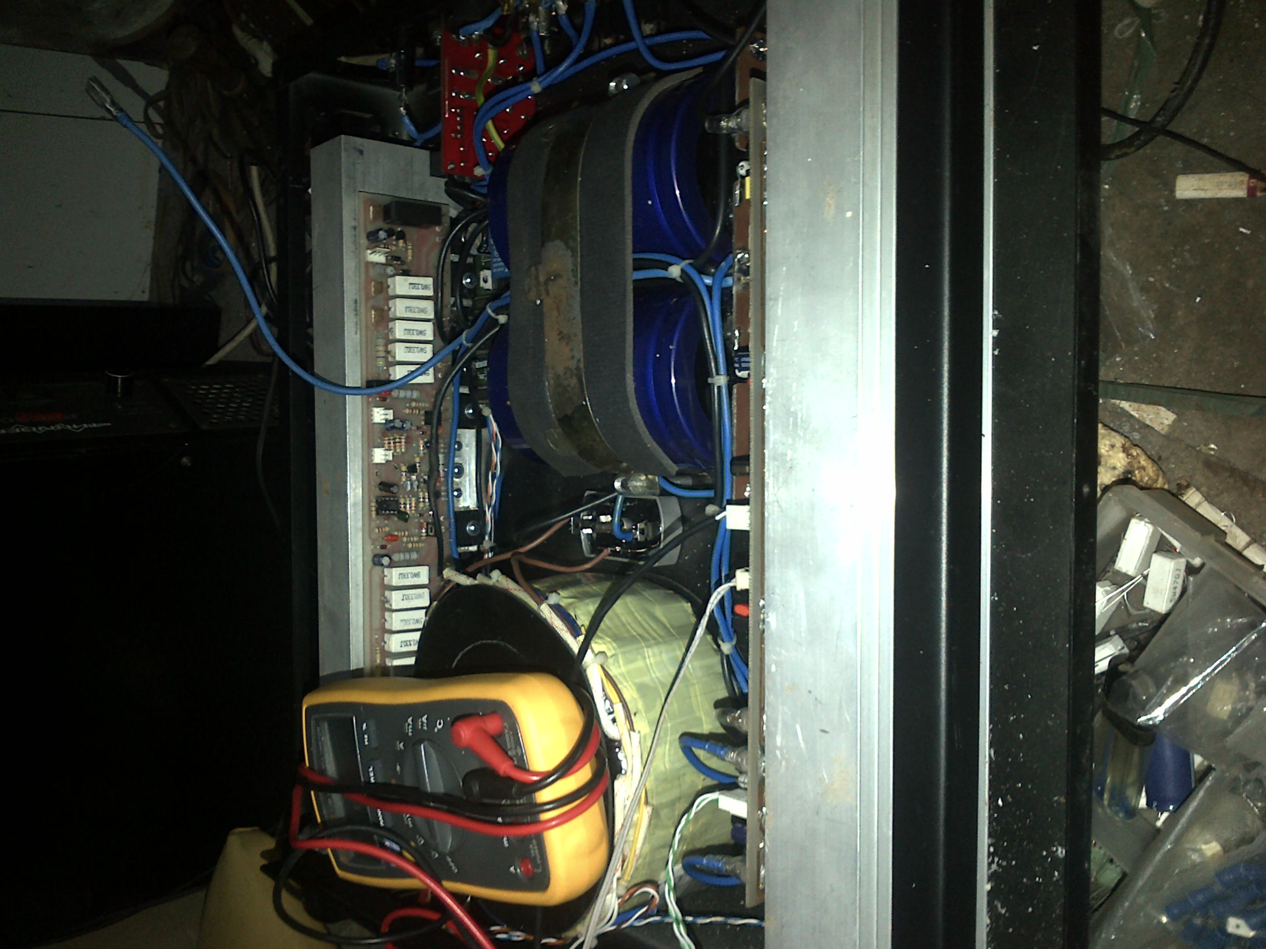

My apex b500

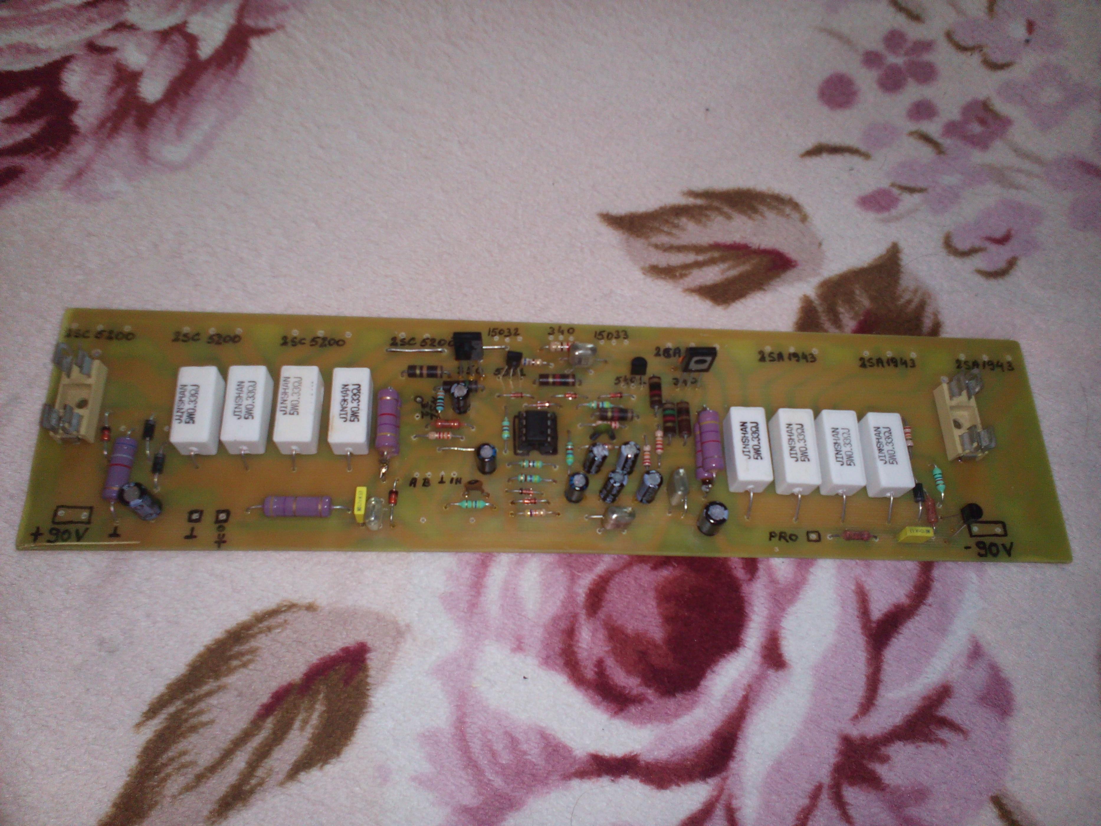

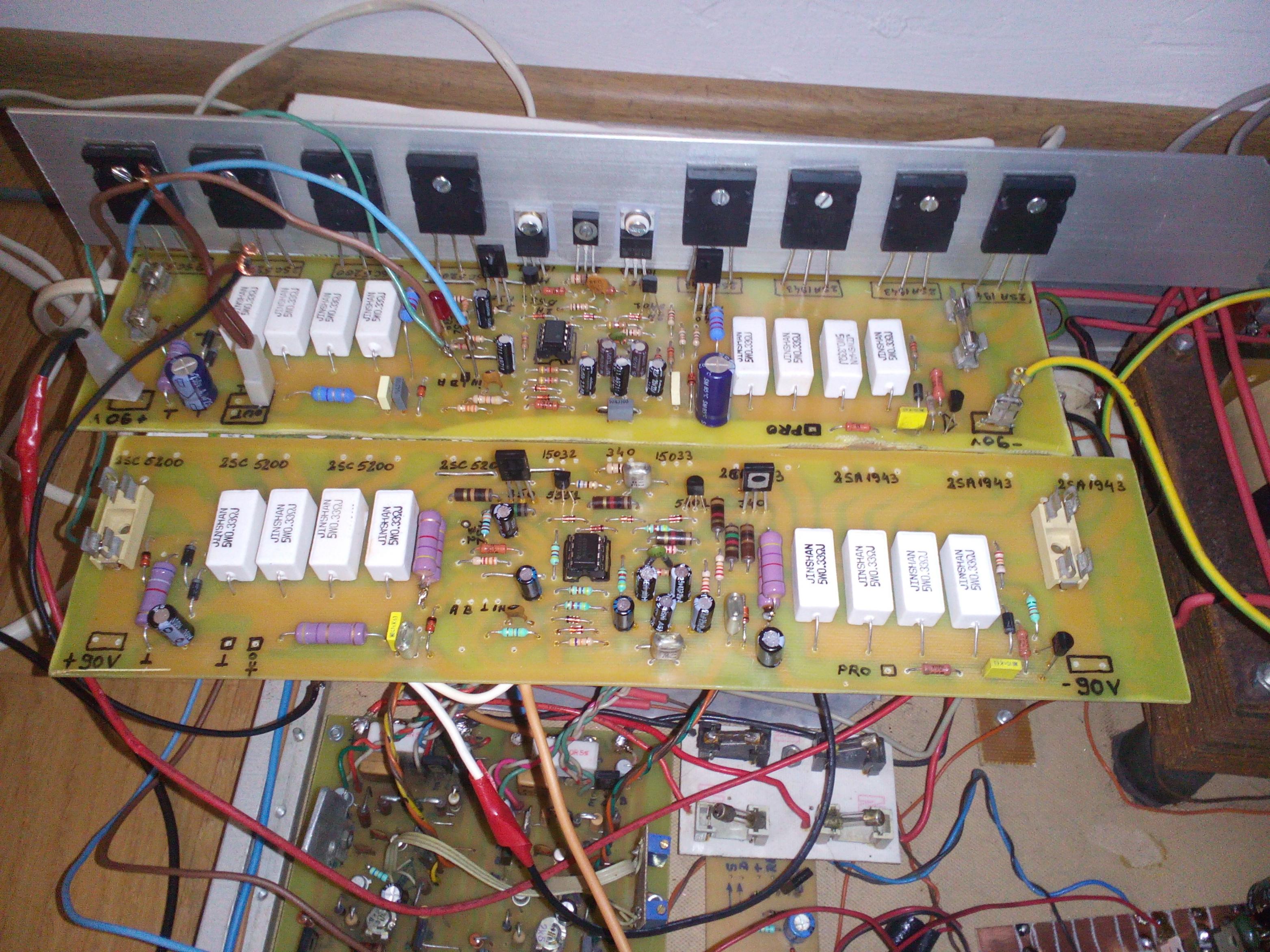

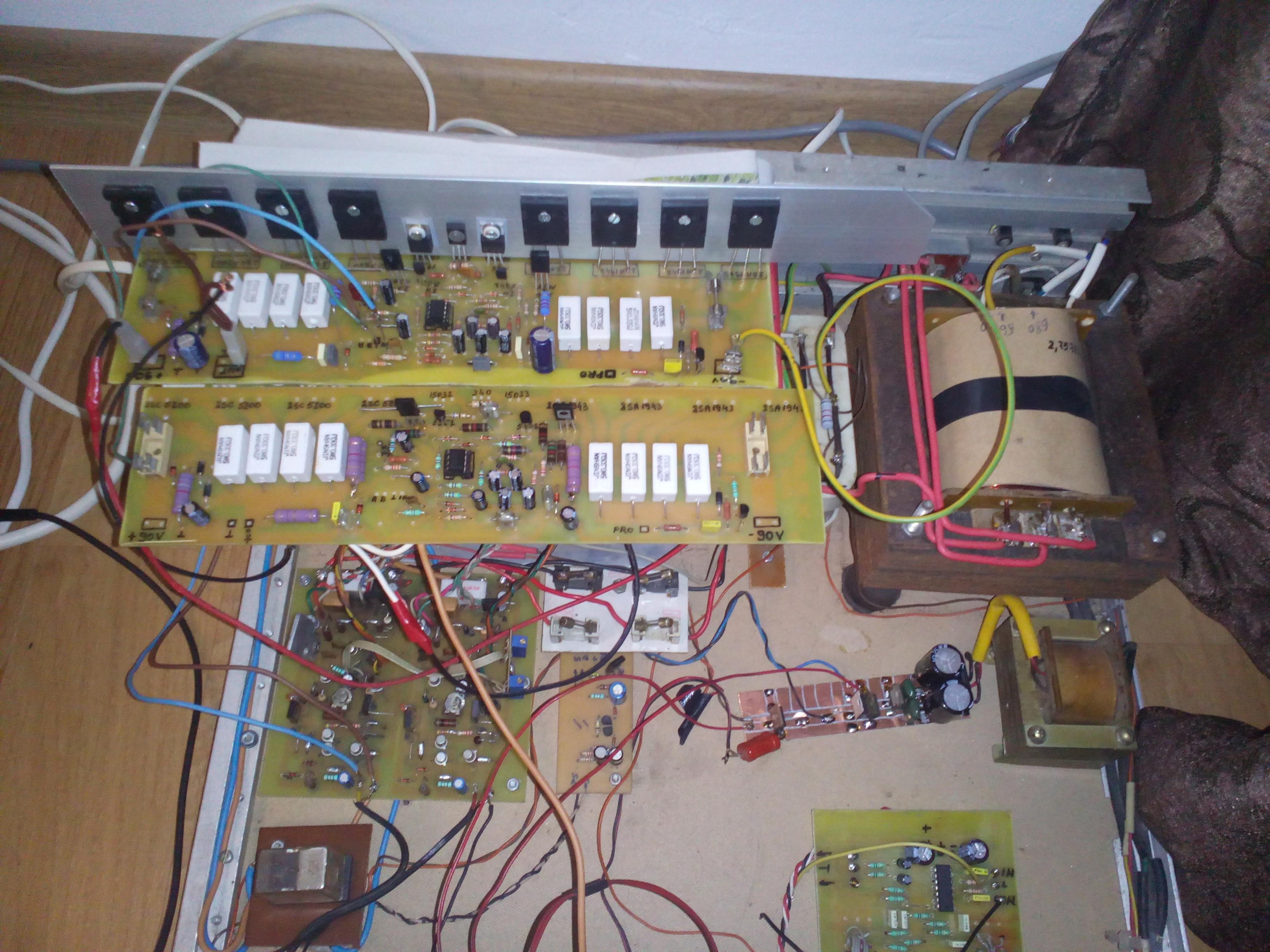

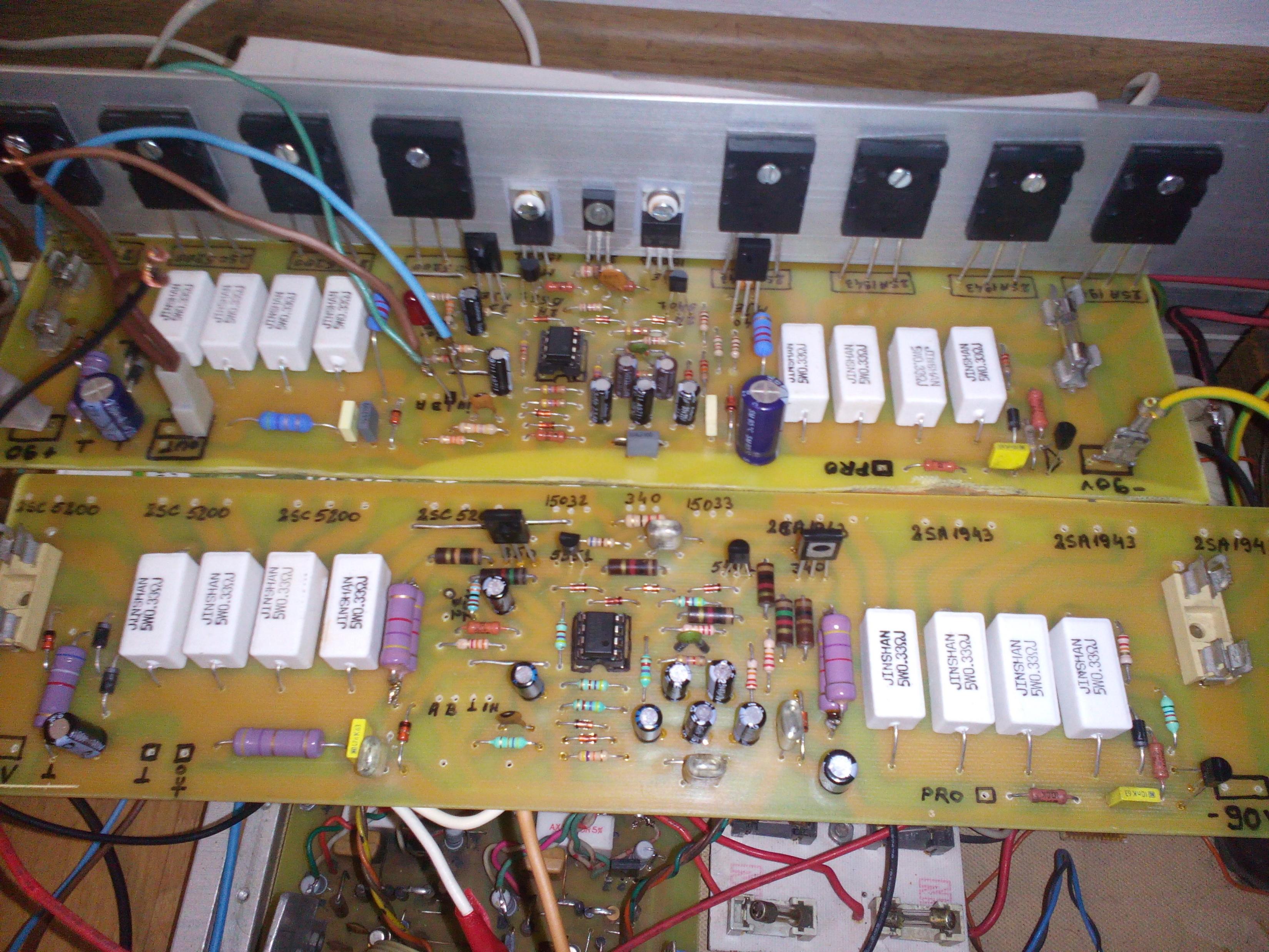

Thx Mr Mile for sharing that amp , i made first chanel and sound its loud and clear :)
