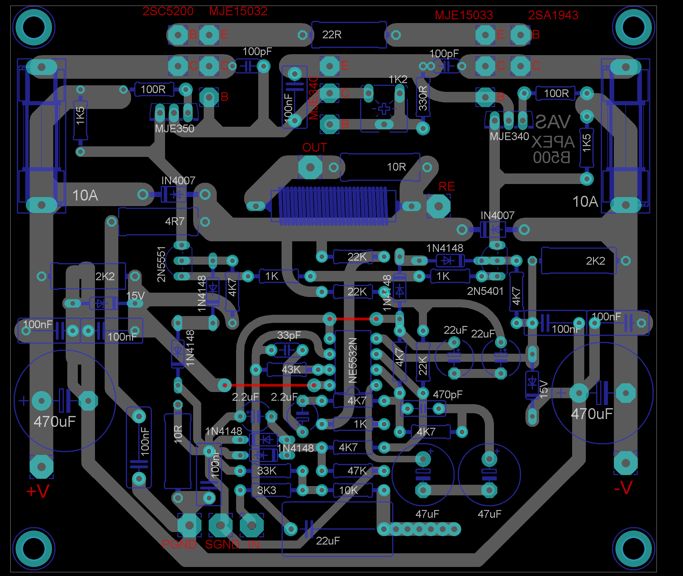

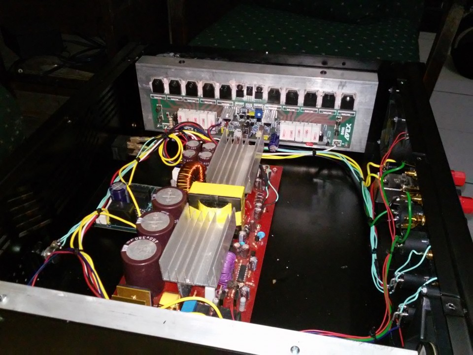

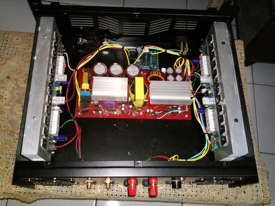

Hi mr.apex i build b500 recently good sound clarity,i will try to apex b600 all components are ok,but Bav21 not available in my place any equalent pls? Thank you
Use BYD33, MUR120...

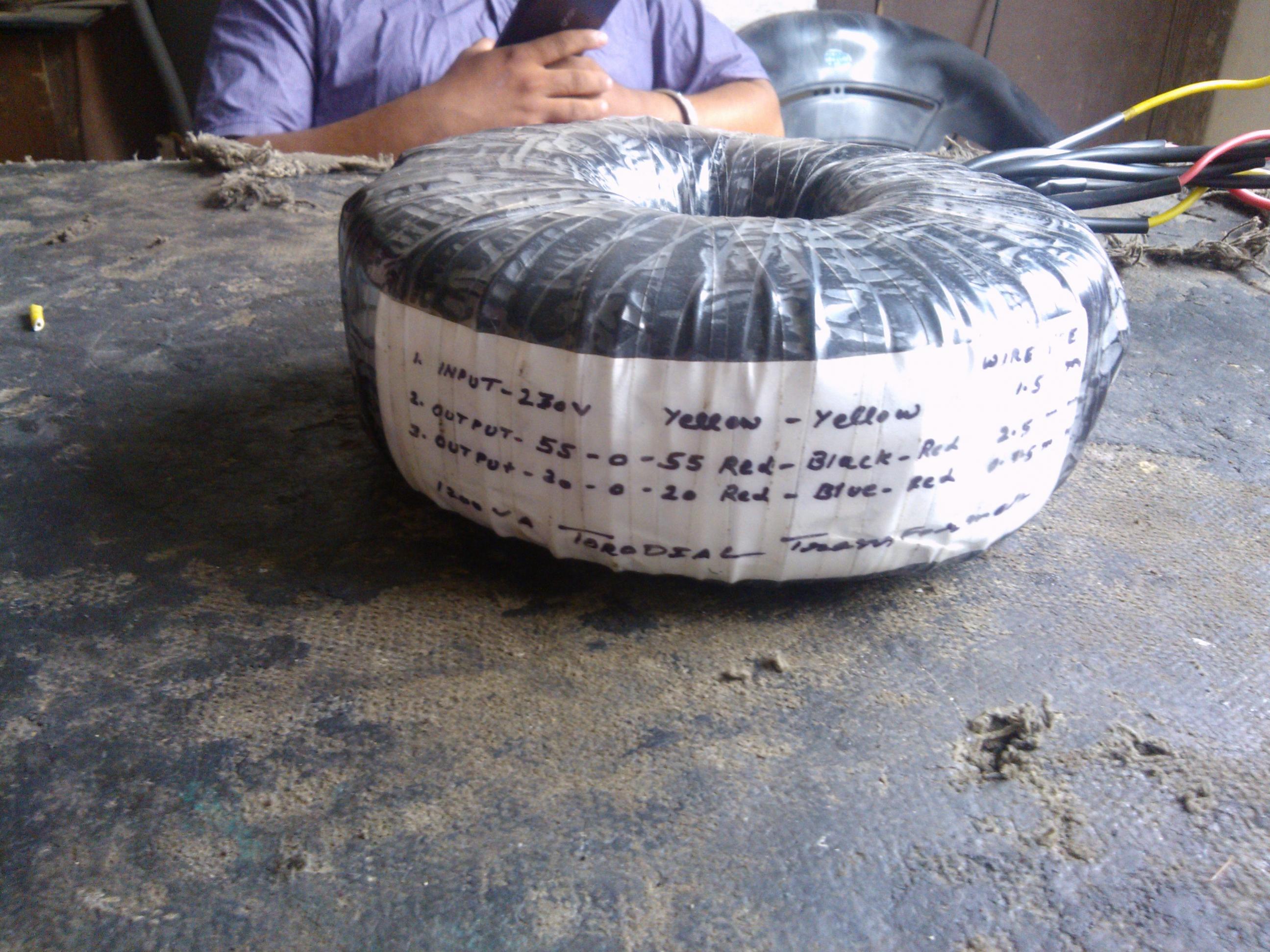

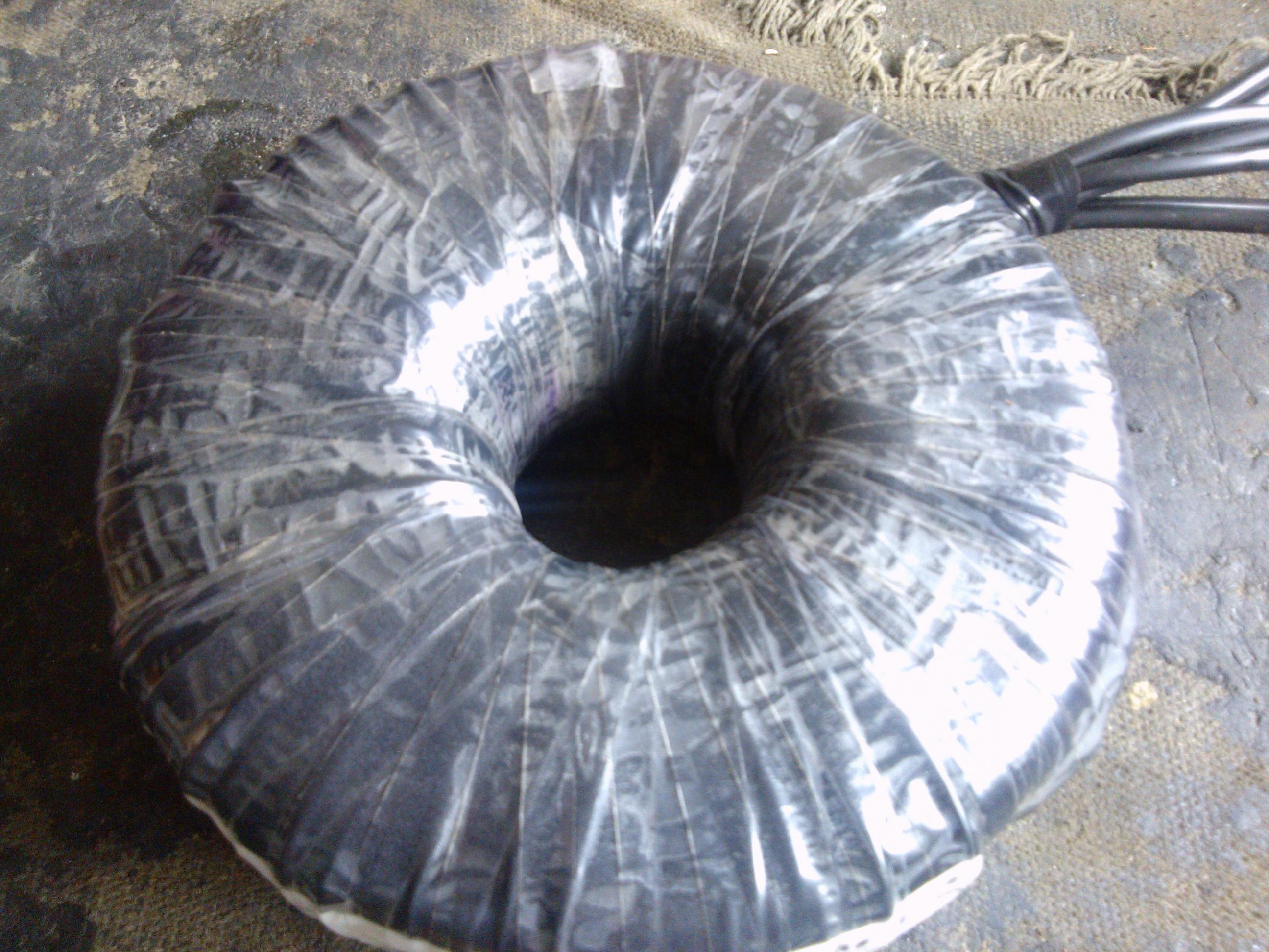

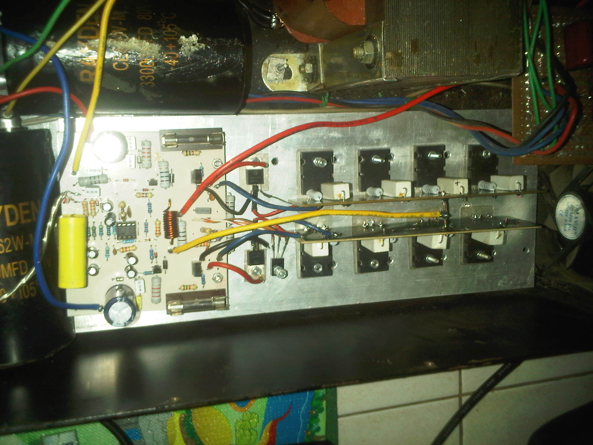

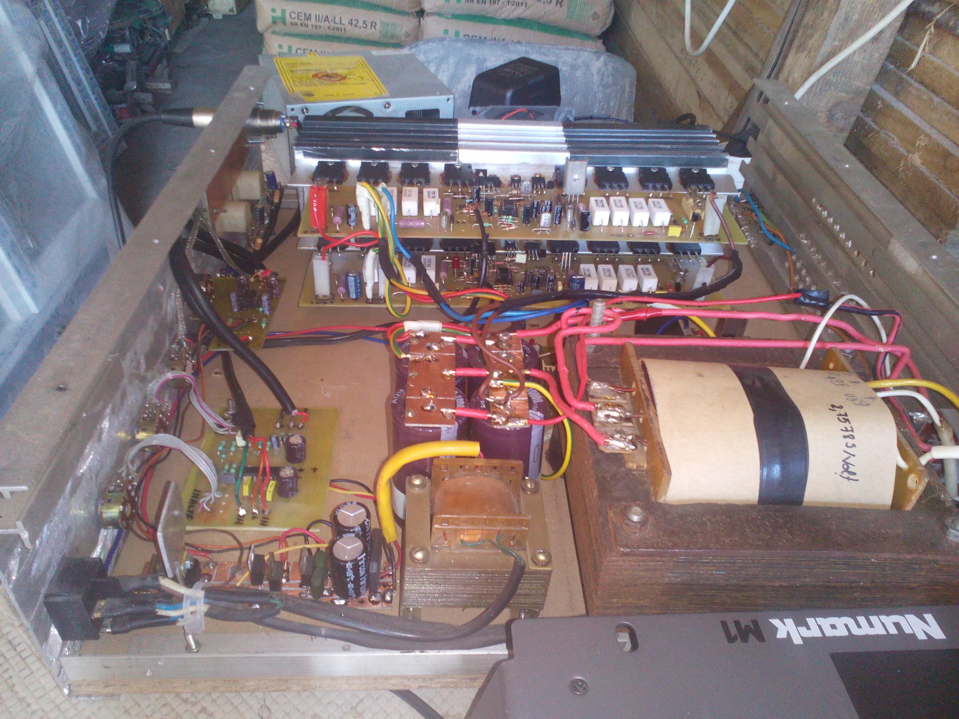

1200va toroidal made by my friend and upgrade by me for apex b 500 tef.some tone for apex op line amp.dear sir is 20000uf cap per rail good for stereo b500 tef with +- 90 vdc ? or i go with 30000uf per rail.i know that more uf always best but i don't want to waste cap.load will be 2 nos of 300w 8 ohm 15 inch top speakers per channel.thanks.

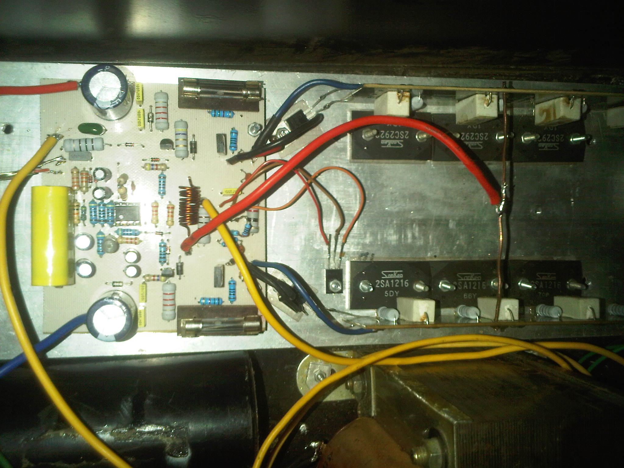

Nice work!b600.tef http://www.diyaudio.com/forums/attachment.php?attachmentid=472490&stc=1&d=1426815148[image]An externally hosted image should be here but it was not working when we last tested it.[/image]
Can you share the pcb pdf and schematic for this amplifier?
thanks andrew,this amp is modify by vedmitra sharma and they already gave files to me.

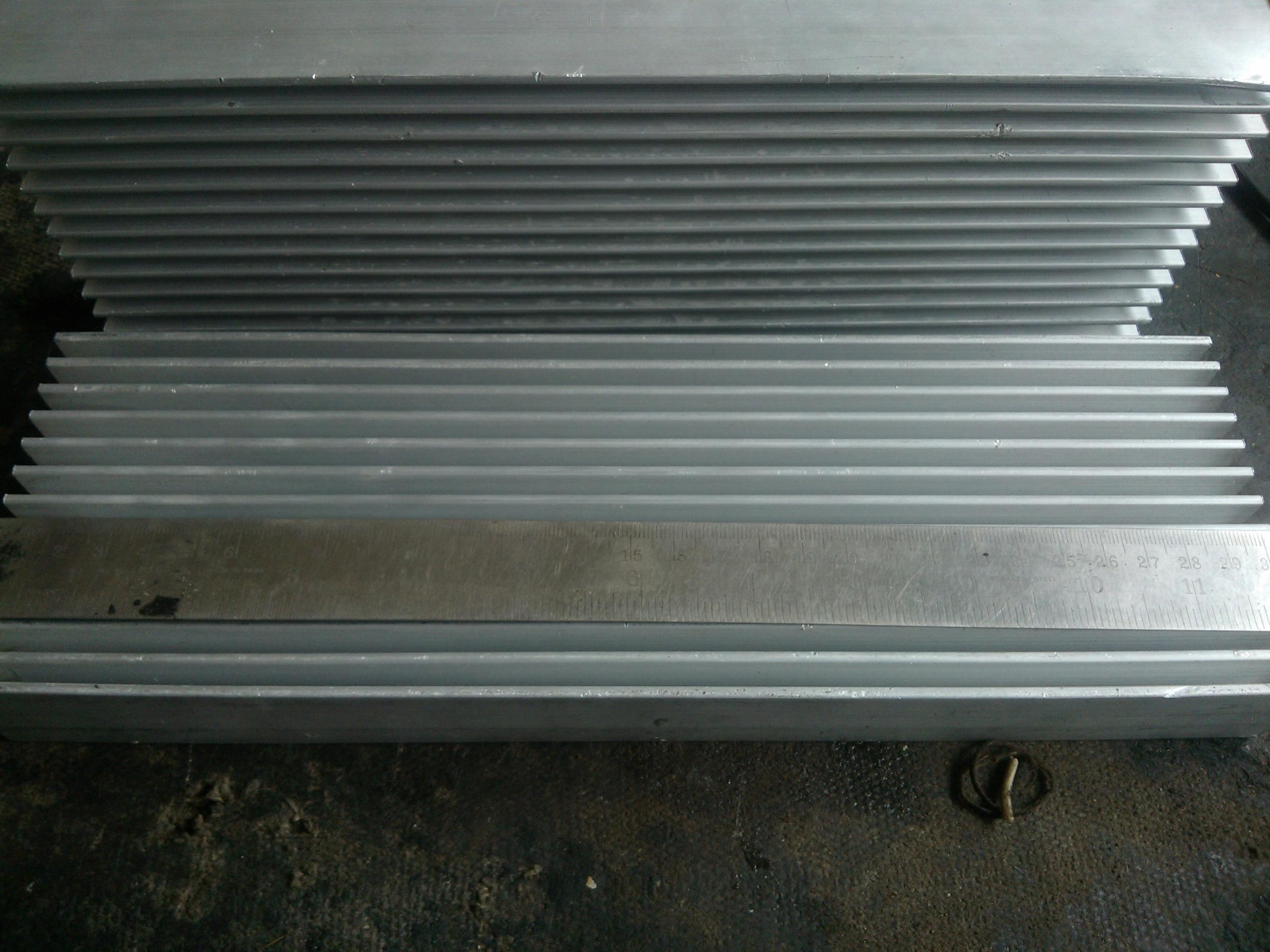

Who want like this heatsing power BUILT UP with long 40cm and height 12cm...
Just $ 16.5./piece
Position in INDONESIA...

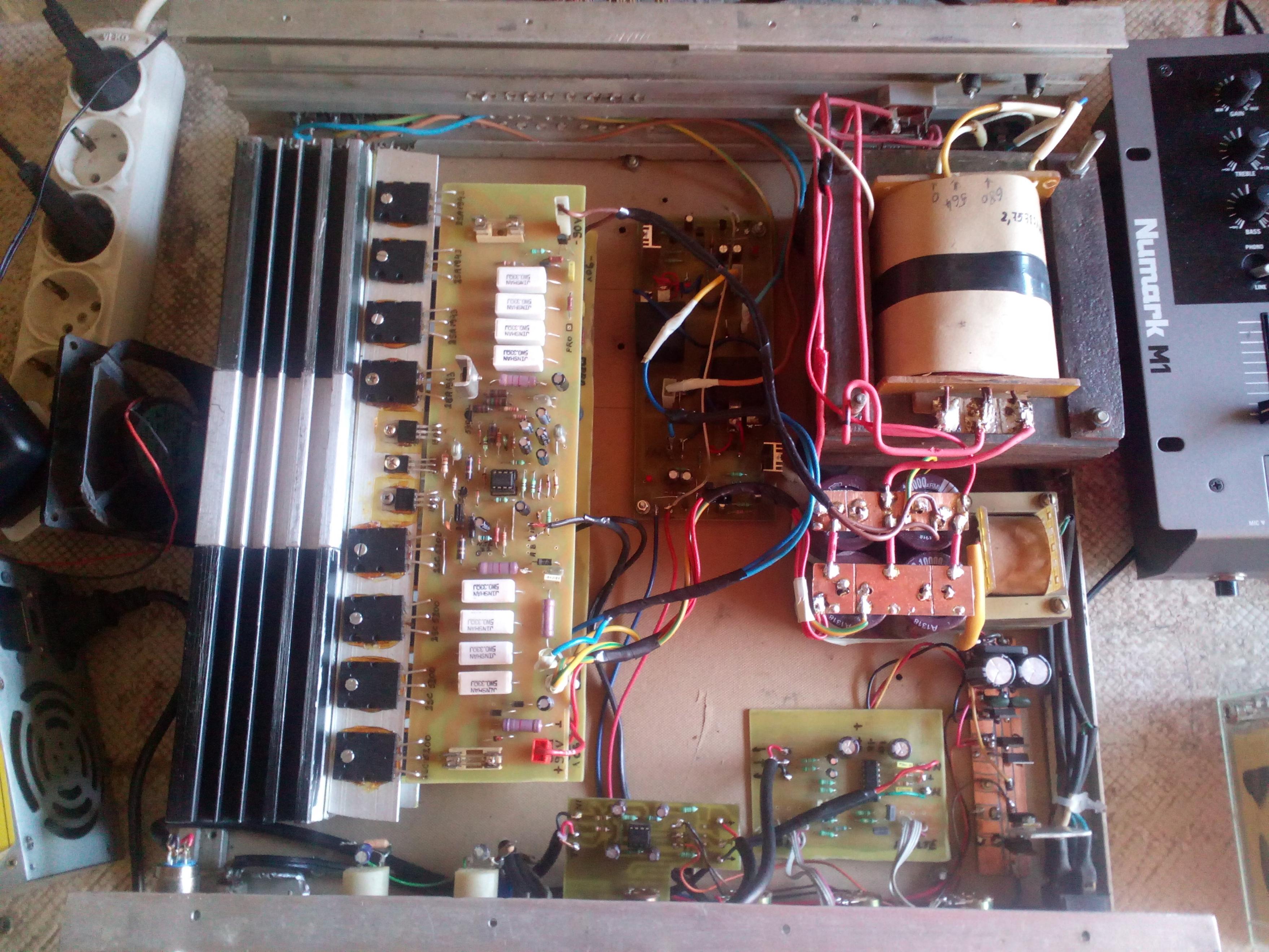

hello guys and mr. apex.. how much should be min/max the bias of b600 im using 60-0-60 ac,15a... or what parts need to change?? my driver mj340 and mje350 heat fast but still working.. heres the video https://www.youtube.com/watch?v=A0XzxuUzxm4 thanks..=)
thanks sir i will try again to adjust to lower the bias..=) have a nice day185 mA is rather high for one emitter...i set it at 50mA initially, then work my way up till the sound at low volume levels are not distorted...
