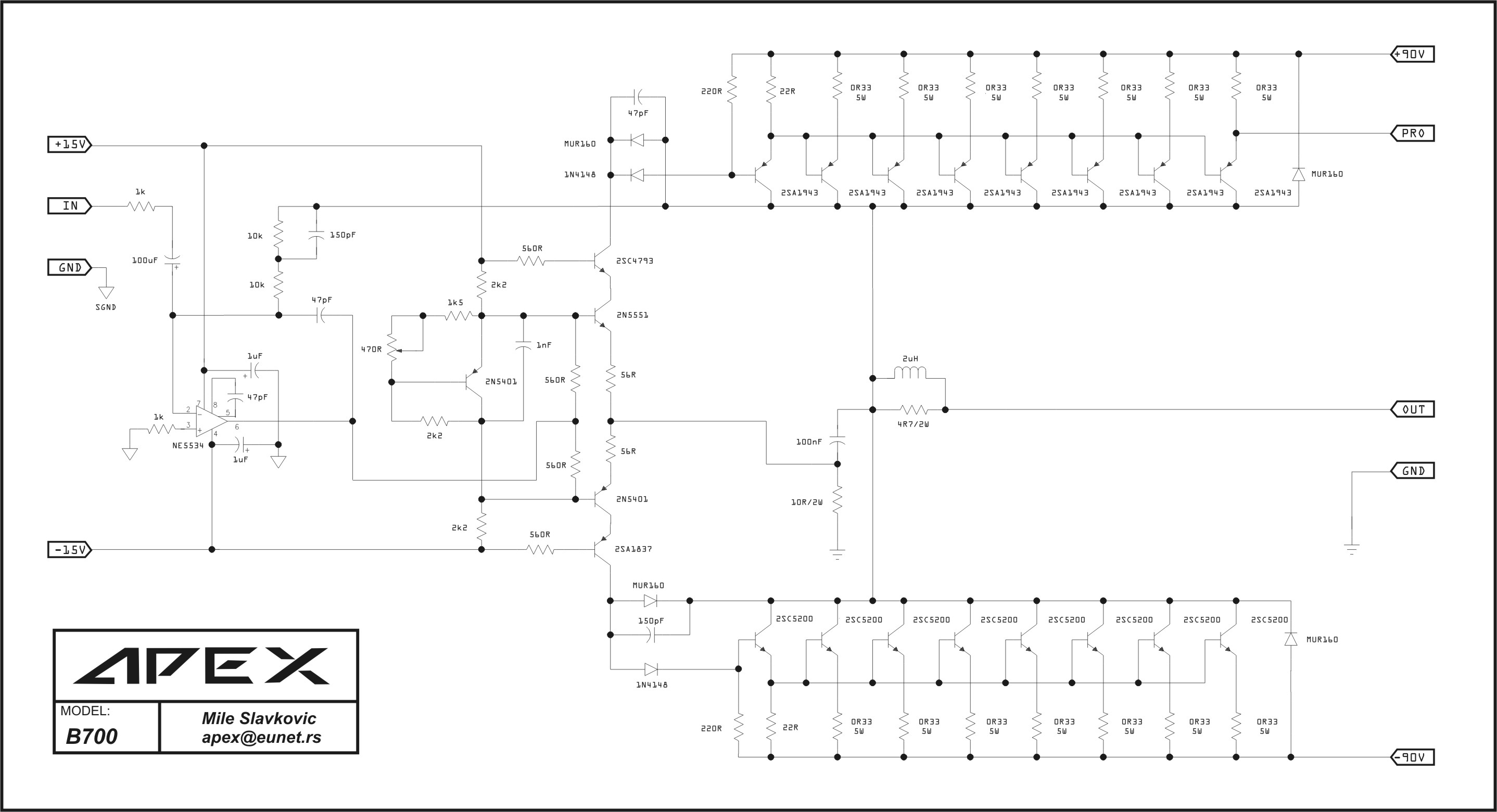

new design apex b500tef...work..tanks apex audio
and h900tef on trial.
Can you share pcb design and componend overlay pdf files?

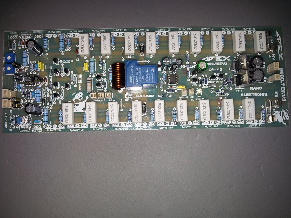

did You test it? I had many problems when try to rebuild the Crest pro 200 series. It was not stable...

which schema you follow on this sir?
b600.tef http://www.diyaudio.com/forums/attachment.php?attachmentid=472490&stc=1&d=1426815148[image]

good idea sir apexaudio. I will be simulated. test. the B700
I did it already, but unfortunately the PSPICE model of the NE5534 is not really good, and makes oscillation, or the whole simulation is frozen with it.

b600.tef http://www.diyaudio.com/forums/attachment.php?attachmentid=472490&stc=1&d=1426815148[image]An externally hosted image should be here but it was not working when we last tested it.[/image]
Looks fine!
Sajti
Use 741 or TL071...
Use 741 or TL071...
741 is terrible slow in the simulation, and makes nice triangle wave from the sonusoidal input at 20kHz....
TL071 maybe OK, I will test it.
