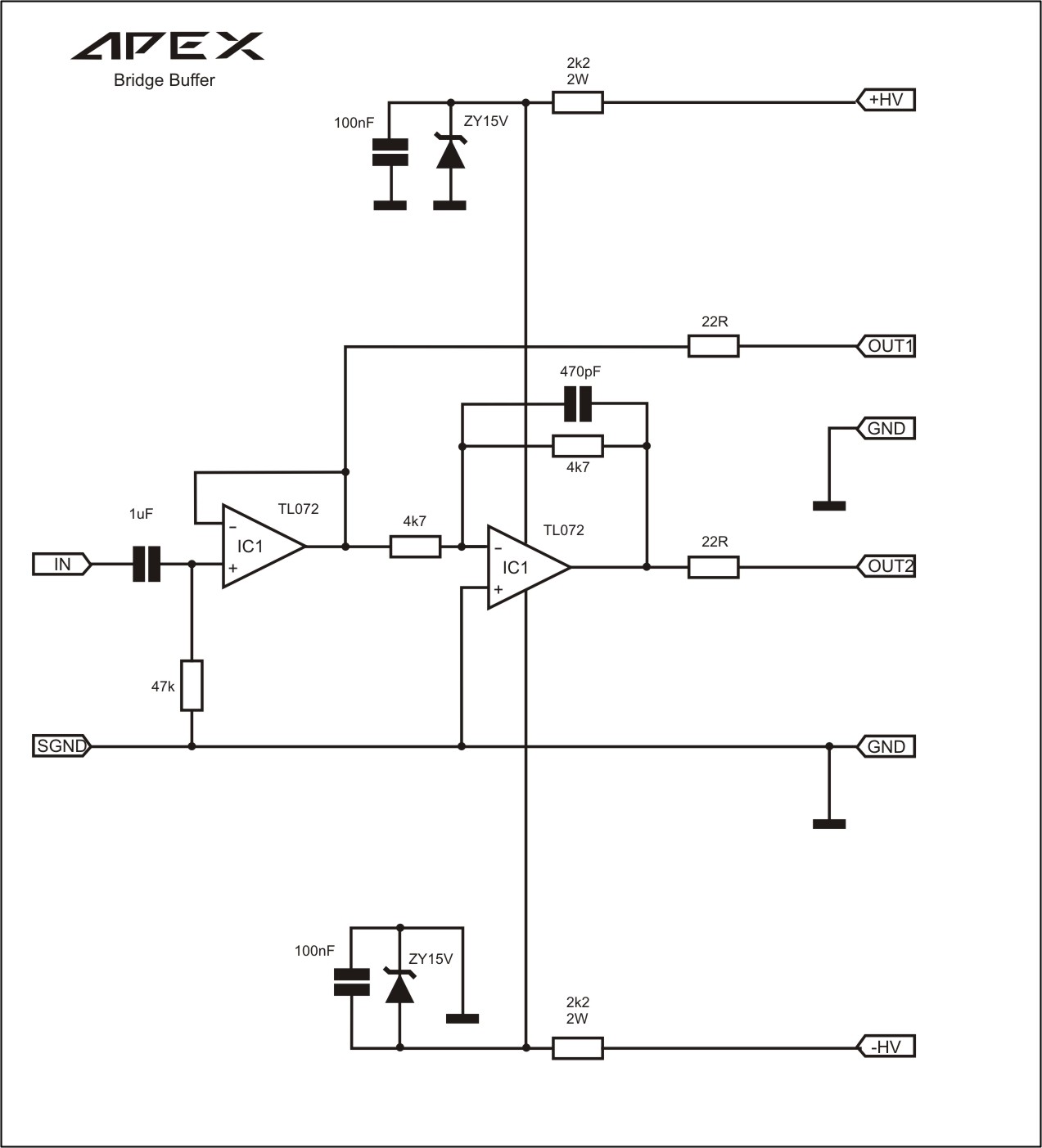

hi apex sir,
can u upload a bridge switch image.

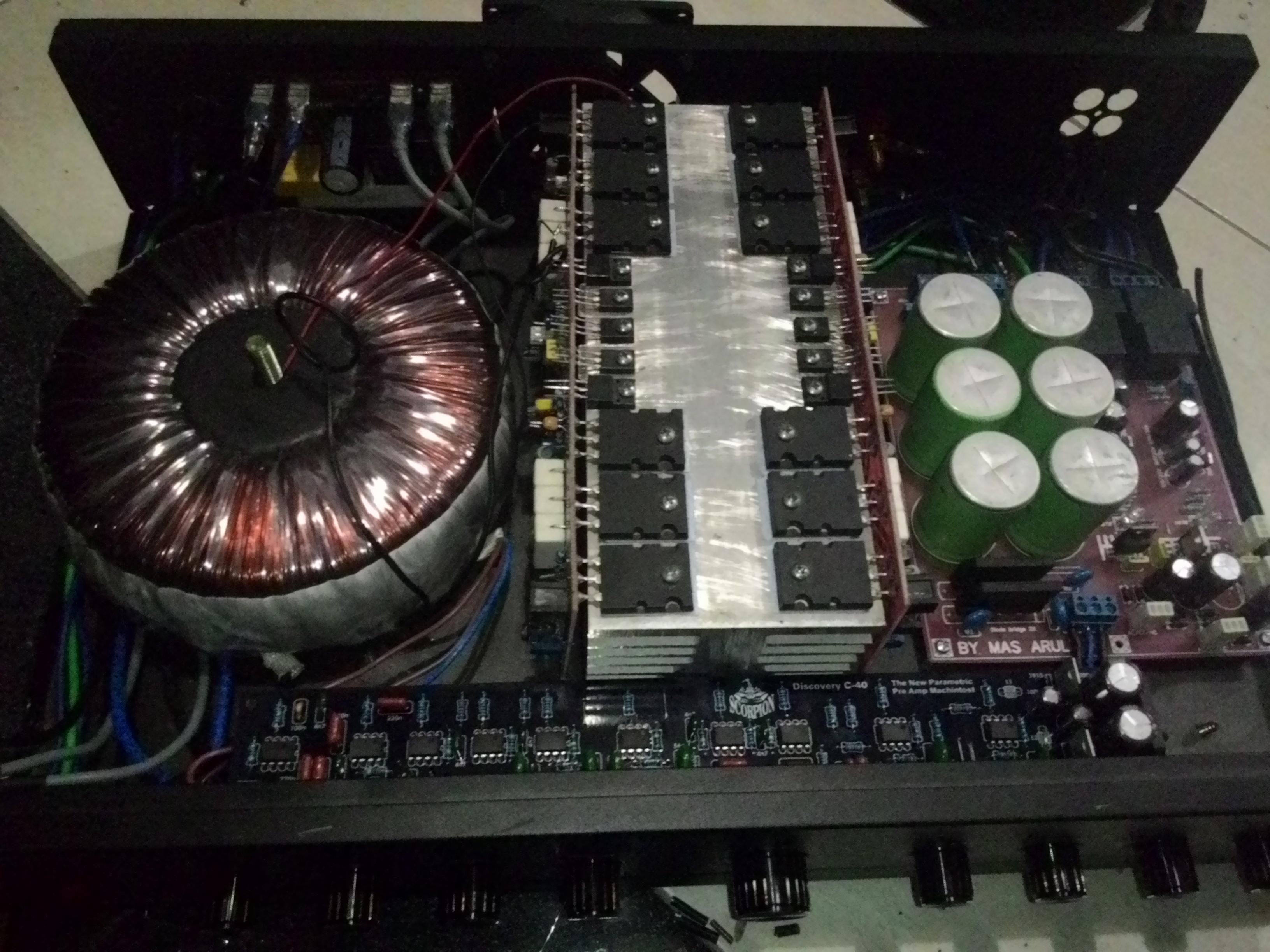

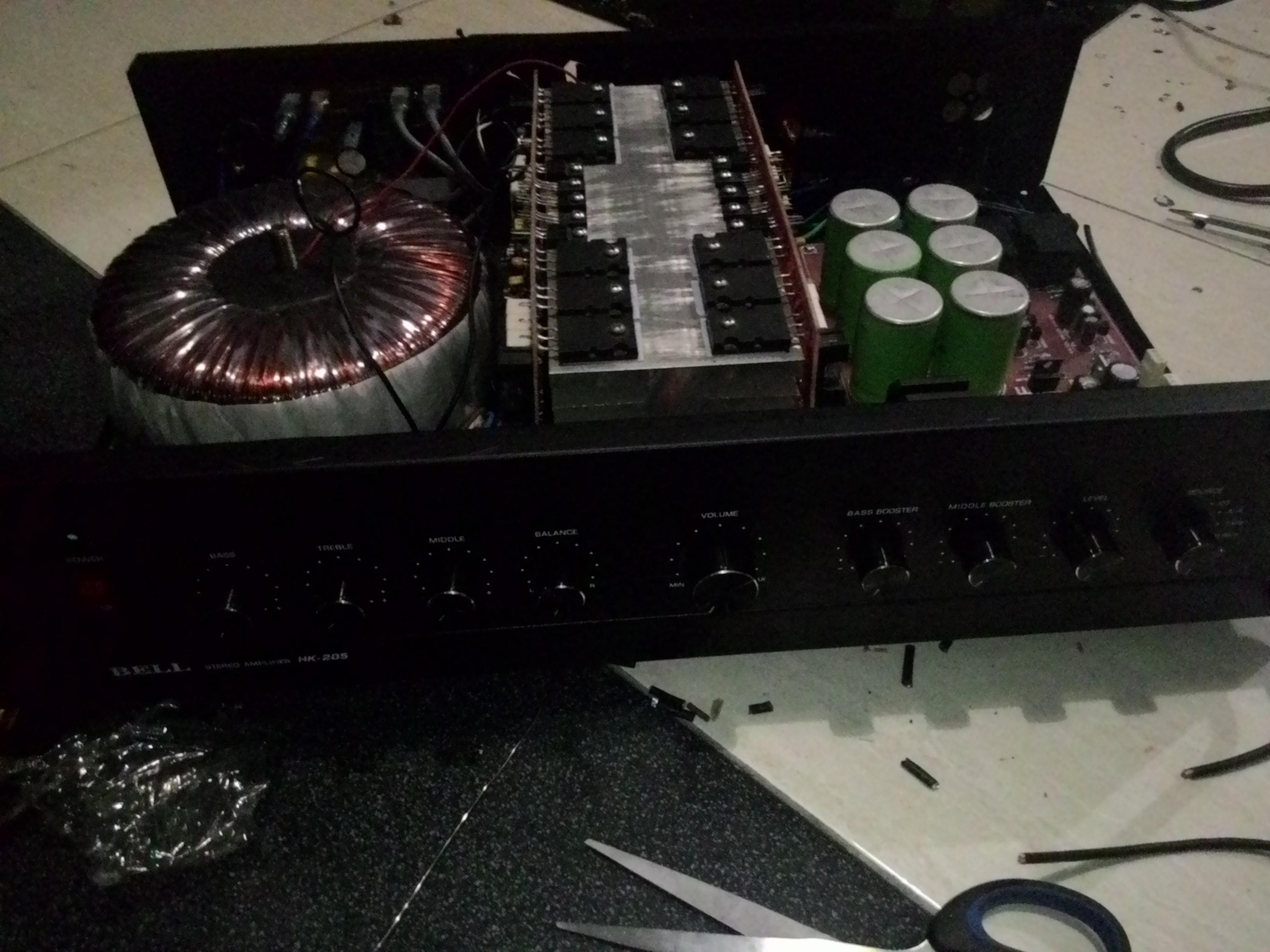

the output stage is bolted to the fins of the heatsinks.
They should be bolted to the core of the heatsink.
The core at the bottom is the wider one intended for device bolting.
The heatsink fins are not in the airstream.
The heatsink should be in a tunnel that constrains the cooling air to flow along bwteen the fins.
The fan is not connected to the heatsink tunnel. The air will take the least resistance path to avoid going through the sink.
Your Thermal design is so badly flawed that your risk severe overheating.

What use are these two comments when they both ignore the obvious implementation errors?Nice work,
Andrew, look carefully at that heatsink.
Where would you place the output transistors?

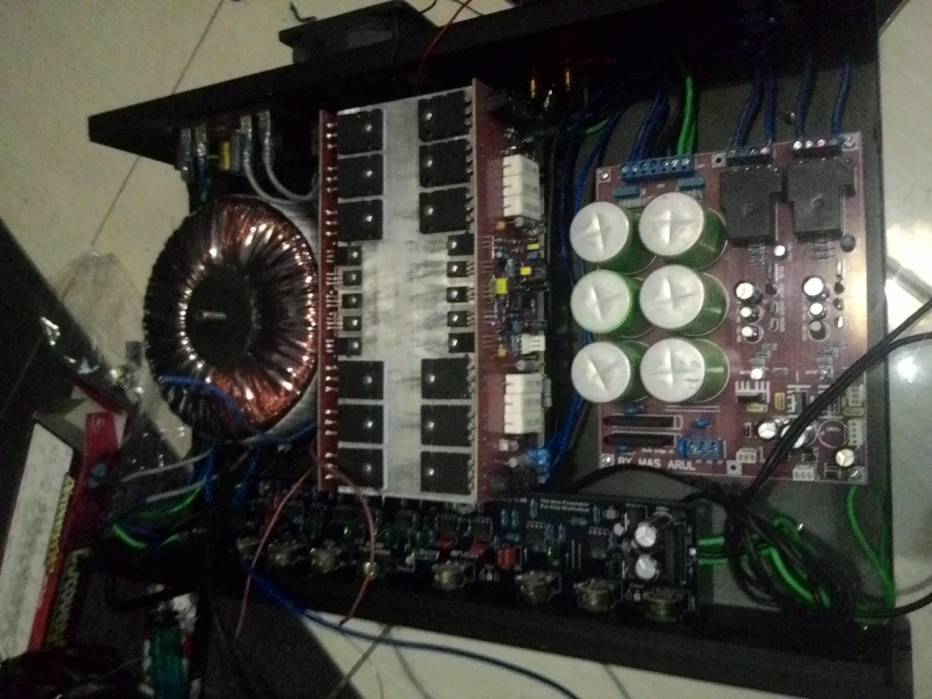

And yes since he build a lovely amp, maybe he should put a blanking plate over the current hole for fan, and line the centre fan up with the centre of the heatsink.
Remember the fan must blow thought heatsink tunnel and not suck
Regards on nice amp.
The heatsink has a thick core running vertically in the laid on it's back assembly.
That thick core is intended for attachment of the devices to be cooled.
The core is not symmetrical. The region at the bottom is significantly wider than the region at the top.
That is where I would attach all the devices. NOT on the fins.

I did look carefully. That is how I was able to assess his/her implementation.
