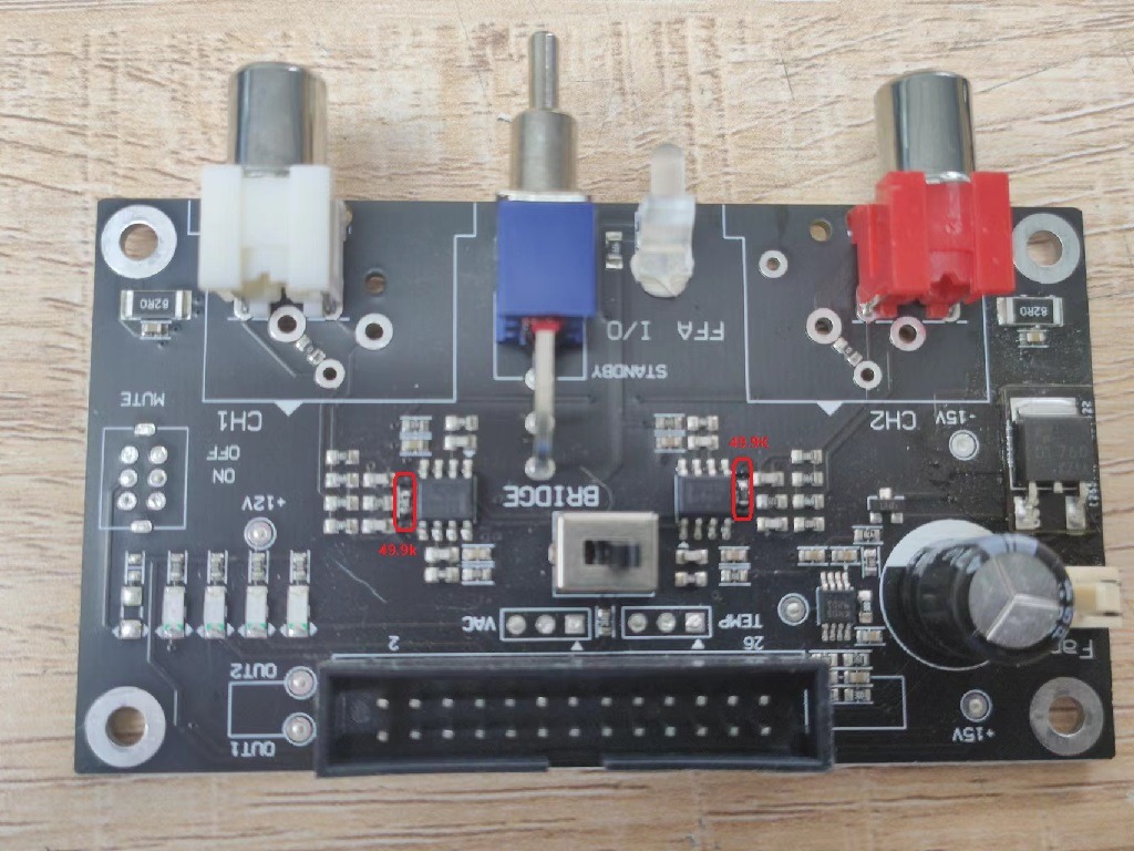

Thanks to Yatsushiro‘s help to reply the PE ground question.
With increasing the value of the resistor at the I/O buffer board, it can slightly keep the unit gain for the I/O buffer.
And, for the toggle switch, you can take it as the soft switch, it will shut down the Main SMPS, and the aux SMPS only can output 12V to save power.

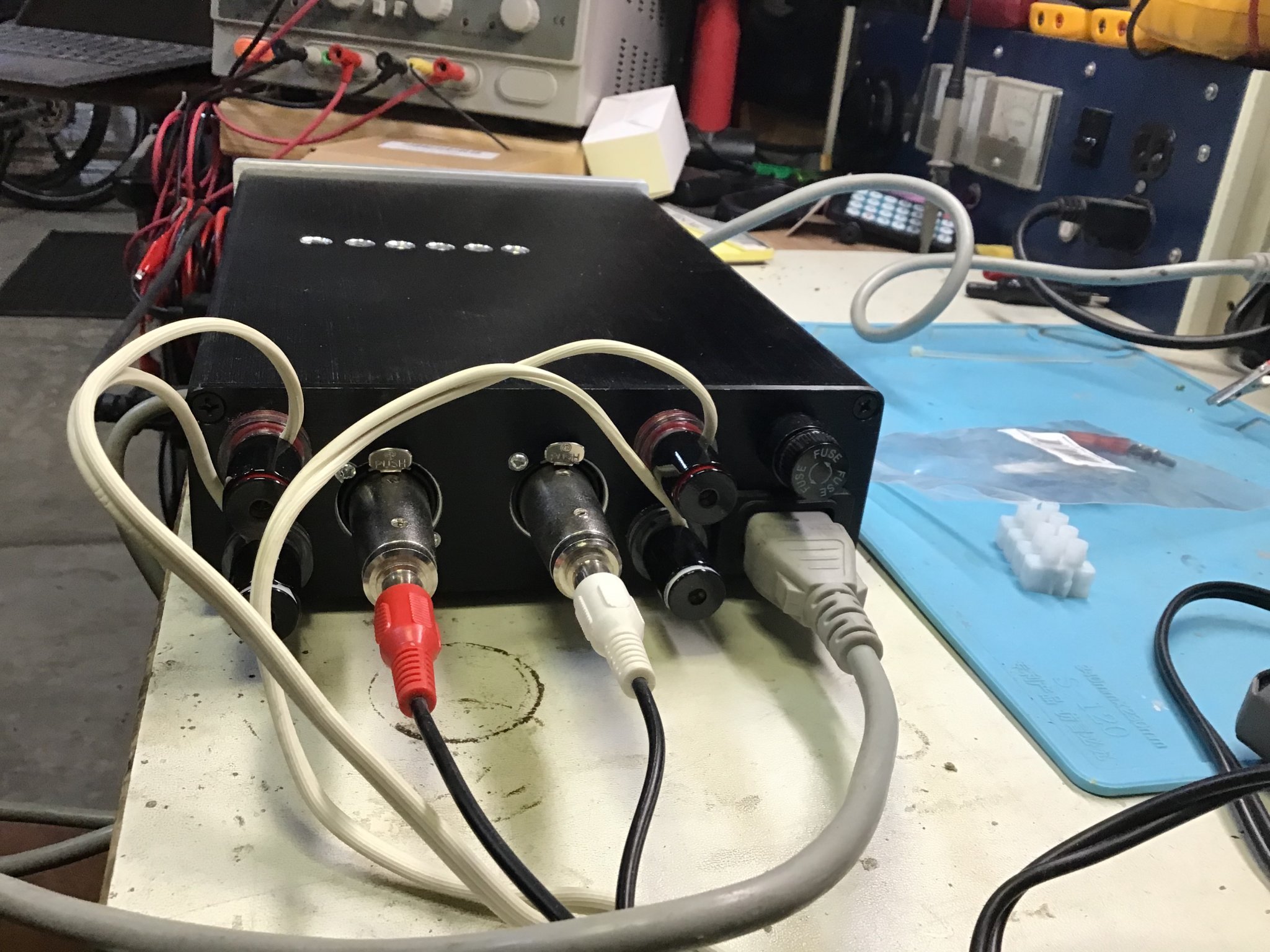

Your amp is nicely done! I think it's the first one pictured here that's using RCA inputs. Did you get the SE versions or modify the balanced input boards?Finished wiring 3 up for an upcoming MEH speaker project.

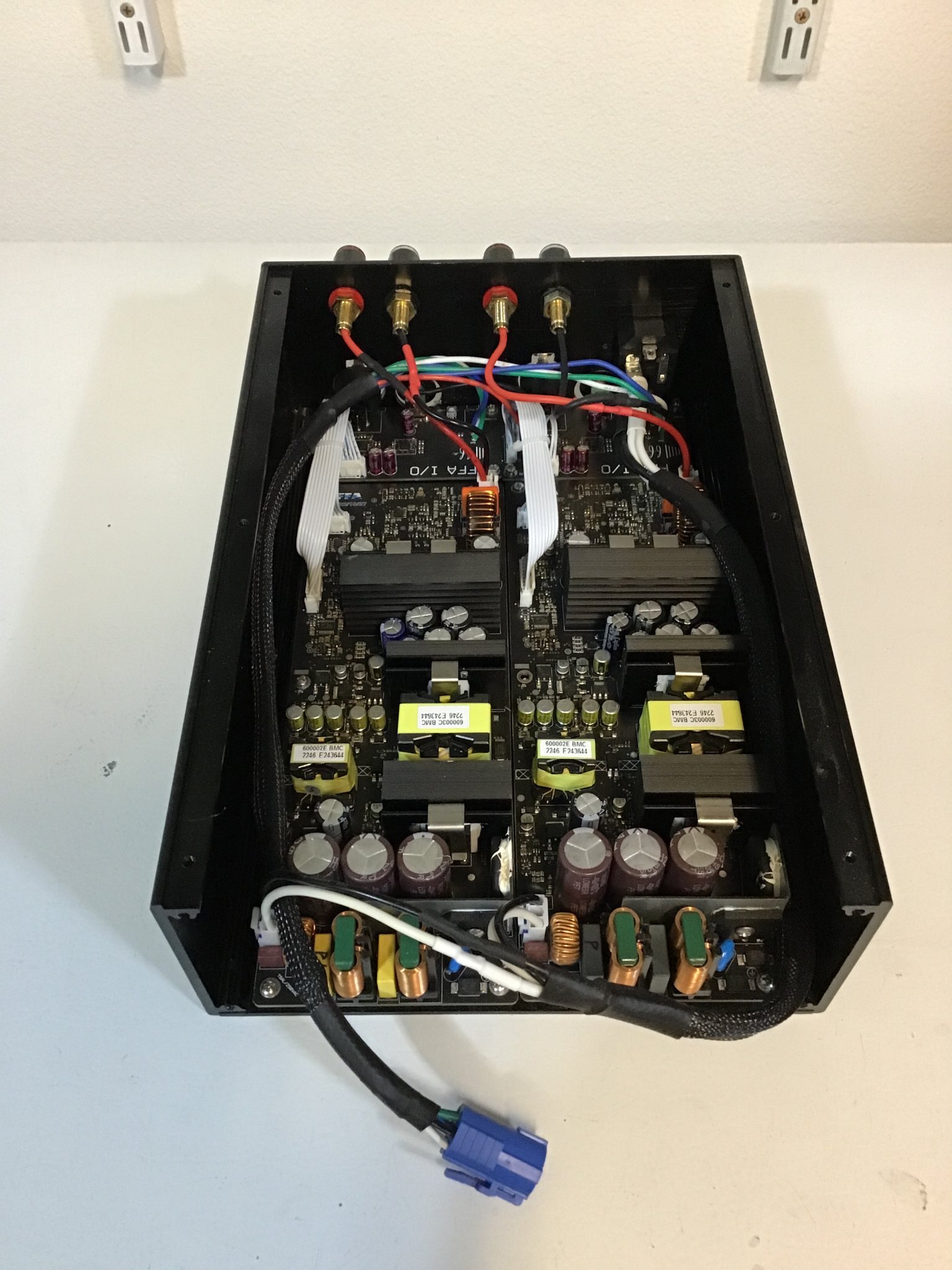

I have 3 FFA001 doing endpoint duty for Roon around the house. This is the FFA003 and will go into my main listening system in the living room and I want it to be as good as it can be. I am having the face plate at a machine shop being milled for meters and power switch. Putting these into the chassis was like trying to put 12 tomato’s into a can.

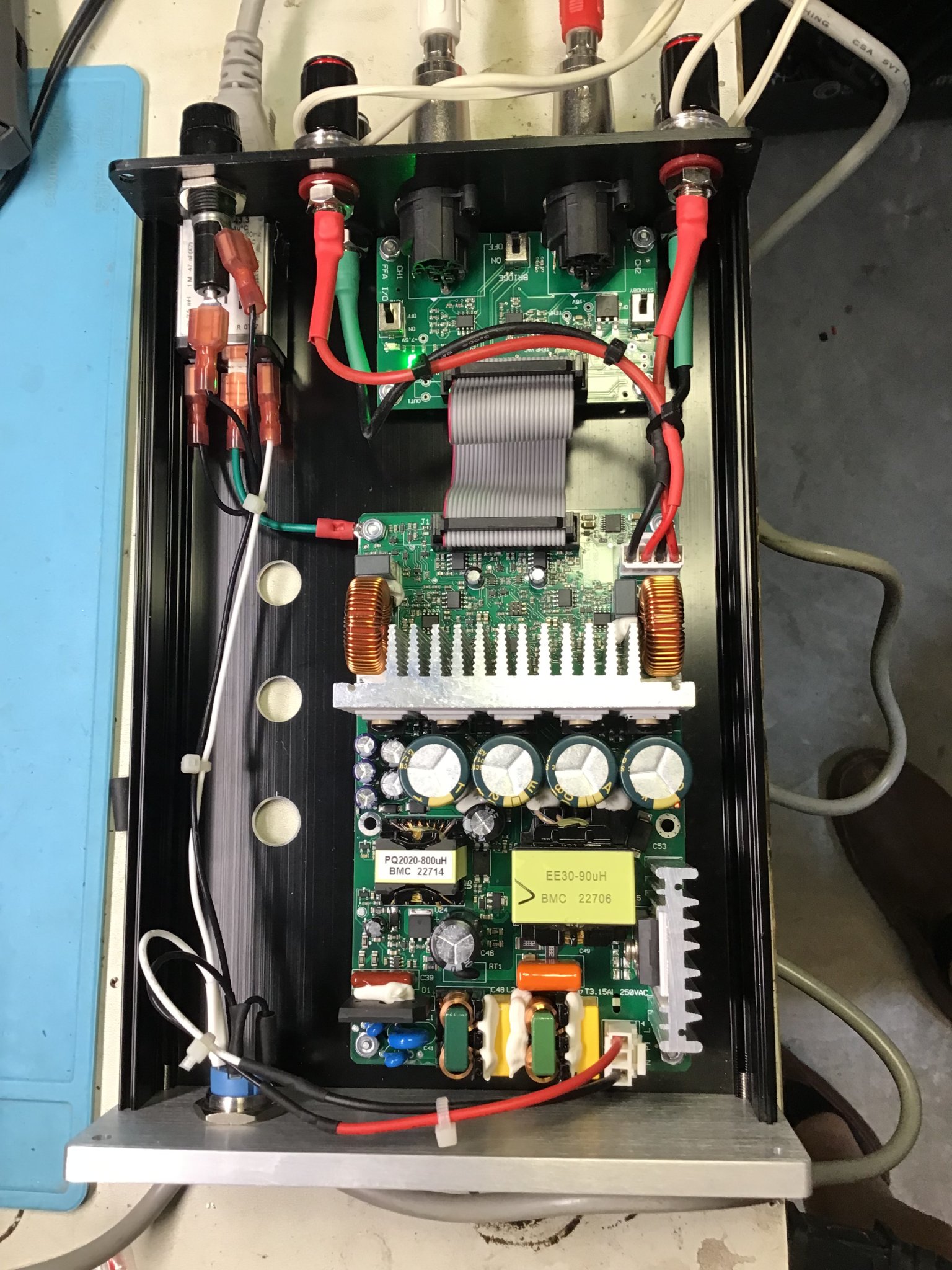

What about thermal management? If I put some FFA001 (i'm still waiting for the FFA003) in that enclosure those things would melt.Putting these into the chassis was like trying to put 12 tomato’s into a can.
Oddly the FFA003 seems to run cooler than the FFA001, but I did put some holes in the side and the top is vented. This is what I did on my first FFA001 and it seems to run cool enough.
