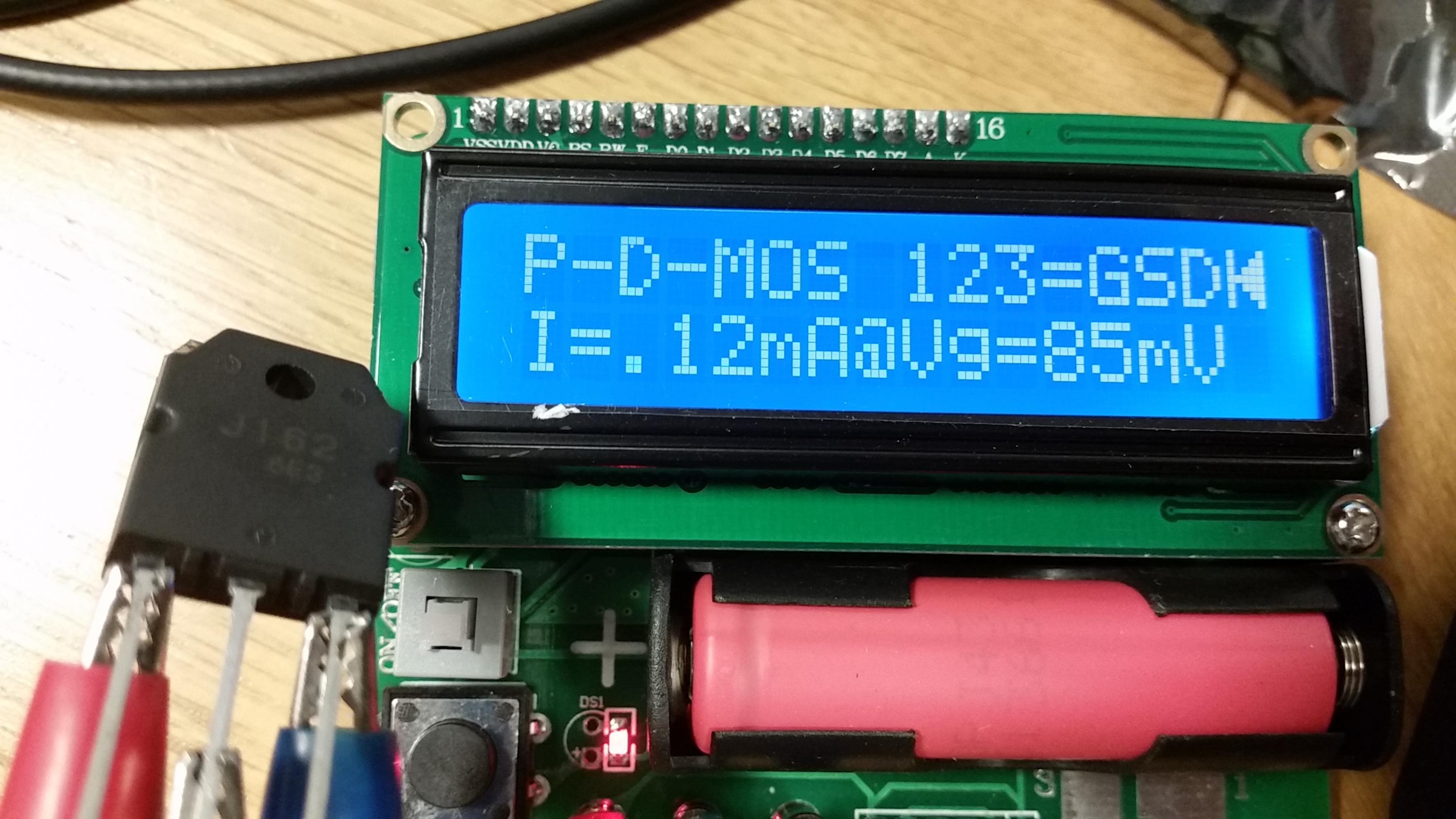

Hi guys,
I bought 20 pairs of J162 and K1058 from Italy.
Markings highly indicate genuine stuff. Three circles, in one it says something with veryvery small text...I think Malaysia.
18 pairs are identical to the batch code and all and measure good. Gate capacitace is hundreds of pf, not thousands. Threshold voltage is around 0.5-0.6V
BUT, the 2 last pairs have different batch codes. K1058 measure ok and J162 not.
I did as you my dear friends advised me not do and bought the 15USD chinese component tester.
It is good for quick tests, not the most versatile instrument but pretty good.
On the ok FETs it says P- or N-E-MOS I guess E means enhancement mode.
On the bad J162 it says P-D-MOS, depletion?
Then it does not give threshold voltage and capacitance, but I0.12mA@Vg=84mV
When hooked up to a 30VDC PSU they conduct 7mA, "good ones" conduct 0mA

Jilthen,
I live in Malaysia and I know Renases does have a semiconductor plant here. However fake parts are abound everywhere, especially in ebay where parts are mostly fakes especially those from China and Hongkong sellers. If you want genuine parts buy from reputable distributors like Farnell, RS , Digikey etc. There is one guy operating under Ampslab catering for the diy community and his parts are genuine Renasus. Price is very decent too!! my 2 cts..
I mean gate connected to source. I think it does not work if you leave it hanging loose!
At least I have tried it with some power fet and audio fet and both were in a semi conductive state then...
I did not use any resistor at first...but now I added a 1k gate resistor.
VGS=-150mV (datasheet minimum threshold voltage) I get IDS = 28mA at VDS=30V.
So...possibly ok bias at VGS=-150mV...but not within datasheet specs.
Seller says he bought the FETs from a trustworthy electronics shop.
I believe him.

That kind of variation is abnormal. Even across six batches of IRFP9240 made by IR - sold by unscrupulous eBay vendor as match pairs, the max variation I observed is 25% or so - though I normally tend to match drain current at a given Vgs rather than Vgs(on).
The best way to test a lateral MOSFET is to observe drain current as the device warms up. Renesas app note has some information.
The eBay testers are good for to/no-go checks, but for anything more complex a proper test setupis probably needed.
Sometimes with gate open device may conduct quite a bit actually, I'm not sure of the mechanism behind it but I've seen drain current of up to 100mA that needs the G-S junction to be connected once and then 's fine. Only happens with devices that have been lying around for a bit or out of the box. A batch of 16 IRFP9140 from Digikey behaved like this, every single one of them.

hi jlithen,
i have the same tester as you used on the 2Sj162, and i have the same result for 8 of 14 P-E-Mosfet, all 8 did show P-D-Mos instead of P-E-Mos and current Id of about 5 to 12 mA and the threshold voltages show from 50 mV to 120 mV. As i read in the firmware of this tester, a threshold voltage of <150mV is one indicator for a depletion Mosfet. All 9 pairs are original Hitachi 2SK1058/2SJ162 transistors with the same date code and about 20 years old, stored under dry and dark conditions.
The interesting thing is, that only the p-channel Fets show this misbehaviour.
For testing purposes, i equipped my evalution board, in working conditions with Renesas types of this Fets, and had the result that the P-Channel Mosfet was fully conduktive and i measured the negative rail voltage at the output of the board. So it is now a depletion MOSFET, but why???? Interseting also, that i measured a Rgs of about 18 Ohms
So i am a little confused, since these Transistors are genuine and only the P-channel Mosfet should be defective. Maybe a handling problem, or very high sensitive transistor for ESD.
Best regards
