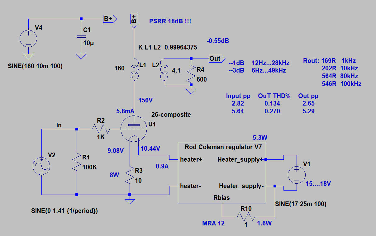

... but usually PSRR is very limited ...
The #26 is very sensitive to power supply,

The stepdown OPT is good for output impedance and decrease gain, but this schematic also sensitive to power supply hum, the PSRR very low even if primary inductance is high.
This sample is quick modification of my older design of 10Y/801 preamp.
The preamp (I designed it a long time ago to my friend) was OPT loaded.
The line output transformer was a good (and horribly priced) Noguchi FM-24k-600 (24k:600, 160H primary inductance).
160H at 20Hz about 20kOhm. It was just enough (a little in the lower side) for 5k plate impedance tube.
#26 at about 150V has approximately 7k5 plate impedance, so even 160H inductance not optimal.
See the distortion numbers: with active load the THD is 0.00x% even at higher output.
The PSRR is unmanageably low, without regulated power supply this schematic is almost useless.

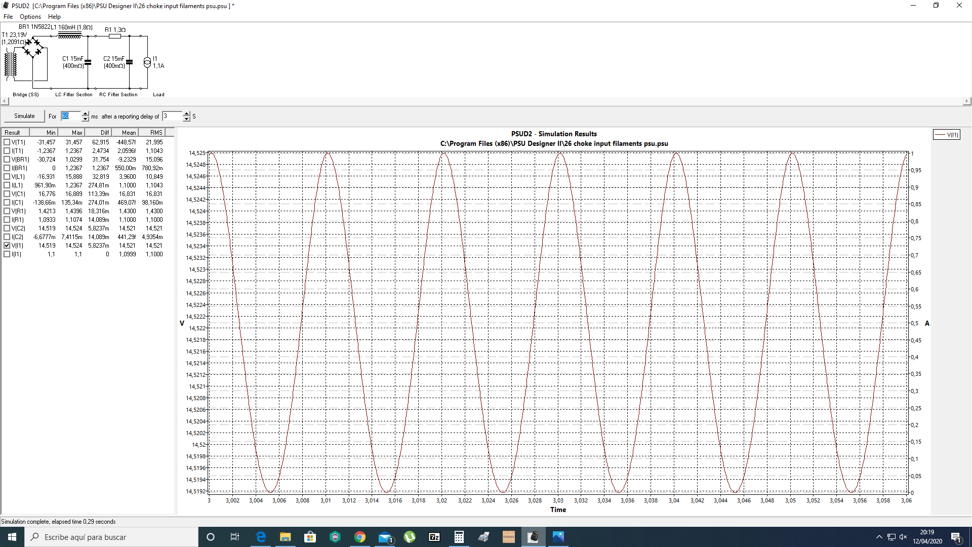

Mine attempt to implement choke input PSU for Rod Coleman heater regulators V6 following the kind advice of Ale Moglia (thanks friend).
Power transformer used Hammond 229D40 split bobbin transformers configured for 20V 2.4A because I have on hand and are cheap also Triad make similars (thanks Eduard).
About choke I choose Lundhal (for quality) Filament Current Choke LL1694 configured in series for 160mH resistance each winding 0.9Ω so total 1.8Ω
Mine Rod Coleman regulators V6 PSU needs 14.5Vout for 1.1A
Attached PSUDII simulation.
All suggestions to improve will be welcome.
TIA
Felipe

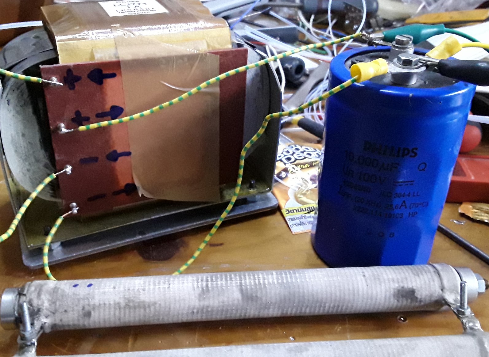

Hello Felipe,
Some ideas, advice lol
You can use the SBYV28-100 diodes ( very good test in Lineair audio magazine) AND mount them directly onto the pins of the transformer.
Use the LL1694 with one coil in the plus and one in the min like you can see in the LL1694 pdf.
Ask Lundahl to make the LL1694 not with 1,5 A cuurent rating but with a smaller airgap to make it 1,2A THEN you will get more mH ( around 190) . They can do at no extra cost.
The LL2733 will be better , if you ask it to make it for 1,2 A you will get more than 500 mH. BUT is higher dcr and you will not be able to use the 20 volt transformers. And it is a little bigger.
Use a bleeder resistor that will take care there is always some current running. With no current at all you will get 20*1,4 across the first cap. Just as extra safety you can add a 20 volt zener across the first cap so voltage will never go above 20 voits.
You must put the choke close to the rectifier/transformer combo and twist the wires..
You can also simulate the other things with psud.
You can also connect the choke in one correct way if you are using the connection i am using. There are two wires coming from the rectifier going in. The Lundahl has two '' coils ' Each one has a dot. One wire from the rectifier goes to the end of a coil with a dot. The other wire goes to the end of the other coil with no dot.
In my picture you can two arrows going inside the choke coming from the rectifier the two arrows going outside to the first capacitor.
Greetings, eduard

I can purchase standard LL1694 160mH 1.5A for 76€ each + 8€50 shipping expenses + 4% if I use Paypal, link: Lundahl LL1694, it's a good price?
Eduard if you use common mode connection, I guess you will get half inductance because you are using only one winding?
20 volt zener across 1st cap what power needed: 500mW or 1,3W?
Bleeder resistor value & power?

Hello Felipe,
That is like a standard price i think prices in Europe will be the same.
I just checked my Lundahl LL2733 ( standard 400 mH 1,7A ) with smaller airgap is 544 mH 1,25A
There is a company in Estonia that also sells Lundahl so you can ask them to ask Lundahl to make your Lundahl with 1,25A current rating. Same price but better for you.
Lundahl Filament current choke, LL2733 - Fidelity Components Shop
You can pay with paypal but at no charge!
3 kilo with UPS is 28 euro think. But you can ask them.
If you connect them in common mode mH will be the same as like they are in series ( because they are in series!)
I would use 5 watt zener because if something is wrong like filament broken the voltage on the first cap will be around 28 volts.
If you have 16 volt dc on the first cap and use a 160 mH choke you will need minimum current of 100 mA (16/,160) If you have 544 mH you need just 30 mA
Power of the resistor 16 volt* 100 mA =1,6 watt so use 10 watt because it will get really hot. A professional 5 watt will be ok but better use 10 watt it will not be expensive.
Greetings, Eduard

Hello,
16 volt divided by 160 ohm will give you 100 mA bleeder current.
With the 544 mH choke you can use 470 ohm that will give 34 mA and you will need a minimum of 29 mA so more than enough!
There will be people here that will tell you the circuit will give enough load. YES, but only if the tube is working.
Better be safe than sorry.
It is also better for the capacitors because the voltage will never rise to the maximum like it will do with no load at all.
Greetings, eduard

Hello Felipe,
I just wanted to share this information because using a choke input gives a lot of improvement for not to much money! Most of the Lundahl chokes ( they are my favorite ones) cost around 100 euro.
If you already have the transformer you will need another one because the choke will give a big voltage drop when used for choke input.
You need to take care about the critical inductance and you need to take care there is a resistor that '' bleeds '' the minimum current so it will always work as a choke input even if there are no tubes connected.
The best way to connect them i showed in the photos above but you can try the normal serie connection as well.
Take care that the wires between transformer, rectifier, input choke and first cap are SHORT.

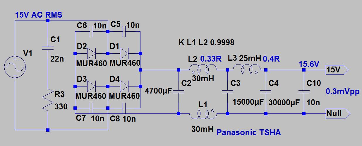

If you use Rod Coleman regulators, IMHO using choke loaded raw supply is unnecessary.
I use in my 26 preamp this supply for years ago and absolute noiseless.
Cheap industrial 5A CMC and DIY choke (hand wounded, 1mm wire, SU 60b core).
