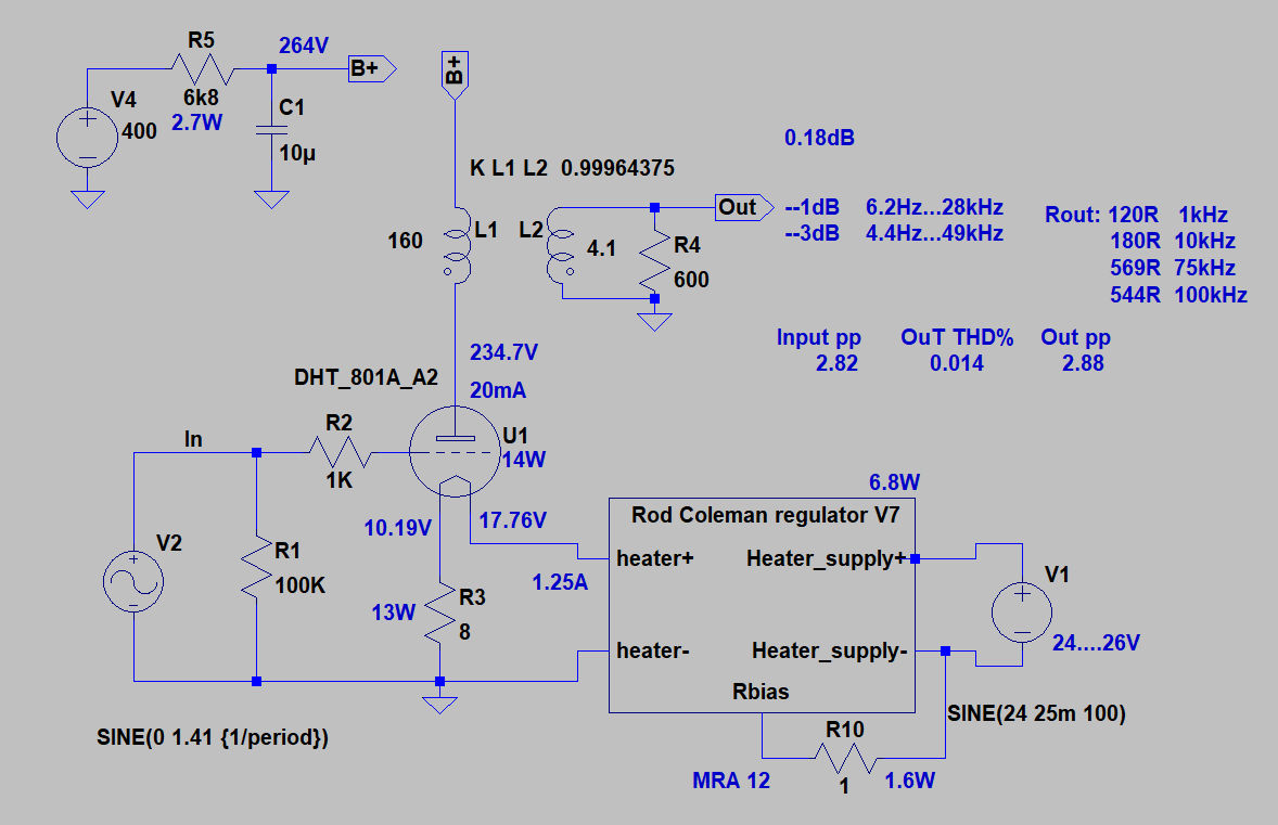

Bela I have it: 5687 triode, opt 15k/600R loaded 15mA each triode sounds wonderful but not DHT.
The fact that you have tube equipment, which contains ..kOhm:600R transformer does not mean that it is suitable to drive headphone.
I attached the 801a, Noguchi 24k:600 (FM-24k-600) preamp schematic, which is DHT, has enough low output impedance, but NOT designed (I was the perpetrator :p) as headphone amp!
High Ri tubes (as 801 and #26 too) very badly tolerate variable (tend to lower than calculated) load impedance.
Instead of its choose lower Ri tubes for driving headphones.
