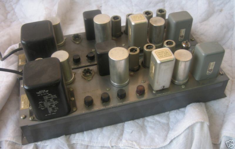

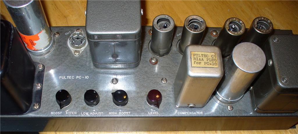

Take a look at the mono famous pc10. They are small.
You can see all the iron:
A power transformer.
an input transformer for cartridge
an output transformer
a LCR Riaa correction unit containing two coils.

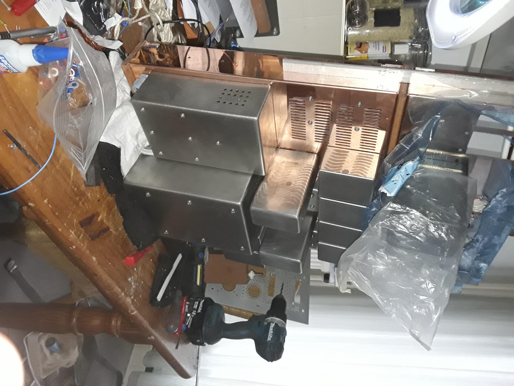

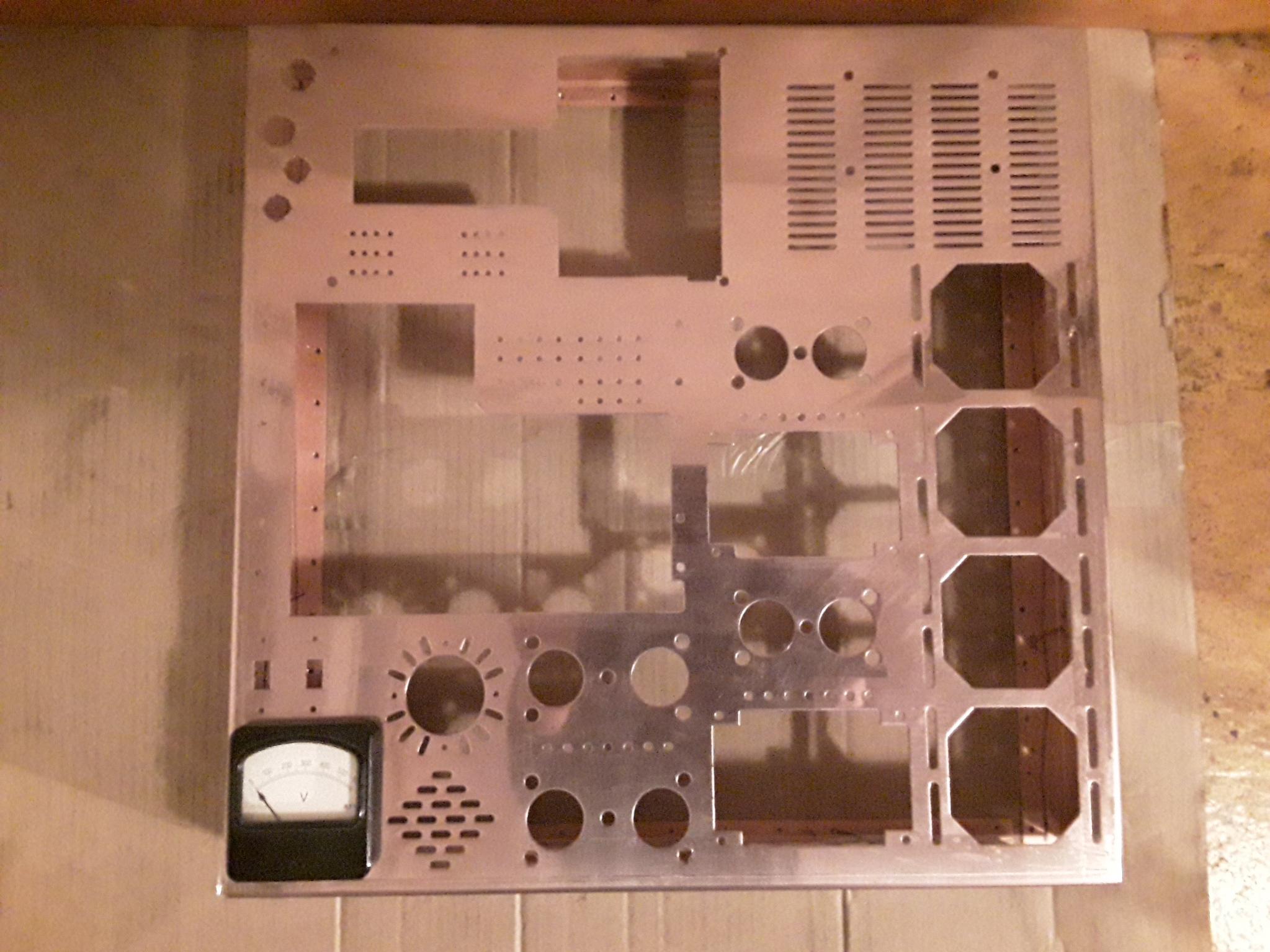

The original ones no hum! I made the chassis for a group of people in France. They used a local supplier to make an EI transformer with static shield. Never heard it but the owners said only quiet if the power transformer is at distance from the chassis.
The input transformer used a special trick that can be seen in the attachment. Nobody could get hold of that one. The way it is constructed the noise will be out of fase and the signal would be in fase and it has a very good screening. So not having the original input transformer in combination with a so so power transformer and you will have some trouble to resolve.
The Pc10 manufacturer states it uses some patents from Western electric company.

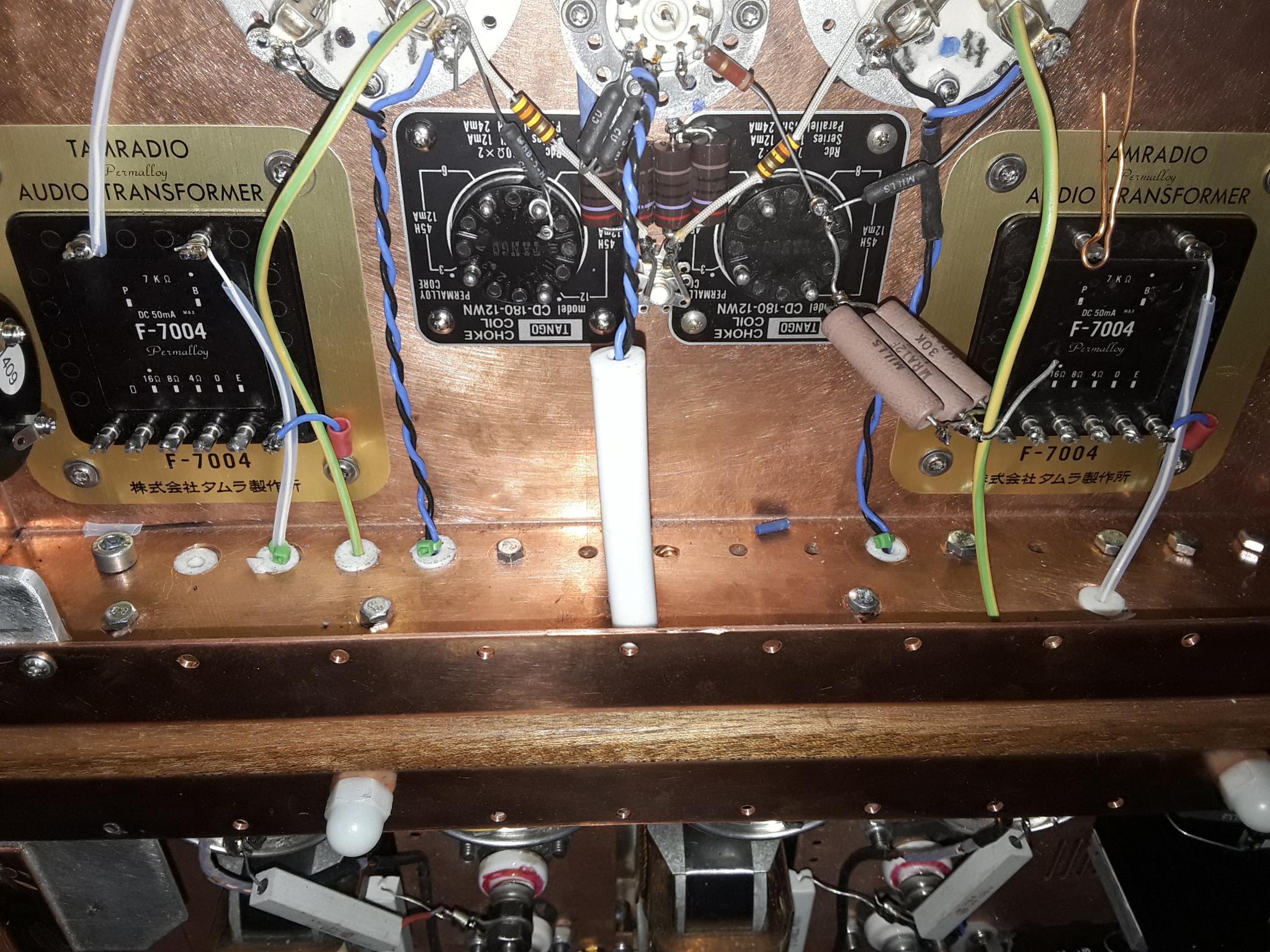

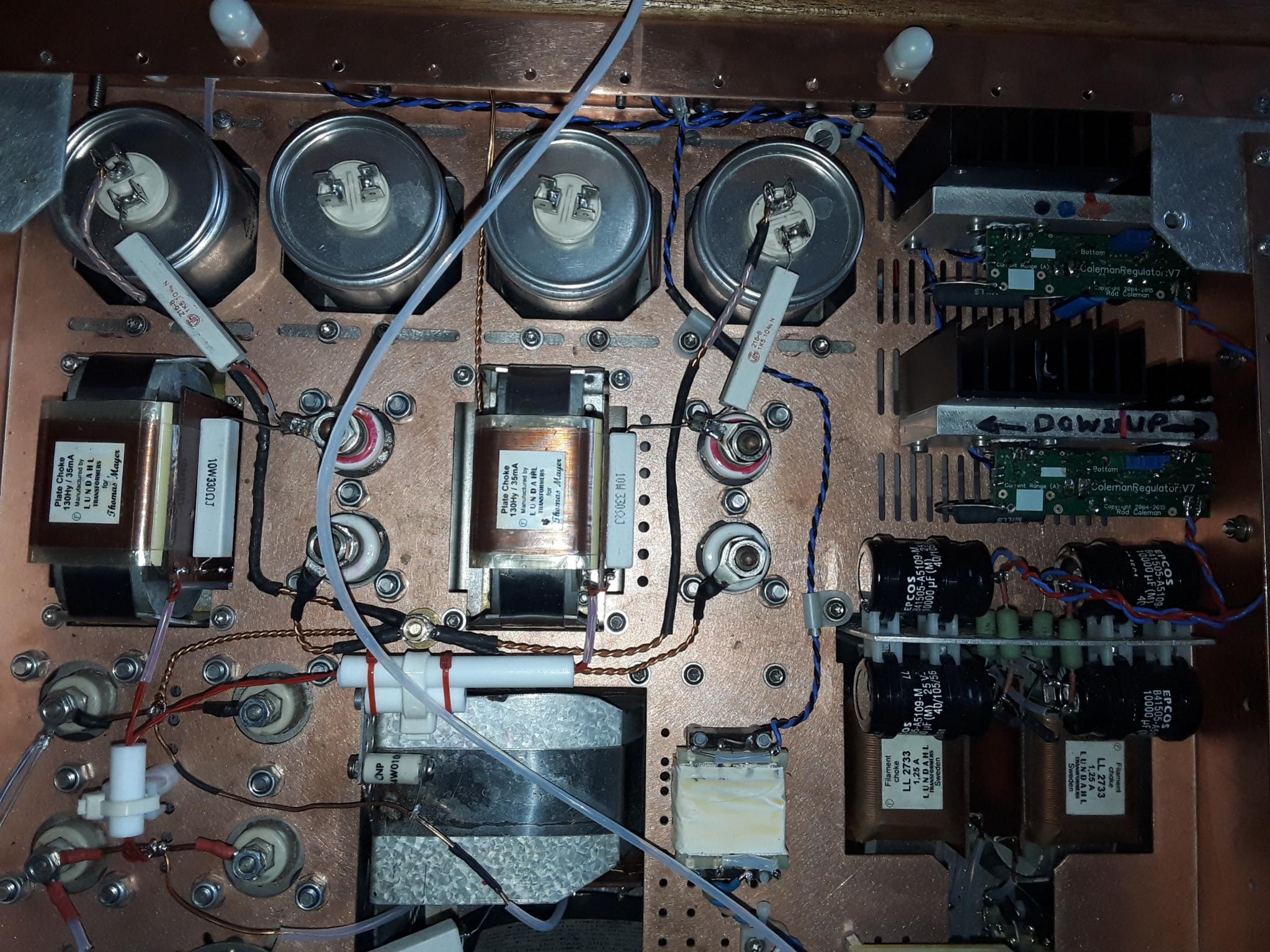

P.s As you can see in the attachment the Lundahl chokes ( 5, 2 for Rod Coleman circuits and 3 for high voltage supply) are in good company of permalloy Tango anode choke and permalloy Tamura output transformer. I have the Tango in stock but i use Lundahl

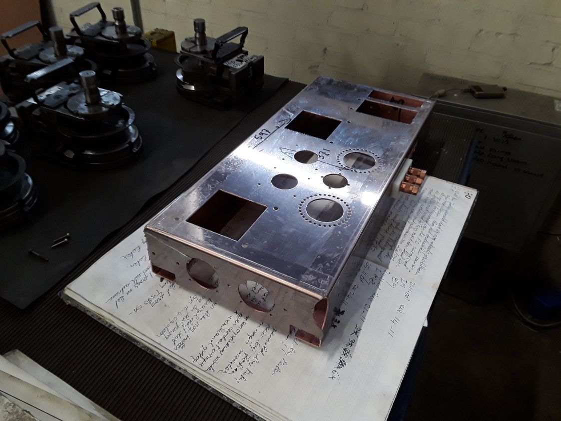

Nice OPT !! I see F7003 on eBay at the moment (not affiliated). Nice chassis too, can we see photograph of the top side?.

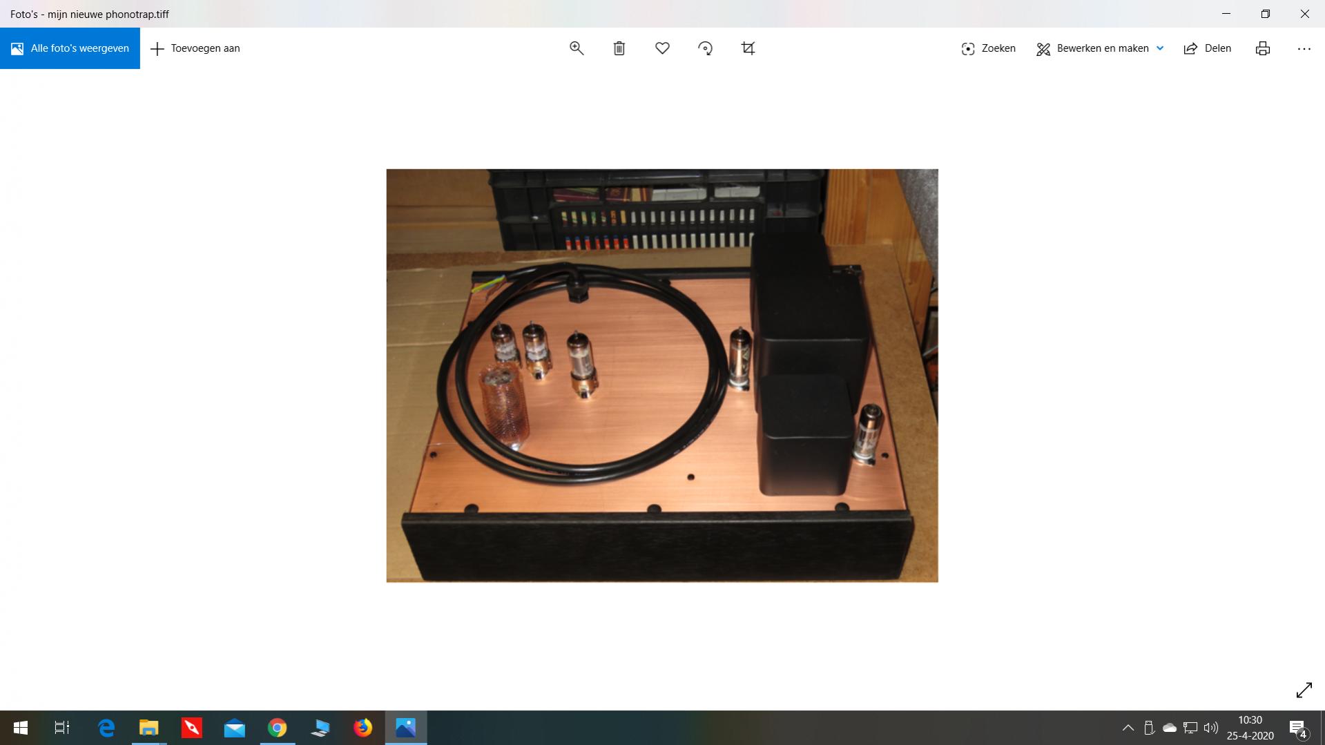

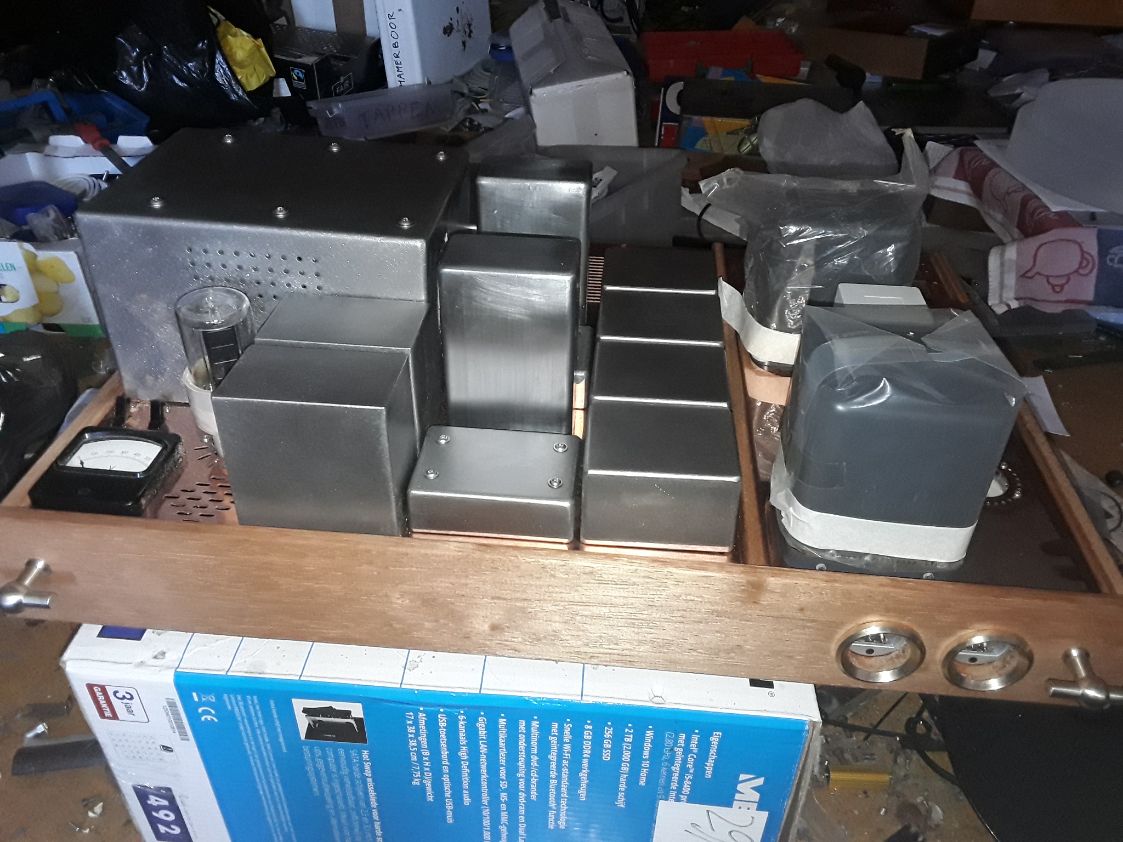

In the attachment you can see my phonostage which has two chokes used as choke input and a double C core power transformer. Of course no direct heated tubes inside. But it has a shunt with tubes and the signal is a lot smaller.
It was built by a professional not me!
If i had to make a separate power supply i would use and LCRC for sure. Then you could split the last cap between the power and the signal part. I think you should see the last cap as a kind of energy reservoir not for diminishing ripple.
