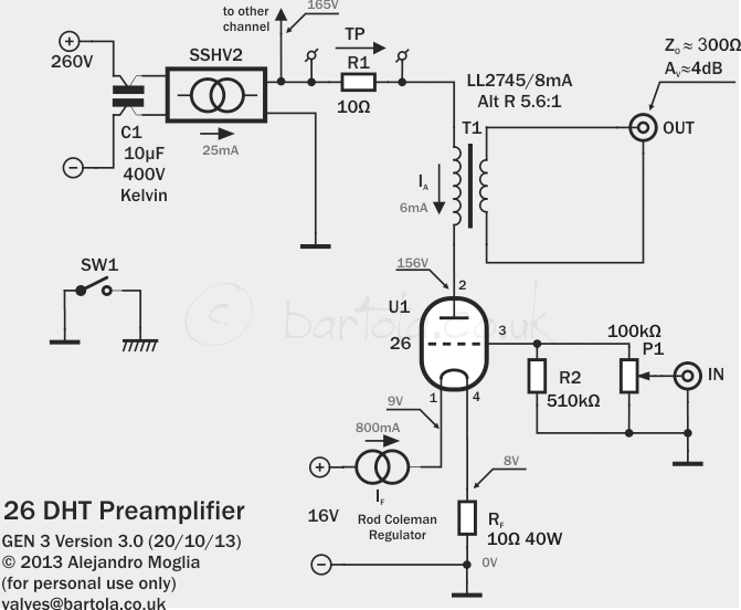

Hi Everyone,
I feel badly posting such a beginner question here.
But here goes:
I'm building a 26 preamp based on Ale Moglia's Gen3 schematic (see below, I hope Ale doesn't mind me posting it here.) I have a bit of a wait on the LL2745 as they are out of stock.
I would like to get the rest up and running, and wondered if I could simply replace the output transformer with an RC network for the time being?
Something like 22k plate load and .22uF to output?
Thanks in advance for your advice!
Best,
John
But here goes:
Best,
John
A resistor as anode-load is difficult with the 26. The Value of the resistor would need to be high, to maintain the performance of the 26 DHT - 22KΩ, say.
This value is too high to drive cables, or external loads.
If the trafo is out-of-stock, you could try the 'gyrator' anode/plate load. There is a very well-implemented version on Ale's (Bartola Valves) site. This presents a high-impedance load to the 26, while offering a low-impedance output drive. This is a much better solution....

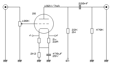

Thanks for your replies!
Doing a Gyrator is a good idea, but would mean another parts order and more waiting time--especially if I use Ale's boards as shipping to the US would likely take a while. (I just put in a request for a pair of Gyrator PCBs. It would be nice to try them at some point.)
I was really thinking of something I could implement today. Just for "shelter-in-place" entertainment. I have 22k 2w resistors and a couple 220nF caps.
It was Jim De Kort's RC coupled 26 preamp that got me wondering (see attached schematic).
He only used this during experimental stages and later went to a choke loaded design. But he did say it worked, and sounded good enough to make him pursue further.
