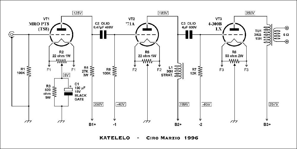

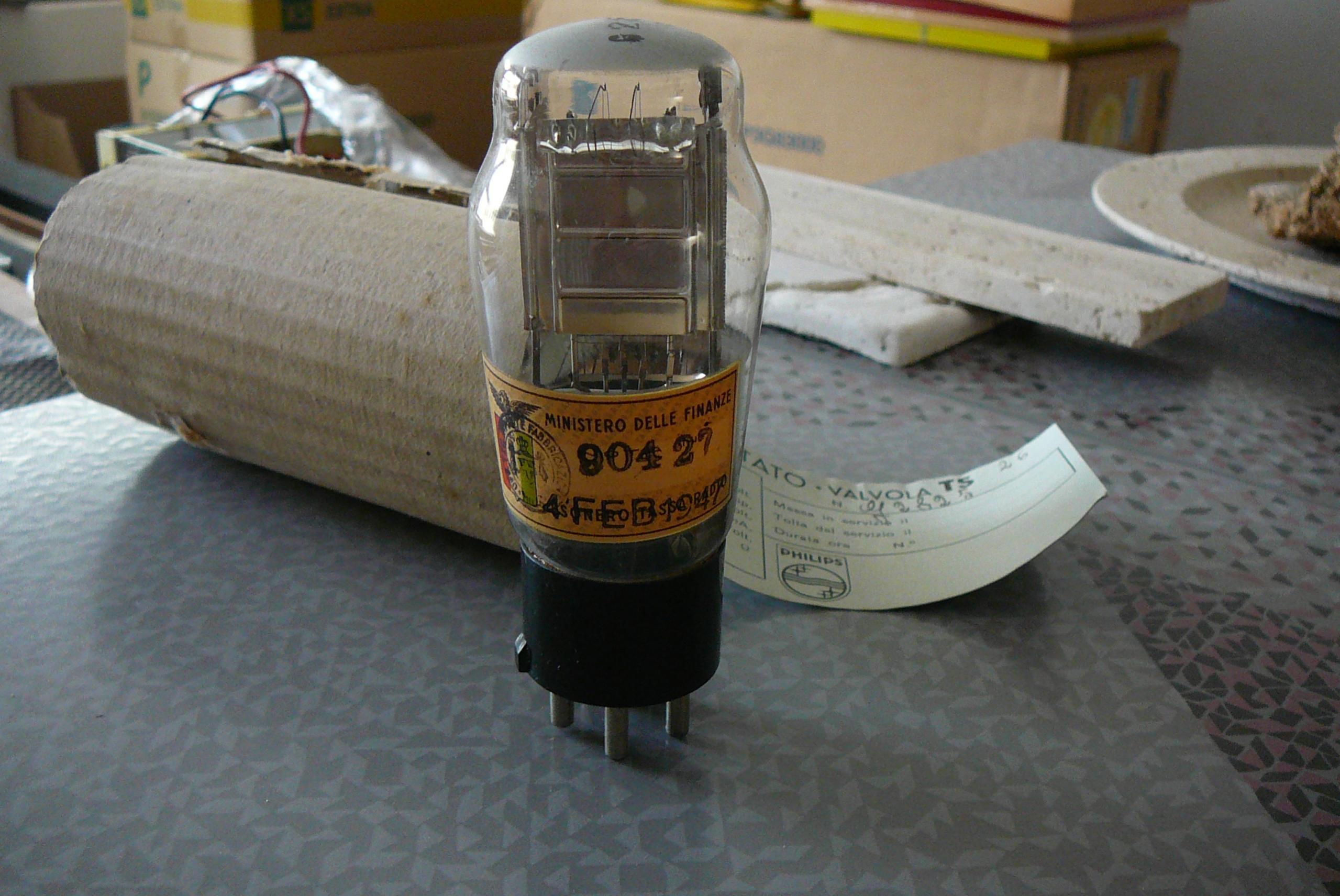

Perhaps there is some other alternative 26 and 10Y tube for such a preamp.
It could be the Philips PT8. DHT very close to WE101F.

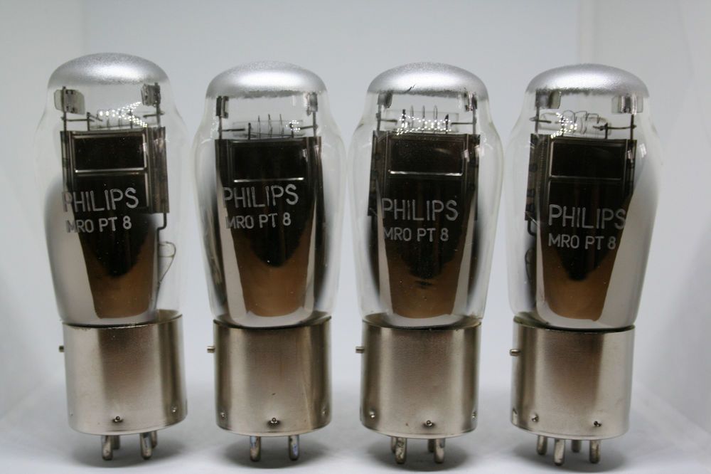

These are the data:
heater V 4
heater I 0.25 A
anode V 130
grid V -8
anode I 8 mA
transconductance 1.3 mA/V
plate R 5.5K
amplification factor 7 V/V
load resistance 6K
It could be fine with LL1660 / 10mA (ALT Q) or LL2745 (ALT R).

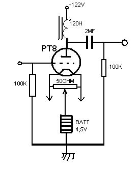

I'd like to know what you think.

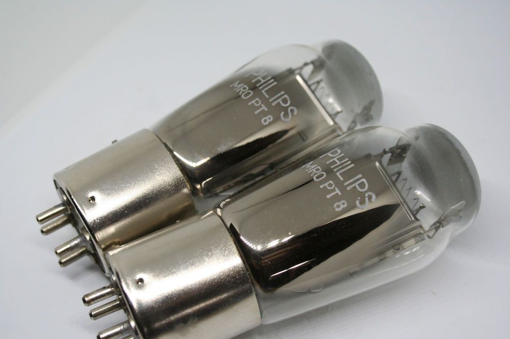

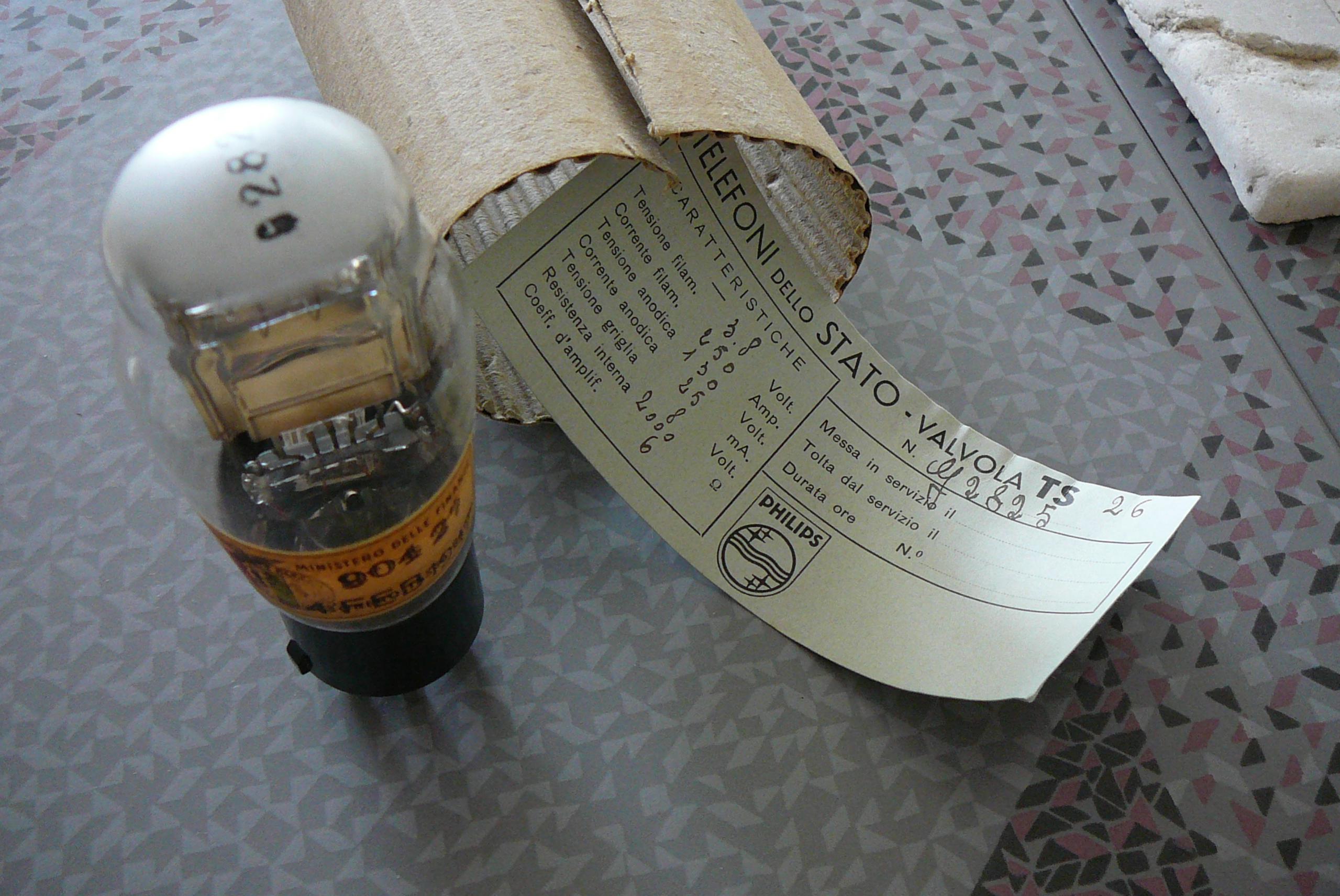

Thanks for posting, hadn't seen these before. Nickel plate?
I'd have a place for them, are they for sale?.
Nice looking tubes, electrically similar to STC 3A/141A
Load impedance closer to 12k at the lowest usable frequency, much better suited for inductive load than 26 or 01A.
HK
Looks like a good input tube.

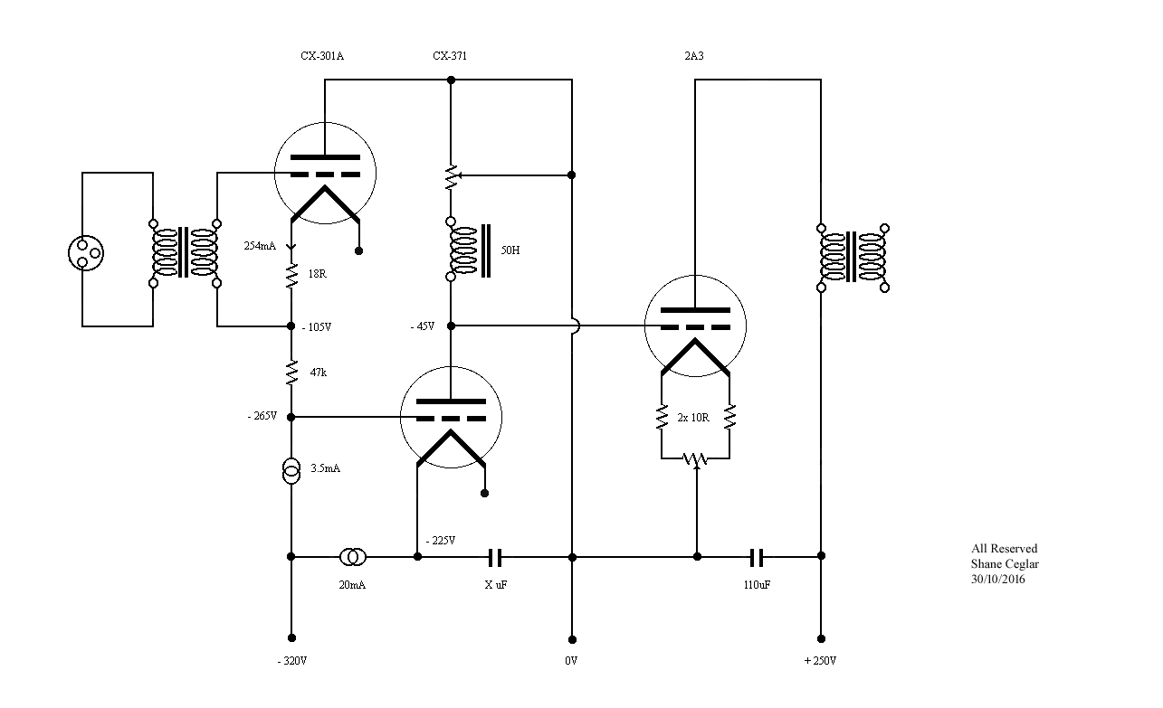

I would use a nice 80% nickel plate loading choke, direct couple to the next stage and use the filament current to bias the tube with an unbypassed cathode resistor.
Stacked supplies with the driver biased by plate current through the combined DCR of the plate load of the input tube and some series resistance plate side which would also serve to decouple the capacities of the winding.
Maybe a CCS fed shunt capacitor, this would move all bias shift to the plate of the driver.
Addition to drive impedance would be Rk x 6 which is negligible, overall half that of 26 or 01A.
Nicest looking tube. Do you have a couple of couples, or just a couple?. :)
These are awesome.
Same voltage gain, same voltage across the tube and filament requirements.
3x the plate current and 1/3 the drive impedance.
Havent seen the transfer curves, but I suspect they're every bit as good.
PT8 input direct coupled to PT26 as a driver to _whatever.
Very similar to 12A and 71A respectively.
