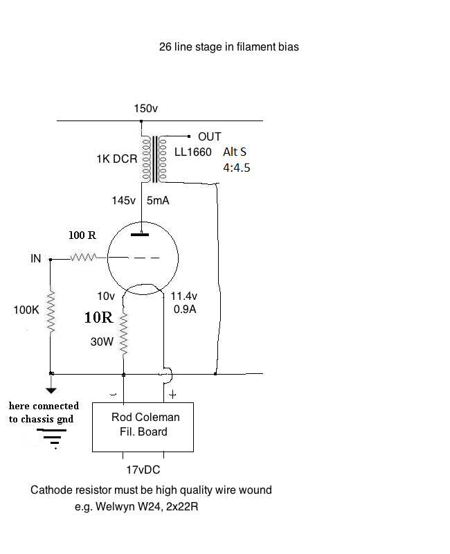

BIAS
Hey guys now I have filament bias resistor but I want to try without filament bias so conventional bias or cathode bias to know how it sounds. Have I to do like attached schematic showed in Vinyl Savor Blog? What's the capacitor value in parallel with de resistor?
TIA
TIA
