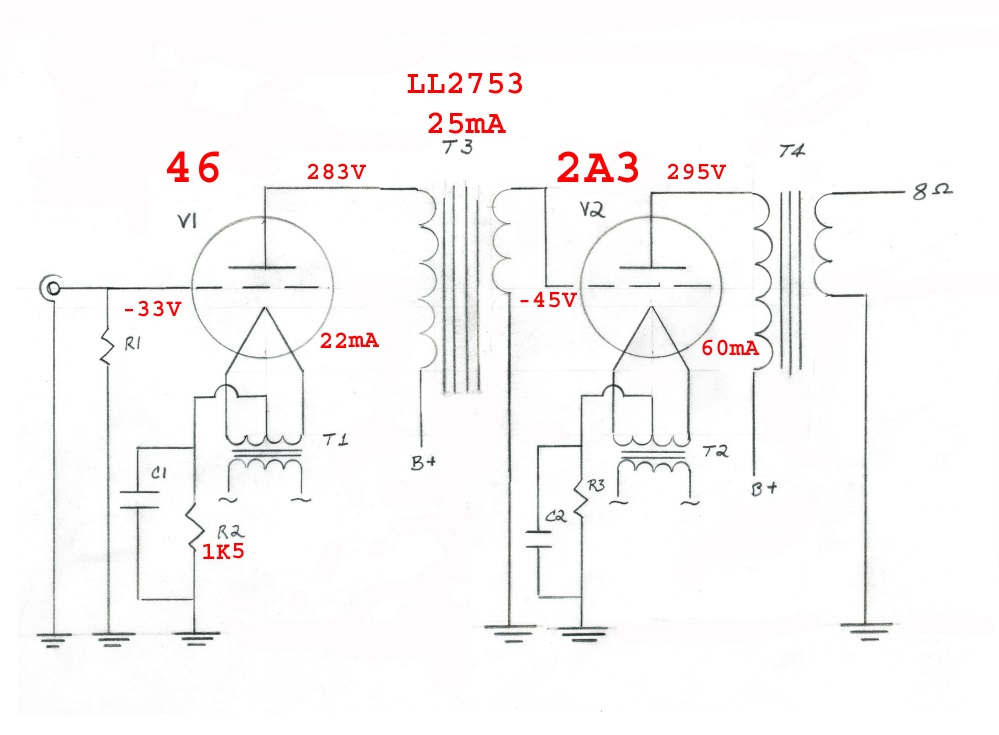

46 drive 2A3 (should drive 2a3 even without input transformer) :
As for the control of 2A3 (voltage oscillation), with a polarization of -45 V, complete control in class A1 (negative voltage on the grid) is required, Vpp = 2x45 V, or 90 Vpp, or 90 x 0, 3535 = 31.8 V RMS. That's all 46 needs to give.
Tube 46 is polarized -33 V on the grid, i.e. maximum voltage swing = 2x33 V = 66 Vpp, or 66 Vpp x 0.3535 = 23.3 V RMS. This must be multiplied by the gain of the tube, i.e. approximately 5.6x, so we have 368 Vpp = 130.4 V RMS. So we have a great offer and tube 46 is suitable for this role. (N.B.: 130.4 V RMS: 0.3535 = 368 Vpp)

RMS is calculated Vx0.707 (approx.) or Vpp / 2sqrt. (divided) this gives you here ~ 69Vrms
Without an input transformer you drive the 46 very hard and you'll get plenty of distortion already in the driver stage. Measure it on the workbench! In my opinion an IDHT driver with more gain - like the ECC99 - and low plate resistance is better suited for this.

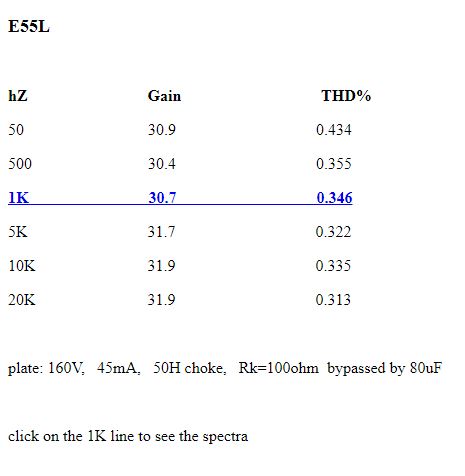

In my data store I found these data for using the E55L as a driver:
no need to run it hard , it 's a very linear tube , running it at 30ma is perfect too ,
80uf for 100R is not enough it must be 800uf to get the full band untouched .
don't forget the 1K grid stopper or it can oscillate..

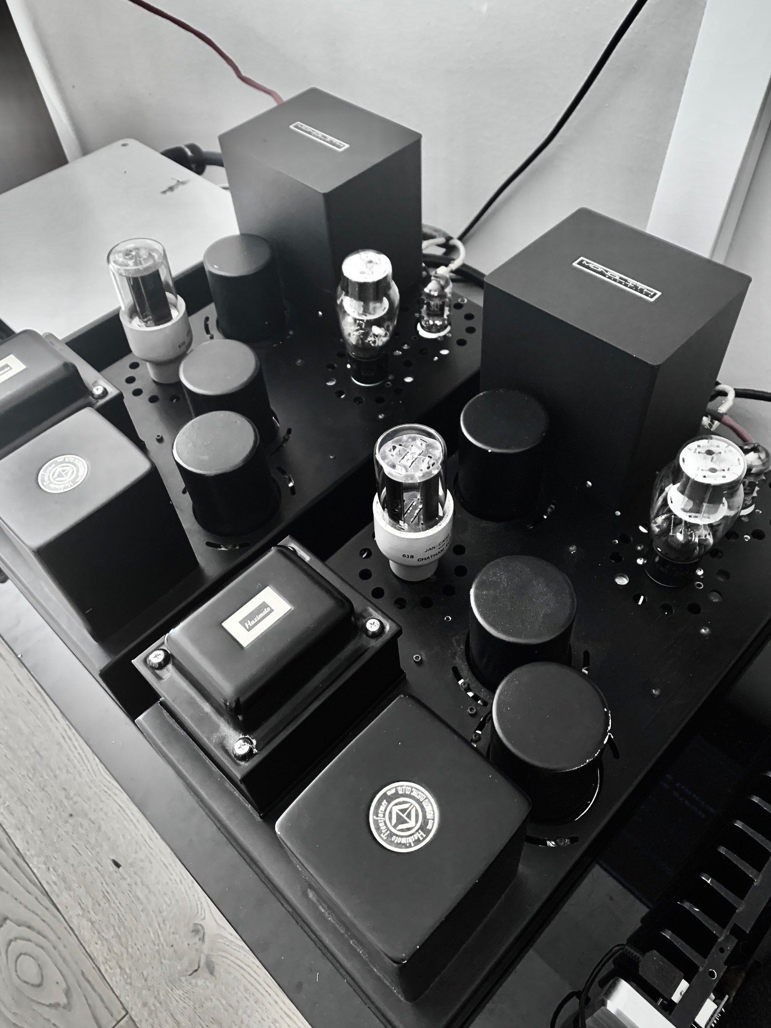

don't ask me to draw something or you will be very disappointed
i try to keep it simple the E55L driver is choke loaded with 40h lundhal choke , 100K on the grid , 100R on the cathode bypassed with 1000uf NPolar cap ( dont like sic diodes on the E55L) capacitor coupled with the 2A3 with grid choke ( old RCA 2A3 have grid current ) , Rod coleman regulator for the filament , 890R on the cathode and 3.3K Monolith magnetics amorphous Ooutput Transformer . the hashimoto is the power supply choke for the CLC .

I can't understand the mathematical formulas well. Can you explain in a simpler way (or step by step) how you calculated ~ 69Vrms.
I'd like to learn this kind of calculations better.
Thanks for the replies
Sorry, typing error it's around 63.63V...
I took his 90Vpp and multiplied it with 0.707
