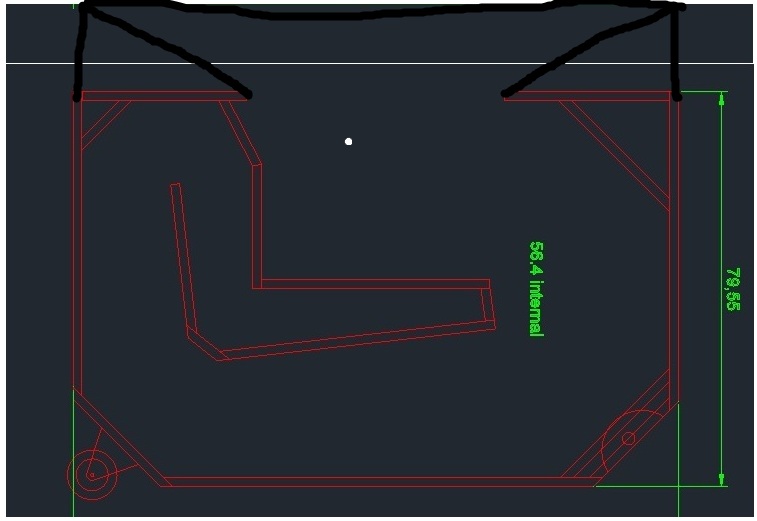

here are the fractional dims.(also availeble in decimal )

oops internal pannels are 22 1/4 internal width
how would this sound
Loud
what is the difference between stacking 2per side and 3 per side
im not good in calculating ,with compression figures ect
but a sine wave @42 hz reach x-var @ 500 watts (no compression calculated.

So 4 cab should hit 140db with no problem with the mouth cut to 2700cm2
epa; btw your amp has to deliver more then 1000 watts clean per box to get there[/QUOTE said:I have two 2000wattt amps at 4 ohm is that enough
I am going over the plan, just to be sure the side measurement for the cab is 48"x31" 5/16
correct

here is the saw plan
measurement wil follow
i made the 2 front pannels taller(mouthe becomes 2200 cm2),so you can cut off afterwards to the shape/area you like.
you can cut that after its bild.
i changed the top corner,its simpler and the handels wil take some volume,so you end up pretty much the same.
i updated the pic post 56 so you can see the bracings 3d
