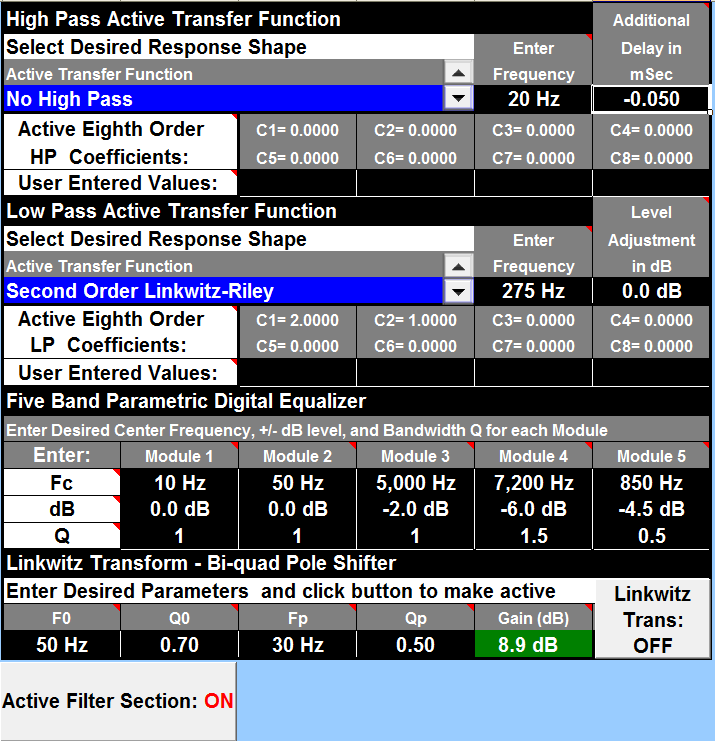

Yes, I was up until 3a last night messing with it. Too tired to take data and post though but will summarize in words...
I set the 3-PEQ's exactly like you said, found I had a typo on one which you picked up on - I think it was the 950Hz, supposed to be Q=0.5 but I had 1.5 - duh... I set the delay on the RS225 at -0.16ms and zero on the 10F. I did it with the 2 small PEQ's on the 10F and without, and ran the 10F full range flapping in the wind whenever a kick drum hits. I tried -4dB cut on level of 10F but found that was not enough to balance.
It sounded pretty good but there was a wide and shallow (-5 to -6dB) cancellation trough at the XO region. Looking at the SR though, it was the widest right triangle ever that crossed zero at 4ms. However, the triangle had a few notches missing on the slope corresponding to the cancellation trough at the XO.
So I then tried putting the delay on the 10F at -0.16ms and got the cancellation trough to go away, but the step response triangle was not as wide anymore. So there is something going on at the XO region that is not matching our expectations or models. I need to make sure the voice coil polarity is not flipped somehow (either in the driver or my internal cabinet wiring). But if that was bad, all my other stuff would have been bad too.

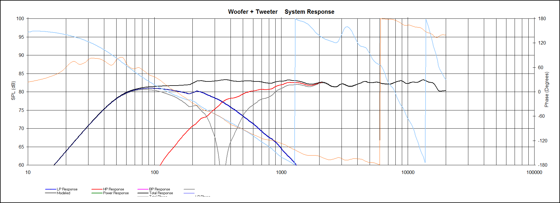

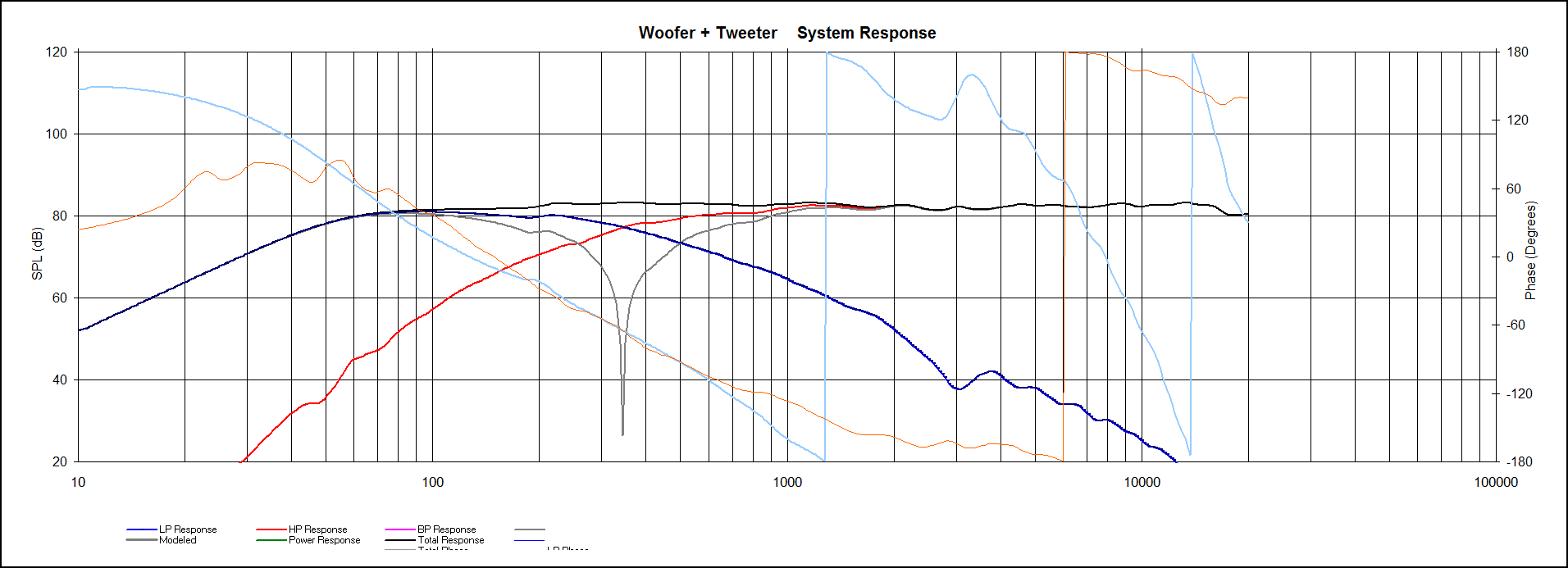

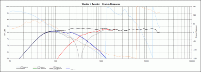

Sounds like you had polarity reversed. This will cause your dip and because of the BW1 xo the dip is only 5-10db.
The lack of mid bass is most likely due to the level being to high around the xo, ie. not enough baffle step. Try bringing the RS225 xo down to around 150-175Hz
This is with the RS225 xo set at 150Hz (ignore the response below 200 as this is an aproximation of your enclosure with no LT). Positive polarity on both drivers. Gray line is with the drivers flipped. The phase looks like sh!t to me, but I don't know much about BW1 crossovers.
As far as I can see there's no way around the lack of a xo on the 10f except for higher xo points, higher slopes or ported/apeirodic enclosure. And I don't doubt that it needs a crossover

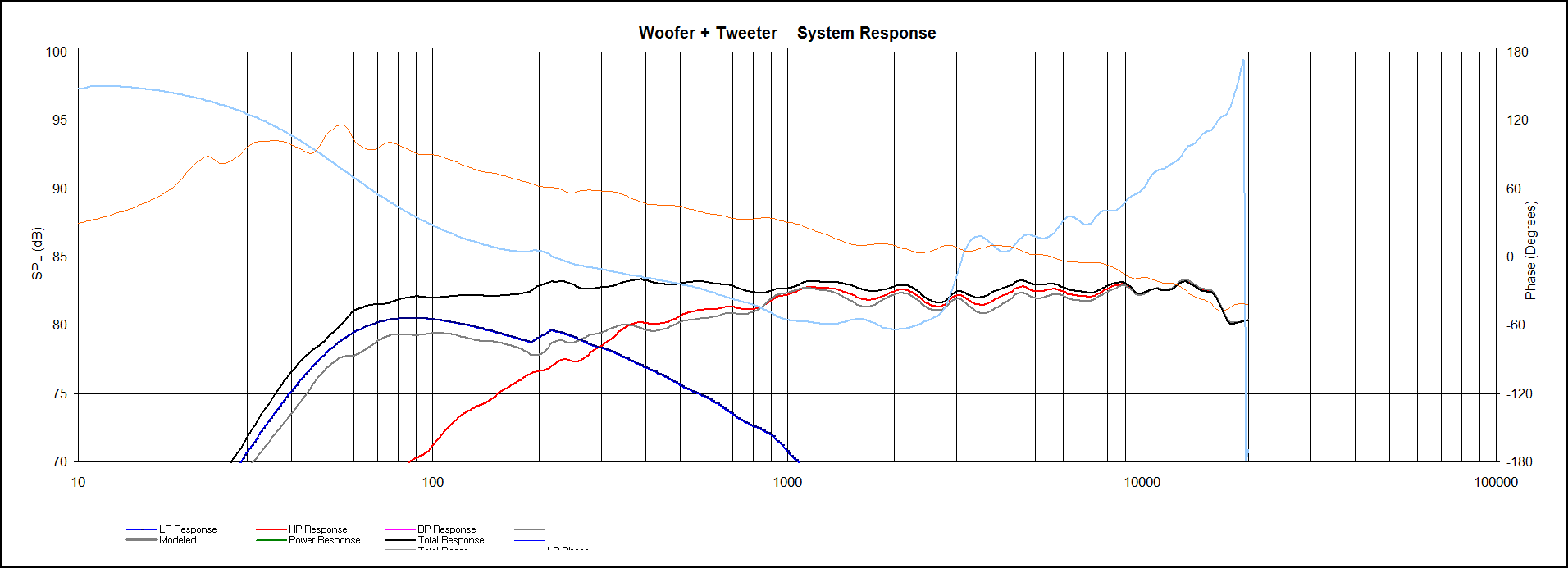

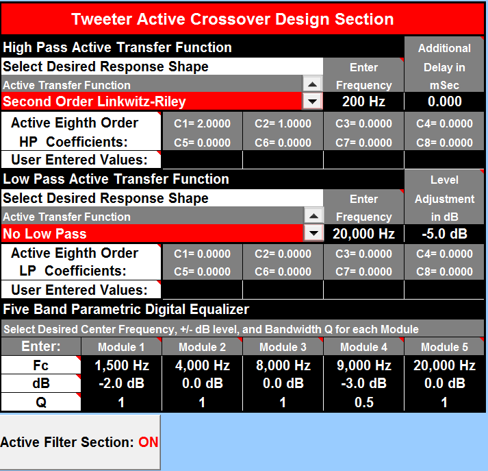

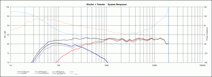

Here's what you can start with instead of guessing and measuring; should leave more time to listen before you fall asleep
Mid is wired with reversed polarity
This is what it looks like-
And zoomed out so you can see the notch-
If it doesn't have enough bass then lower the woofer xo and reduce the mid's level. this is the equivilant of increasing the coil and adjusting the lpad on a passive xo to deal with baffle step. If you want to try this and you want it to look like this, you have to observe all stettings, xo points, peq q and level, delay the correct driver the correct amount and set polarity right. Or not....
If you download Jeff Bagby's PCD then I'll just give you this file and you can play on your own. you really need to be able to sim active xo's anyways if you're going to keep doing this
